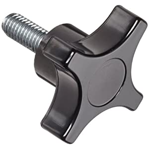

3) More detailed pics on the "keeper" knobs that lock it to the rack

MacMasterCarr part numbers : Bushings 8492A224, Threaded knobs 5993K41
Rectangular Tube was ⅛" thick 1"x2"
These are the knobs I used...
McMaster sells this fancyones but I could not make them work for me
Part number: 8478A24
