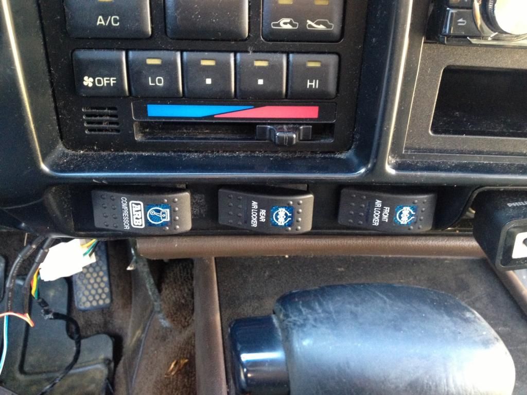

Cleaned her up and got a few things done. Mounted CB antenna and ran coax, mounted reverse light, and wired ARB switches into dash.

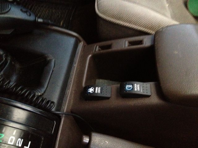

So yesterday was very productive. Below is a list of what was accomplished with a few pics. I didn't get any pics during the work cause I was too busy but there's a few of the finished products.
Winch installed
Front light bar installed
Reverse light wired
Rock lights installed
All switches installed
CB installed
Front diff serviced
Rear diff serviced
T-case serviced
Rear shock resi's relocated
Fuse block installed
