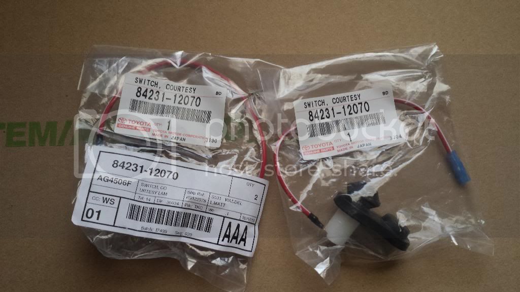

With either rear door open, the dome lights were not working... unbolted the switches and when I touched the wire from the switch to the body the lights would work.
They call these Courtesy Switches part #84231-12070
Ordered up 2 replacements from cruiserdan and installed yesterday.
I thought they unplugged from the actual switch but the new ones had a 6" lead on them but I mutilated one of the old ones anyway to see if I could just unplug it there.
To swap these out you need to remove the rear cargo panels and they plug in right behind the seat belts.
