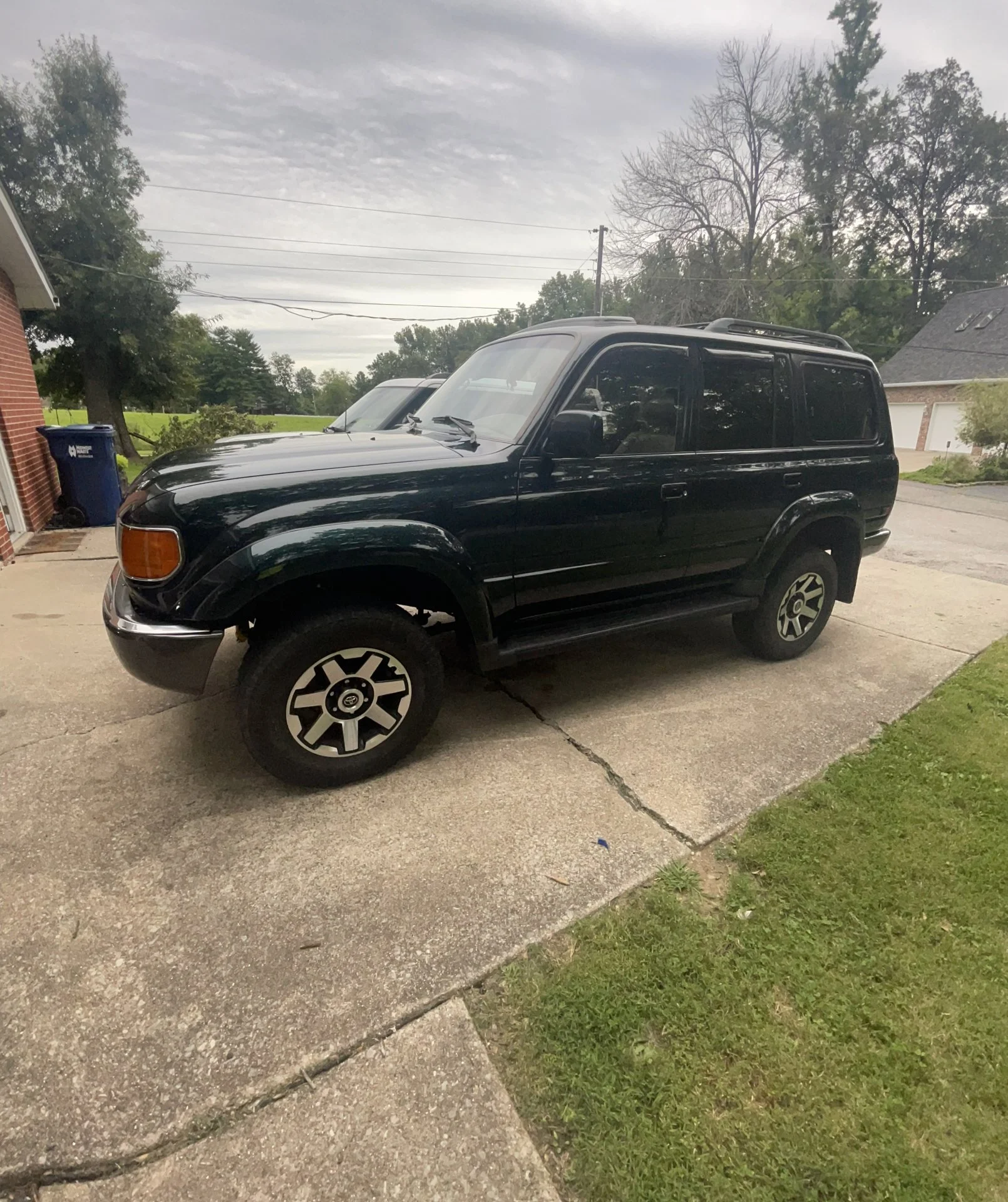

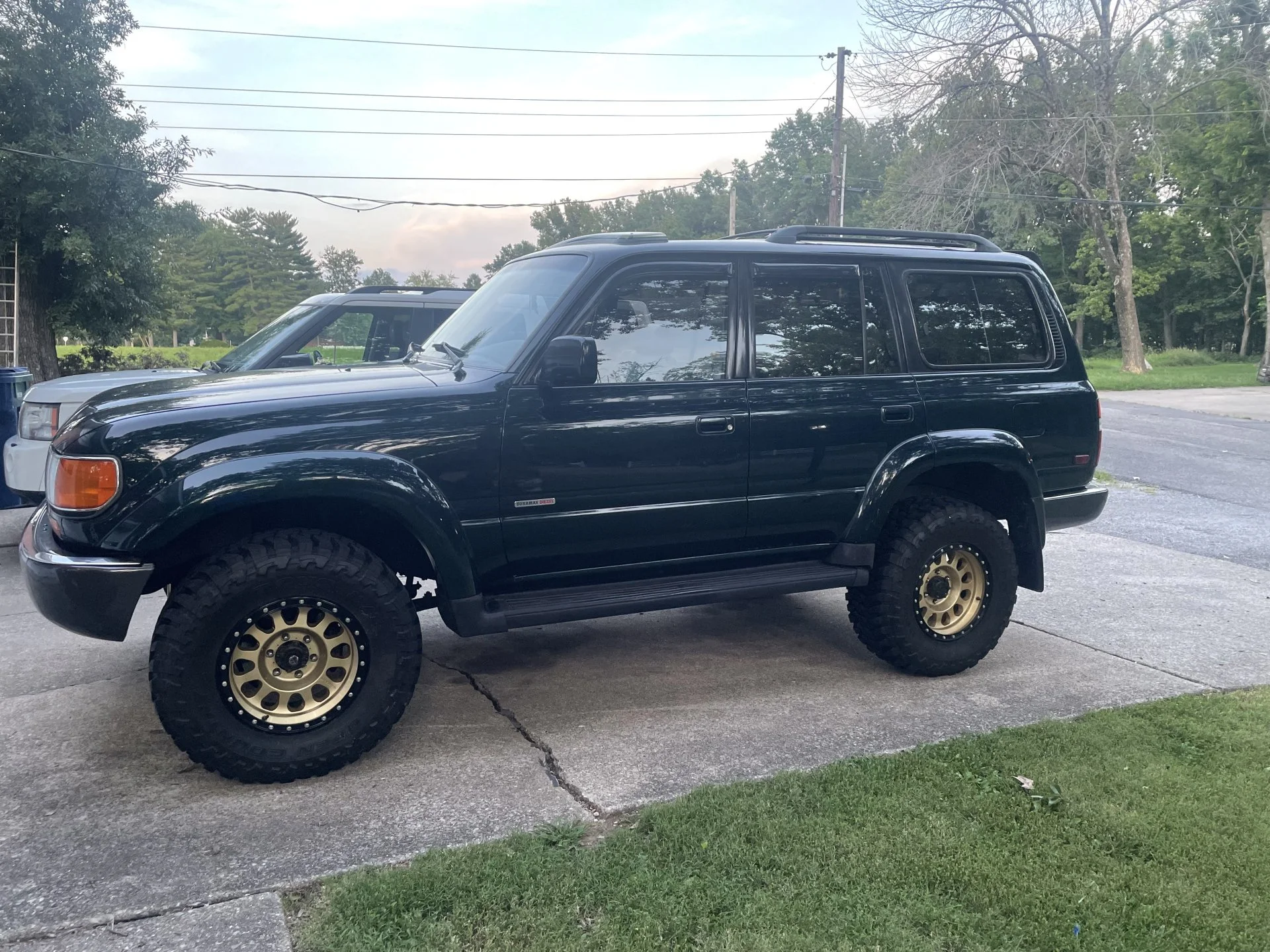

Did you do the full 2.5” lift or just the front? Side profile?
Will do, yes I did the whole 2.5 heavy lift, just finished putting the rear on last night, we should meet up sometime I “should” have this almost completely done by the end of next week, still working out a few bugs,

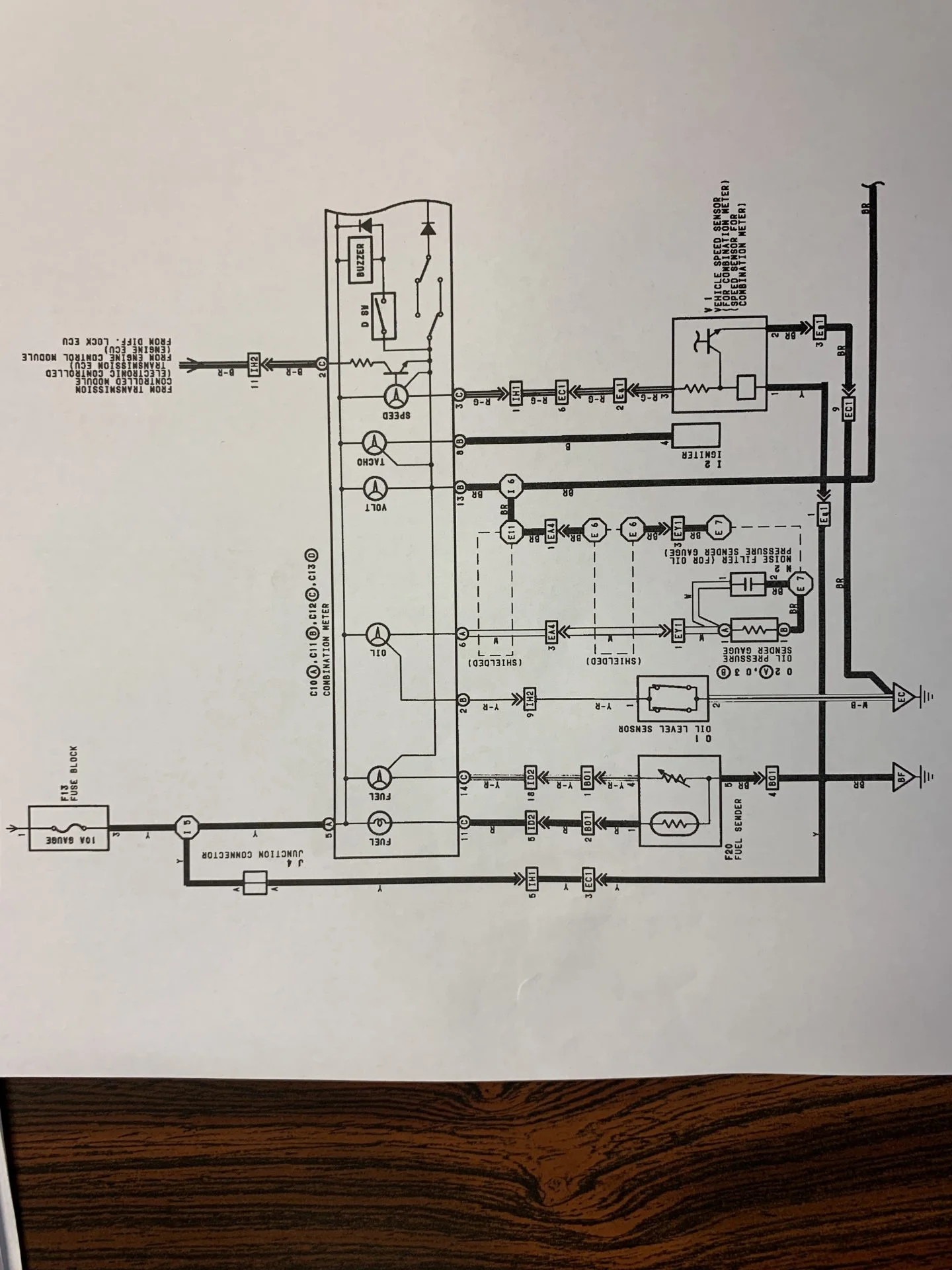

Anyone know how the fuel level sensor works? I brought a ground and sender wire from the sending unit to my cluster but still doesn’t work, the service manual says something about putting a battery to a wire to test resistance so I’m not sure if I need a 3rd wire
On the Landcruiser sender? I can get diagrams.

Not Sure if this helps any. Looks like power to the gauge and ground signal from the sender with another wire for the low fuel light.

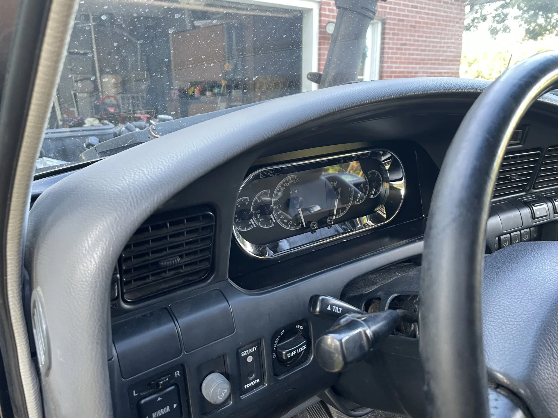

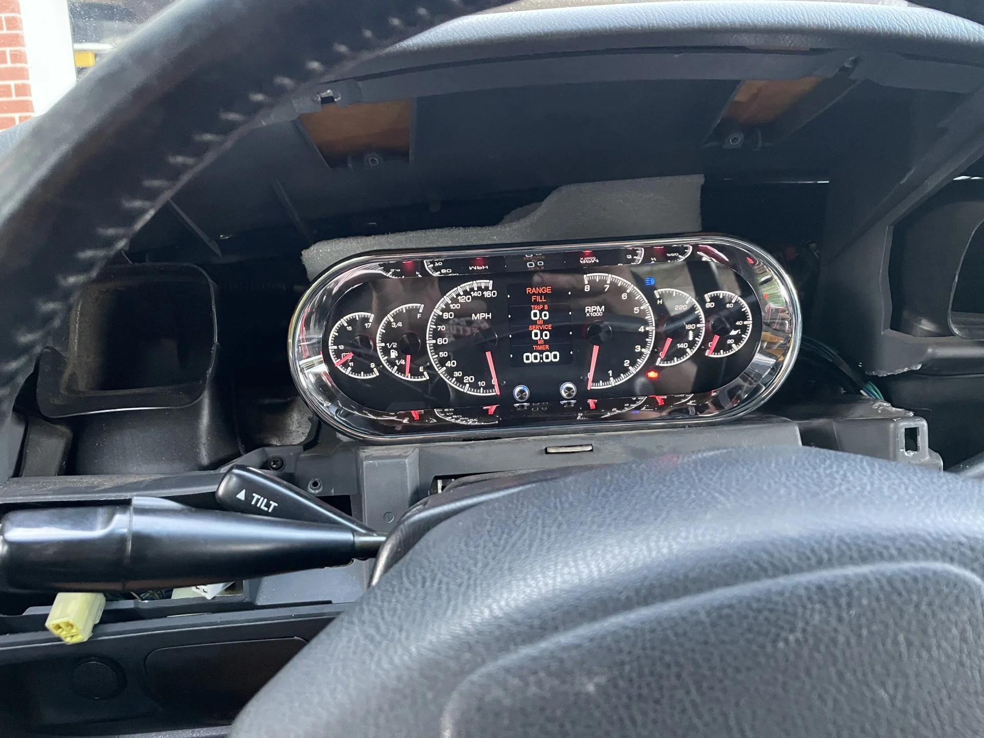

Gauge cluster set up is pretty much wrapped up now. Thanks to Selkirk off-road for helping out with the cluster bezel it turned out great
Just need to add a relay for the bright light indicator since Toyotas are a ground switch

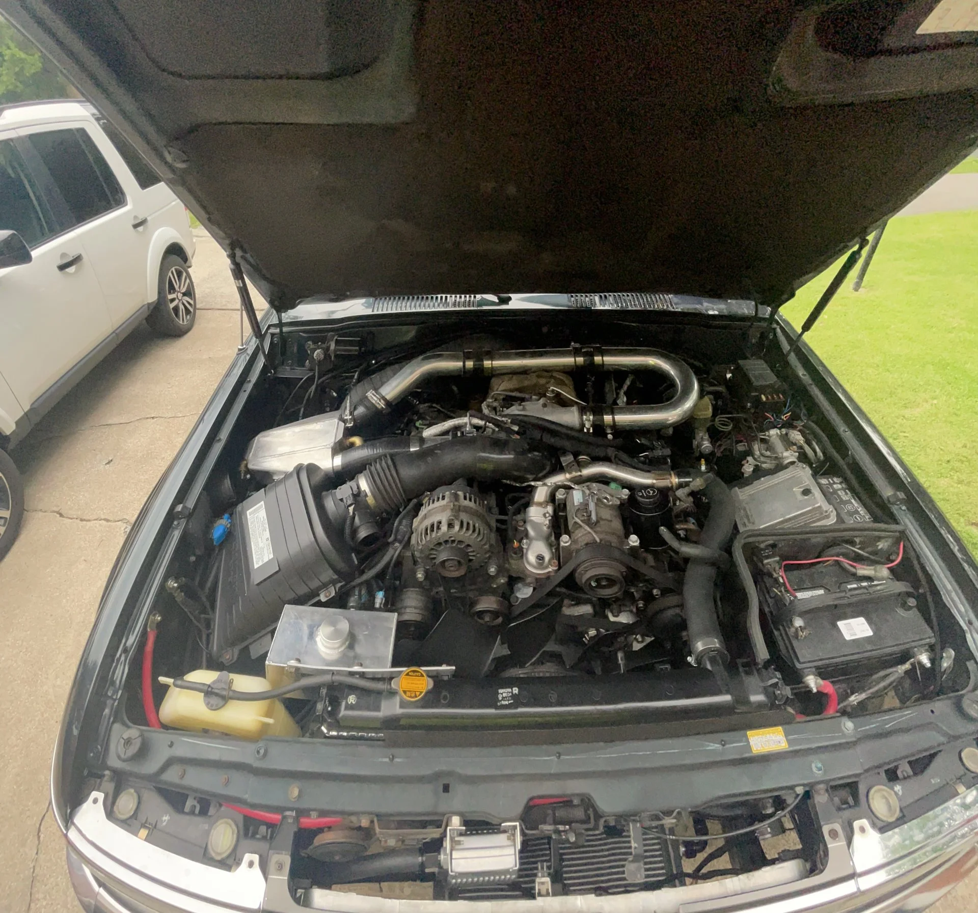

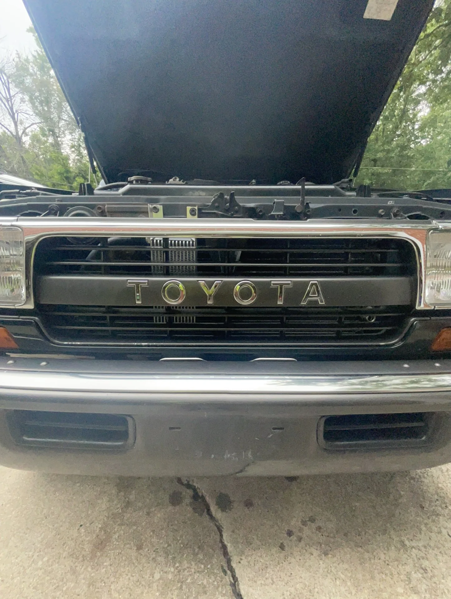

That turned out great. It looks like In the last picture you have the hood on, did you have to cut it any?

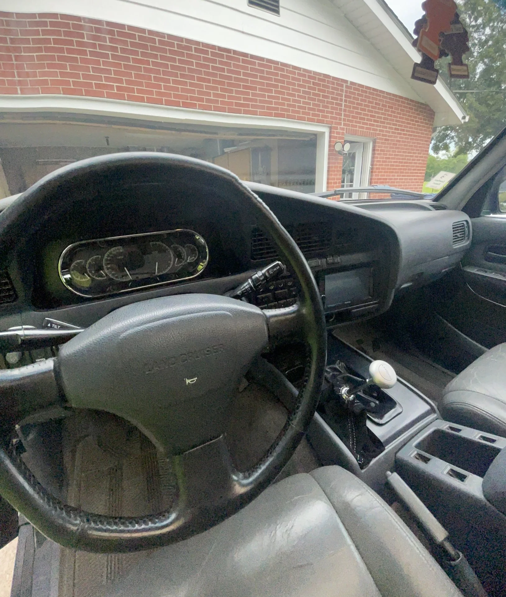

lokar shifter for the 4l80?
Yea today I’ll try to get some better pictures of everything done. Hood shuts no problem with no cutting, and yea lokar shifter for the 4l80, I was going to try and use the stock shifter but got tired of trying to piece it together and just be done with it

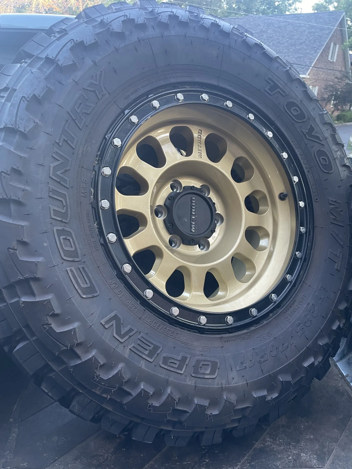

I’ve still got some bugs to work out, I need to either lift the front or drop the rear more it sits to uneven for me, if I lift the front I’ll be putting some new wheels and 35’s on it to fill in the fender gap, TCC isn’t locking up so I have some wiring to chase down, besides that really it’s just cleaning things up

Looks like you need some bigger tires 😉

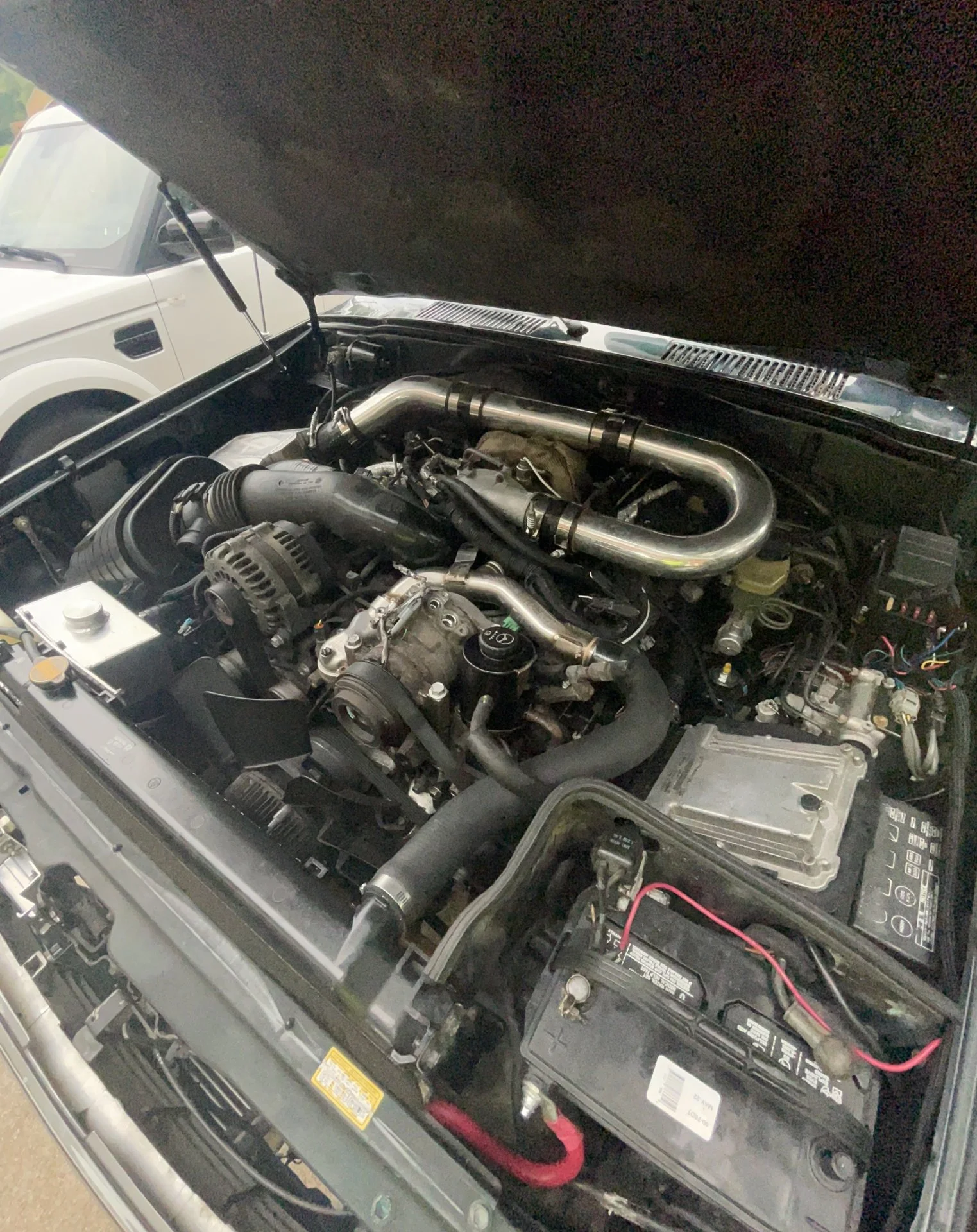

Exhaust turned out ok, local exhaust guy did what he could, 3 inch was the biggest he could do plus the part that goes up and over the frame was a bare, I wrapped the exhaust in the engine bay to help keep the heat out and it’s working pretty good

Where did you source the air to water cooler setup? I’m Always looking for quality stuff.

Air to water intercooler is off the silicon intake store and it’s great quality, not like some polished up turd, it’s straight basic solid built intercooler

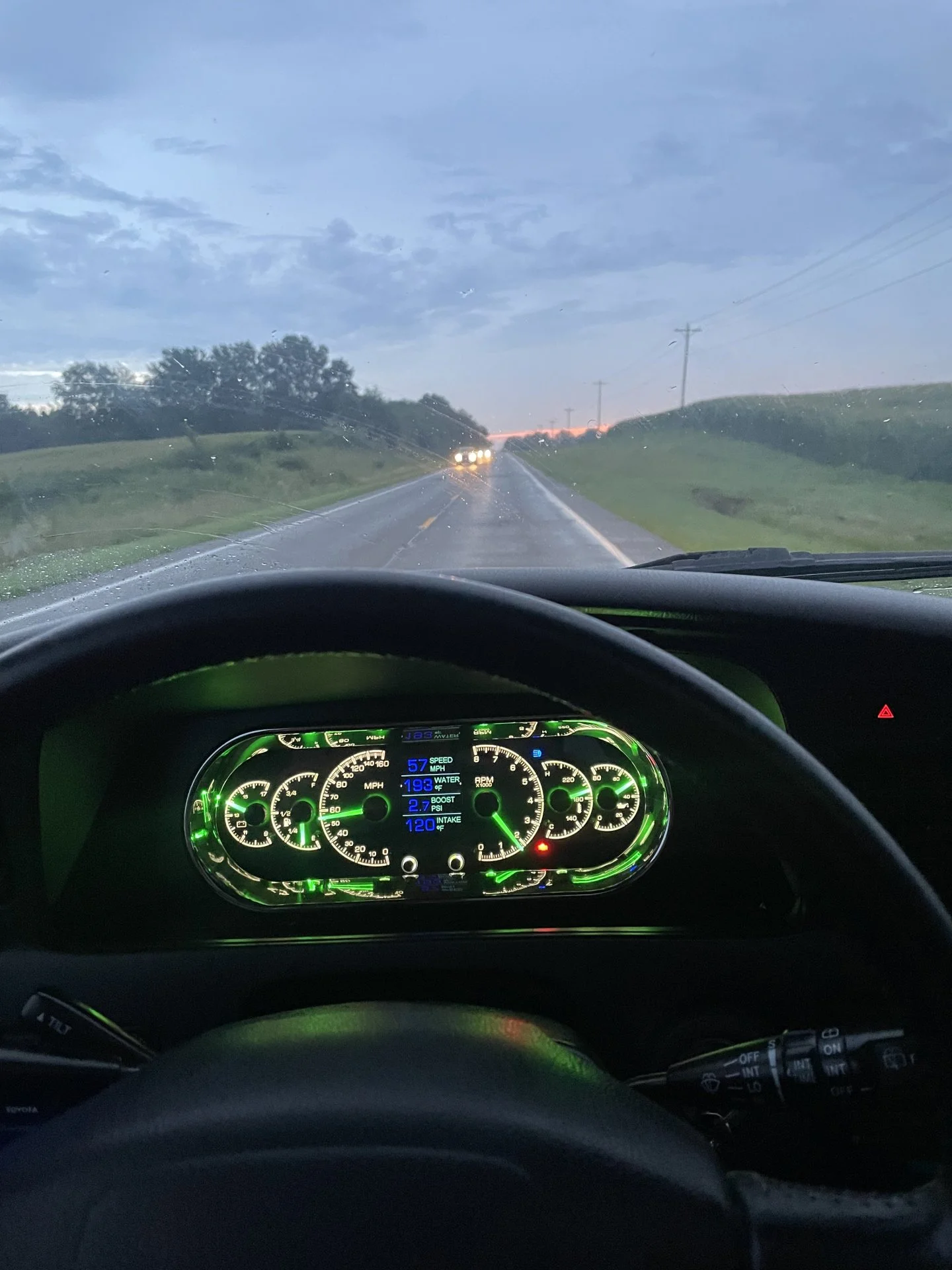

Temp was about 82 or so, I’m thinking my intake temp sensor might be off, it’s been acting weird, I have a temperature sending unit in the bottom of my intercooler water reservoir for the Dakato digital cluster but haven’t programmed it in yet, so I can better keep an eye on the water temp instead of air temp to see how efficient it is

I’ve still got some bugs to work out, I need to either lift the front or drop the rear more it sits to uneven for me, if I lift the front I’ll be putting some new wheels and 35’s on it to fill in the fender gap, TCC isn’t locking up so I have some wiring to chase down, besides that really it’s just cleaning things upView attachment 3077239View attachment 3077240View attachment 3077241View attachment 3077242
What is that open tube next to the maf sensor? Is that open to the atmosphere? That gauge cluster is cool. Does it have locker actuator indicators in it?
