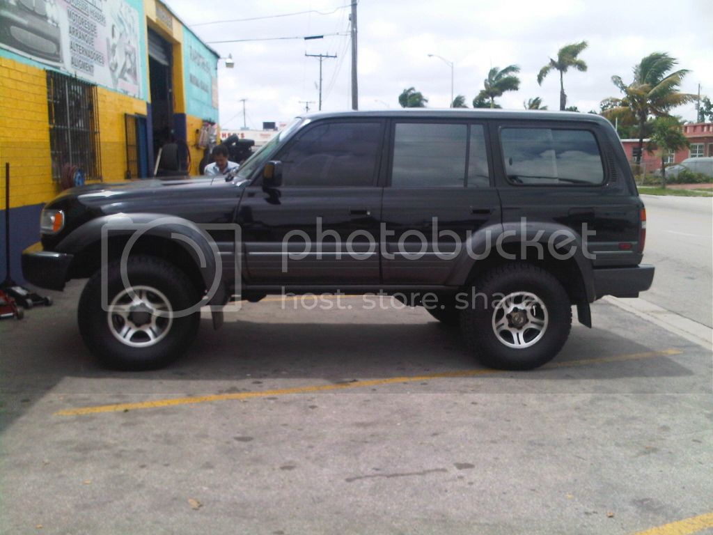

Added 4" Suspension

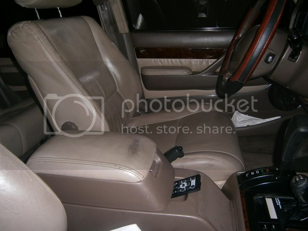

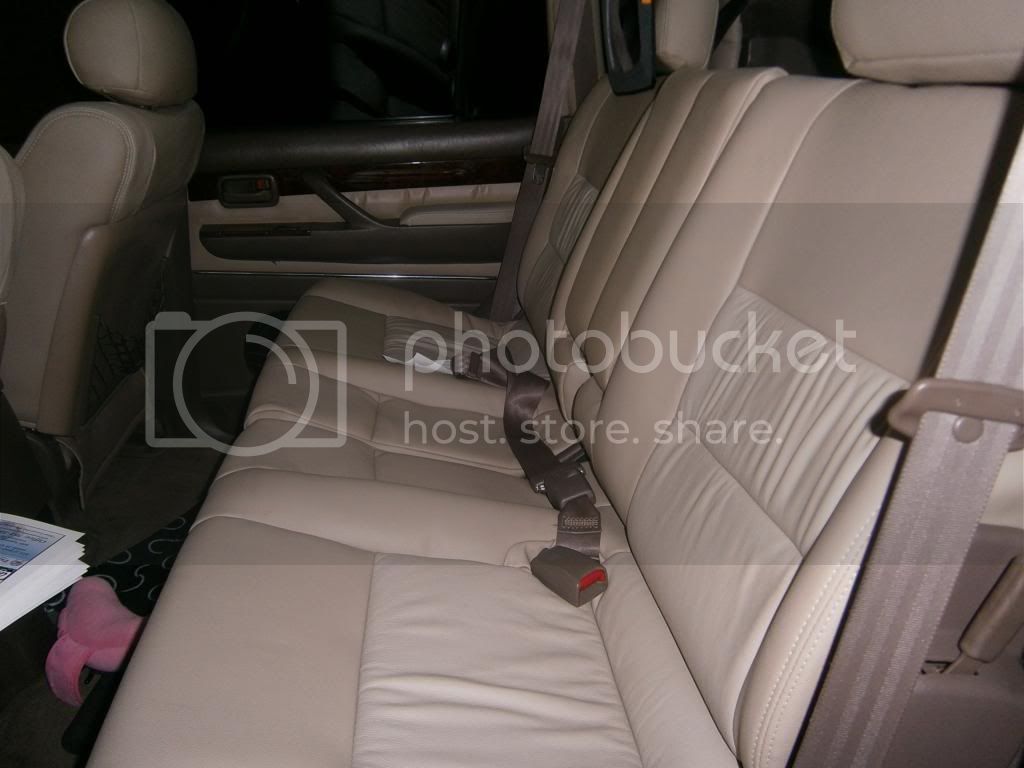

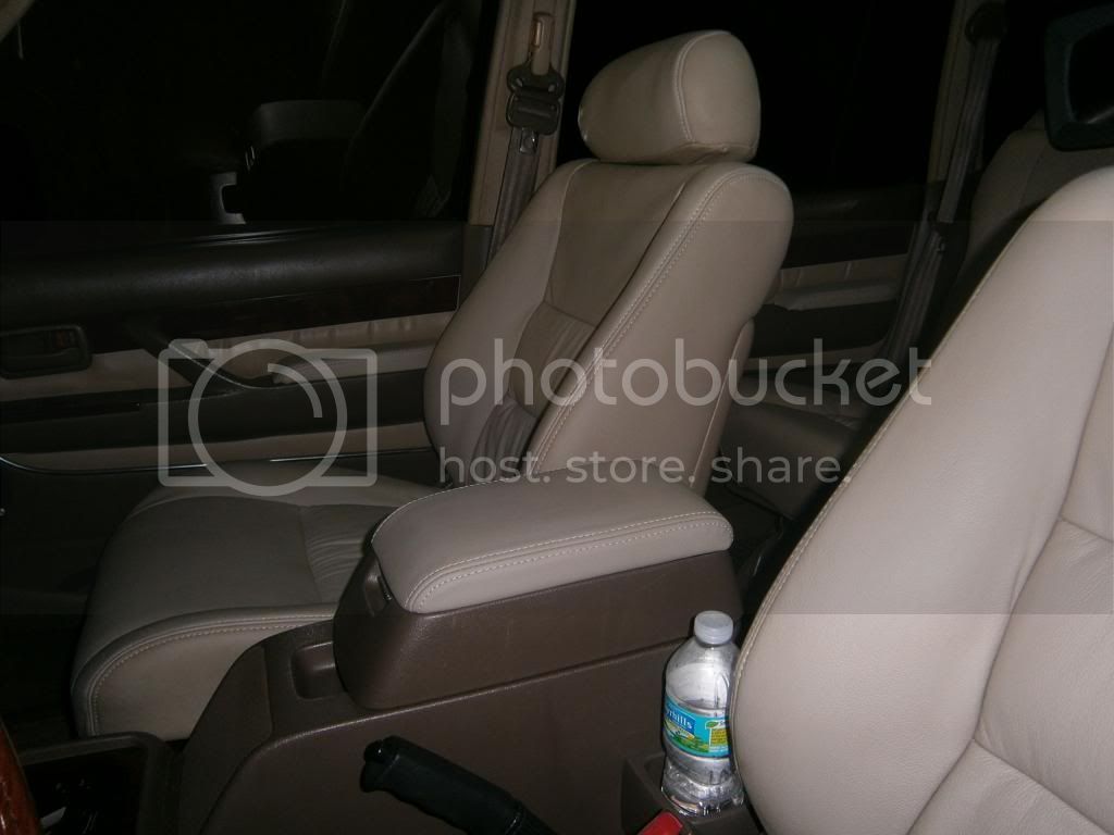

Installed ATLASX Leather kit

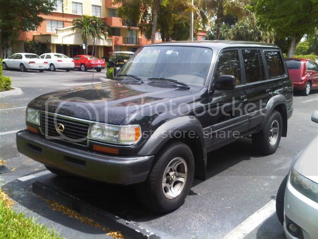

Here is how she looked before the new look
How she sits today!

Probably one of the best 80's I've seen, the wheels make the 80 look different from the normal set up (35's on stock wheels). How is the ride with the 4 inch lift?

The ride is nice. I have the heavy setup so its very stiff. Waiting on when I start adding all the weight from the winch, rear storage, rear bumper, etc. . But I love the look.

What did that leather kit run you? Might be looking to change out my front section as well.
ATLASX1 - here on mud sells them PM him, he has great deals for MUD members,

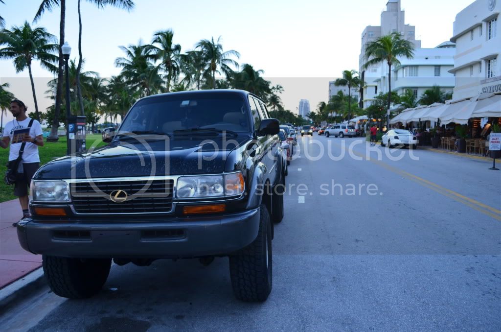

Miami Beach right?? I was there a couple of weeks ago!

looks great. What extent did you go into for the 4"lift? Did you get any drive line whine from the front?

So far I have only changed the front driveshaft to the DC one. I am going to order the extended brake lines, F & R panhard rods (thinking of going with TJM) and the spacers for the bumpstops and sway bars. I am also contemplating getting the Rear adjustable upper control arms from Slee. But havent gotten that far yet.
