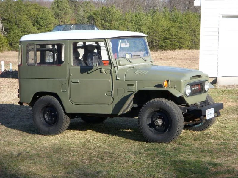

hey, im new to the 40 side...ive spent most of my time on the sixty page working on my 83. i got a 78 fj40 last spring and have been tinkering with it since i bought it. i finnaly got everything running right. got it inspected and am driving it daily now.
things to come...ome suspension...front and rear bumpers...sliders...knuckle rebuild of course...

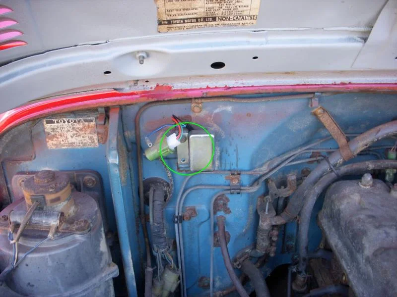

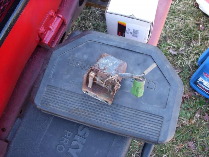

mechanicals right now i have no leaks...knock on wood. clutch is good.... just put on a new voltage regulator...it needs a new water pump and fuel pump which are on the way....new radiator and heater hoses and exhaust....
just got new tires...staying with the 31 10.50's on stock rims...
got Kumo allterains....cheap..great tread...good in rain, light to moderate mud, snow and sand...
this will be a go as i can as with most of us here funds are limited...
oh went for the rattle can...no maintenance paint job...first coat on now...will sand...smooth and coat again...
i will say its fun to drive and cant wait to get it more road worthy for some distance trips to the beach this summer.

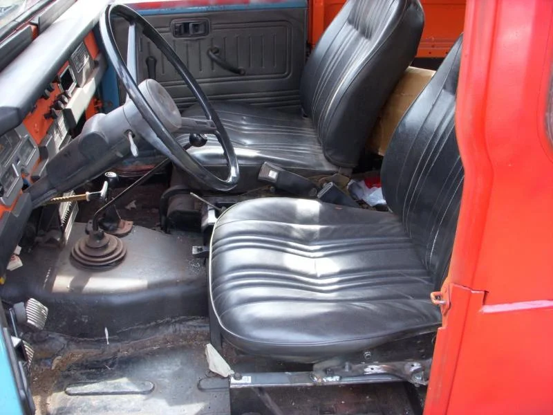

more pics...interior is in okay condition....little bit of rust in normal spots. frame is in decent shape...it will do for what i need

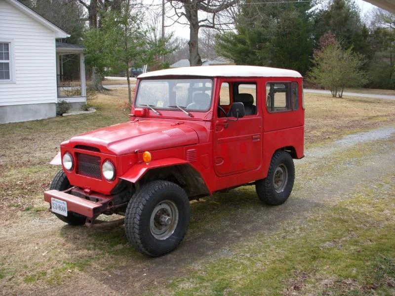

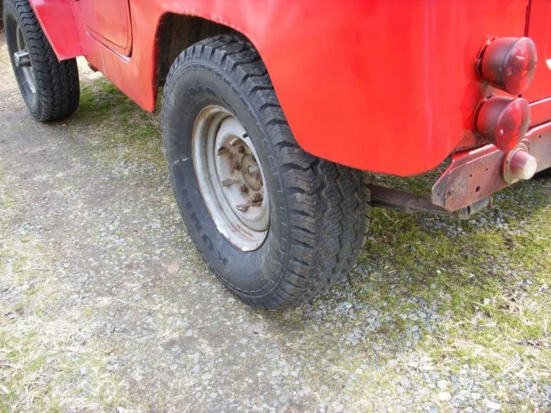

Whats the deal with the front fenders?
all PO stuff....drilled holes for those lights. had to use them for inspection....got oem fronts on the way....tail lights too....damn they aint cheap either...

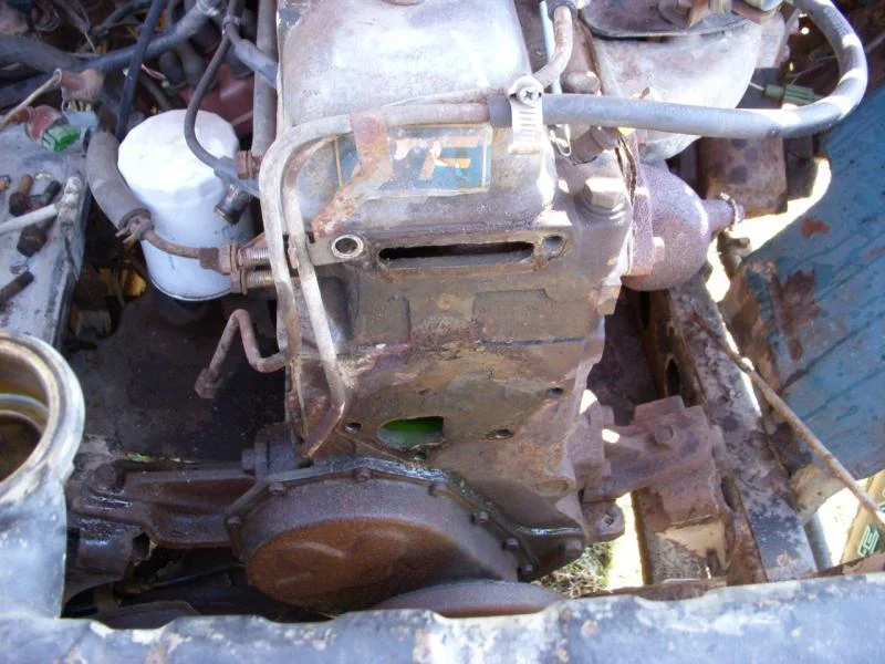

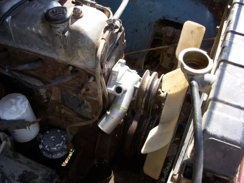

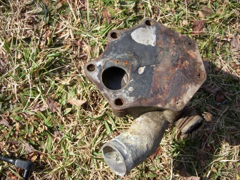

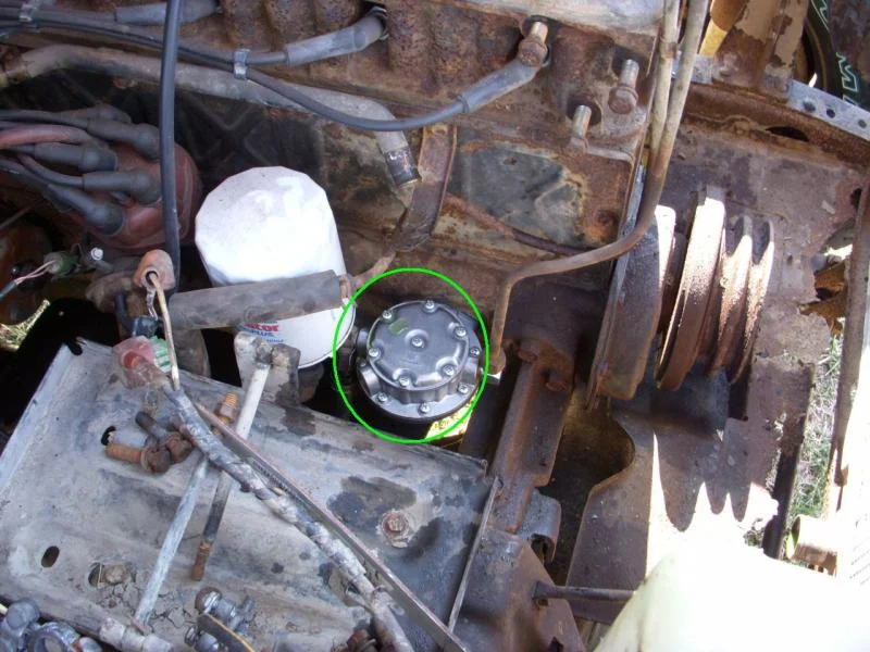

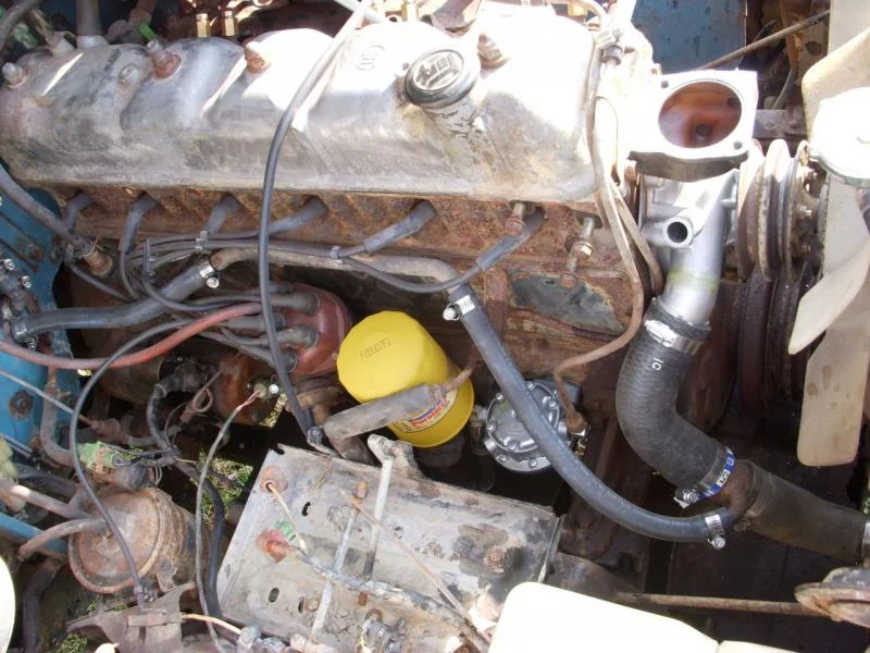

had some leaks...and low voltage...alternator checked out so replaced the voltage regulator now 13.89 at idle....fuel pump weak so replaced with kyosan....water pump leaking from weep hole and bearing sounded rough....replaced with new artex(sp) had an issue with the casting...had to clearance a part of it so it would not hit the timing cover....replaced all the rad.. and heater hoses....damn that hose between the heater valve and the rear heater lines through the firewall is a PITA....put back together...no leaks...yeah
here is the fuel pump and water pump

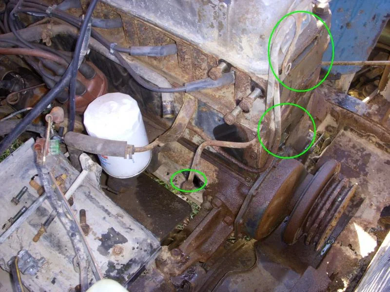

heres the new water pump and part of casting that needed to be groubd down is circled....brole both bolts in thermostat housing...came out okay...new thermostat and gaskets in....

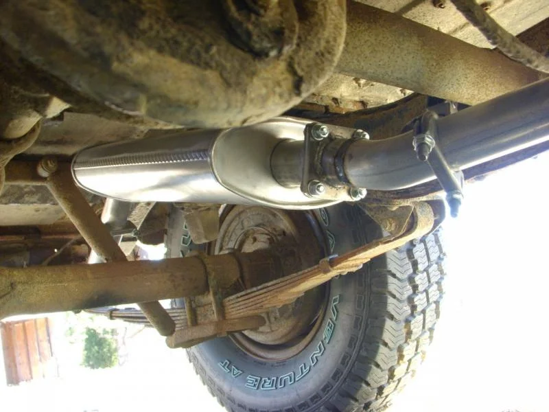

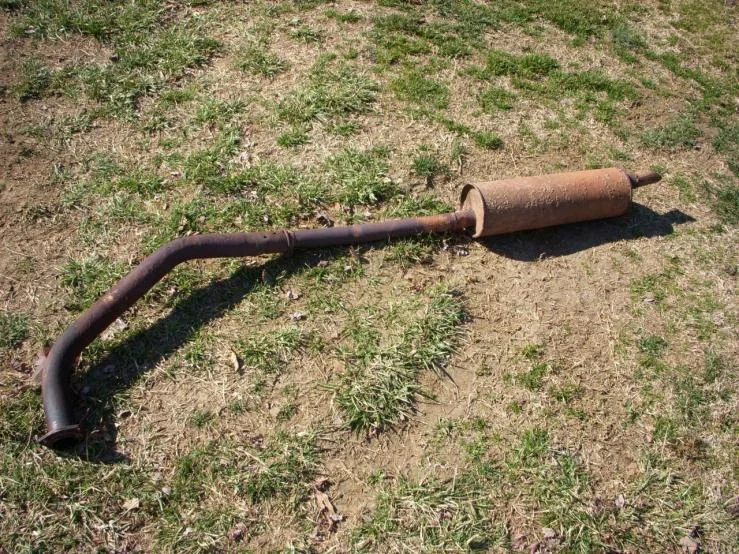

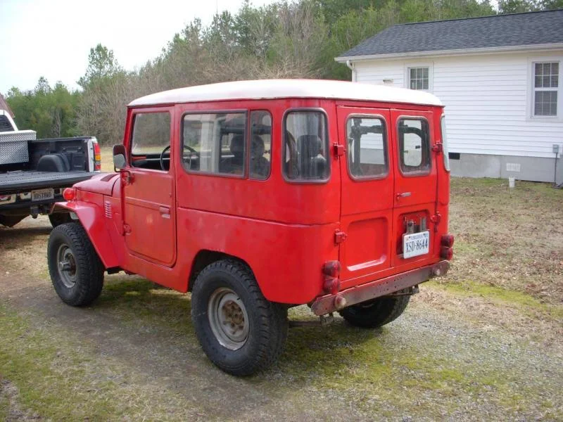

had a few setbacks. since the truck has basiccally sat for w few years and the water pump was bad. i replaced it the hoses and radiator cap. took a 70 mile journey which with flow and pressure the radiator looked as if it had a hundred tiny holes. so new radiator upper hose and put in a yellow top cranking optima battery. then my exhaust/intake gasket blew and holes in the exhaust. got a new gasket and an exhaust system. took off the old exhaust breaking all three exhaust manifold bolts two i was able to get out one i had to drilll and tap. new gasket on. got the exhaust system in and it was supposedly made for a 40...bolts right up...not...the damn thing did not fit right and had more bends in it than a windy mountain road. thank god for mig welders...after an couple hours of cutting and turning and fitting took out 4 feet of exhaust pipe and got everything tucked tight and out of the way...it sounds good now
heres some pics of it installed....i also added my first base coat of paint....love the color....
