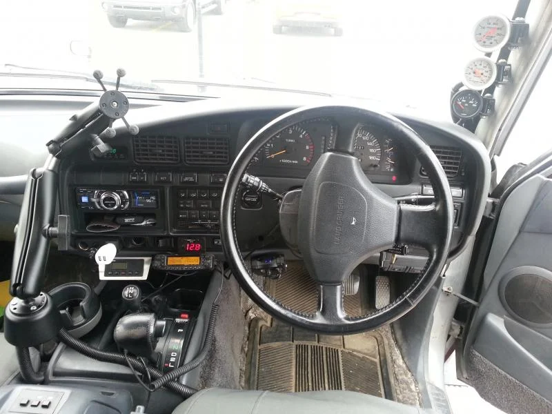

My front 12V aux outlets are also off the fuse panel in the back and I have a little LCD Voltmeter which plugs into one of the sockets so I can monitor the voltage. When the truck is running the Aux battery is charging at 13.7V, I flick the switch at the back and the Aux battery reads 12.4V...so I know its working correctly!

thanks for sharing. I am fighting with electrical right now so this gives me some ideas. BTW Nice FT-8800 Crossband radio! I have the same one. You may know or have done this, but i took some florecent yellow and orange model paint and a tooth pick and highlighted the indent on the knobs for vol orange and squelch yellow. Helps see where they are set, b4 that it was impossible to see.
