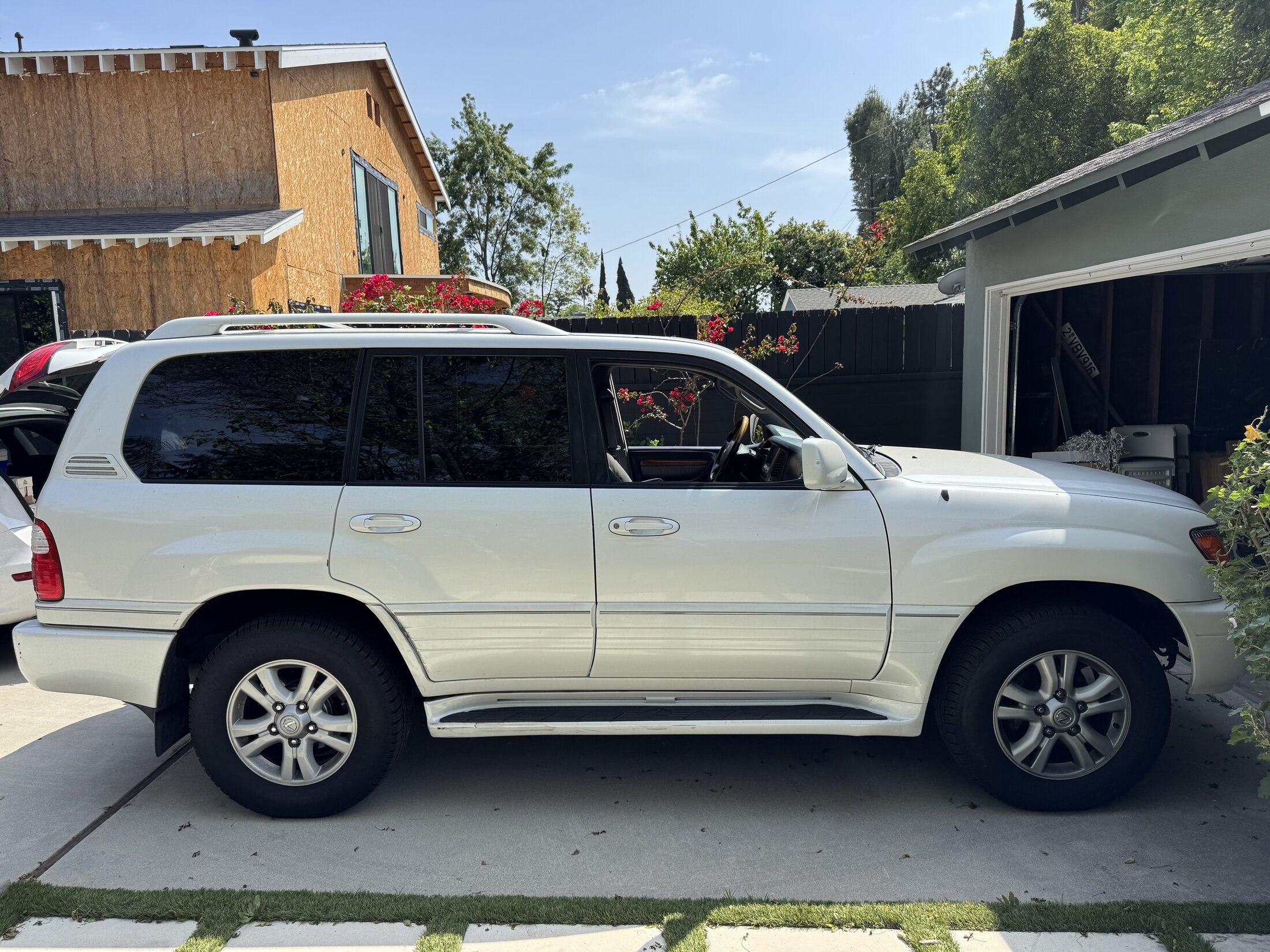

Hello members,
Just acquired this 05 LX with 193k miles. It has a few bumps and bruises but it has zero rust as it's been a California car all its life. Mechanically the car seems solid but it does need a few things to get it back to a solid baseline. The AHC works as it should, the low range box engages and so does the center diff lock. I have been reading a lot on these boards and I am glad that there is a wealth of information on here.
Below are the things / concerns I have with it.
  • The gauge cluster is acting up. I have read that many owners experience this issue and it seems like the only solution is to send it out to Tanin or it looks like another member had luck with a shop local to me in Whittier CA. Any other solutions that I may have missed?
  • This truck is missing the drop down entertainment screen that also acts as the dome lights on the headliner. This means I currently have a gaping hole on the headliner. Is there a solution to this aside from sourcing another screen on the used market? Is there an option to just have a dome light? I don't care for the screen as it's very dated.
  • I got two keys for the truck but they are just keys with no remote to lock / unlock the doors. Is the dealer the only option or is there an aftermarket solution that works?

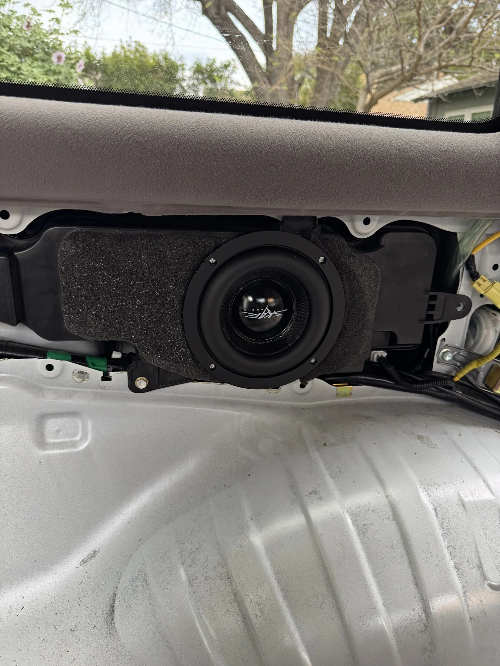

After the cluster repair. I ordered a Skar Audio 6.5" subwoofer. Wired it in sequence to make it 8 ohm. The fit was basically plug and play, I only needed to modify the sub enclosure by shaving down the ridges inside. The sound is so much better now. The trade off is I have a bit of rattle on songs with heavy bass so I will investigate to see what I can tighten down to minimize the rattle.

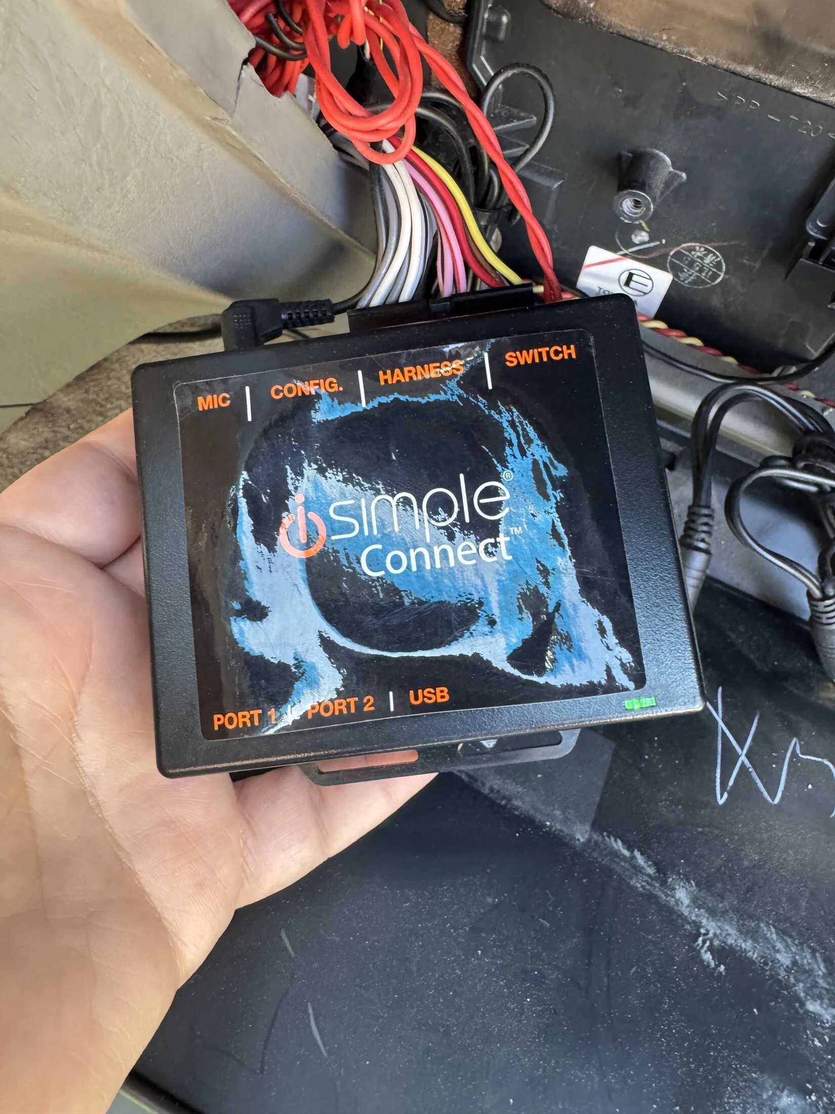

Also while I was at it I finally got around to tracing the cable of the aftermarket microphone. I found a bluetooth module behind the glovebox. I was able to look it up and figure out how to pair it with my phone after some trial and error. This was a pleasant surprise and now I am able to stream my music and the sound quality of the calls are much better.

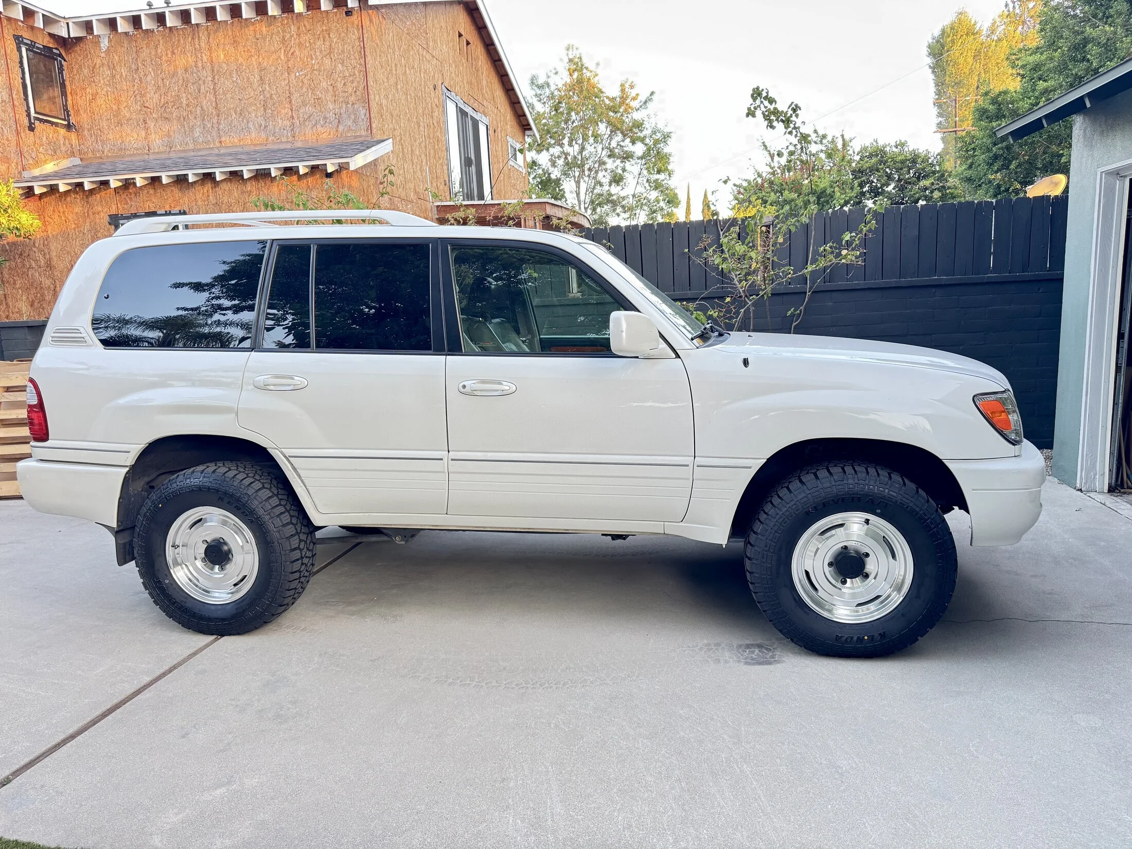

It's been a little while since I have given an update. I have been able to do some upgrades.

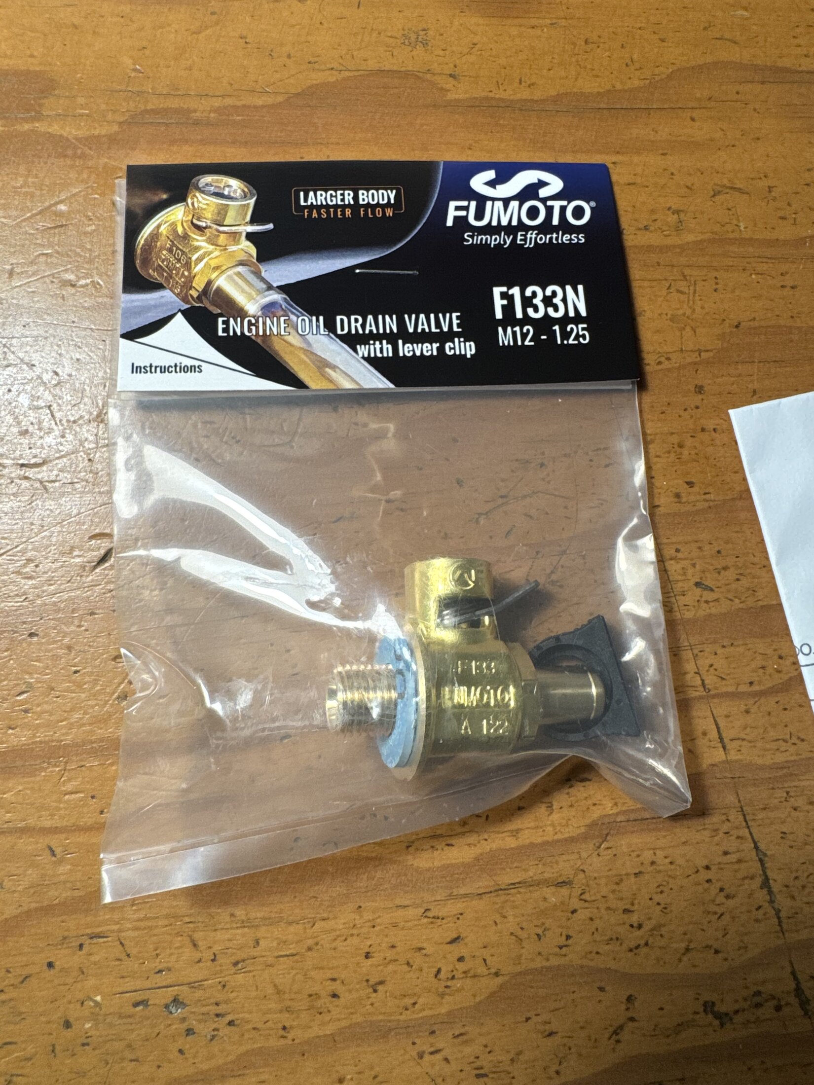

  1. Got the Fumoto valve on for easier oil changes in the future.

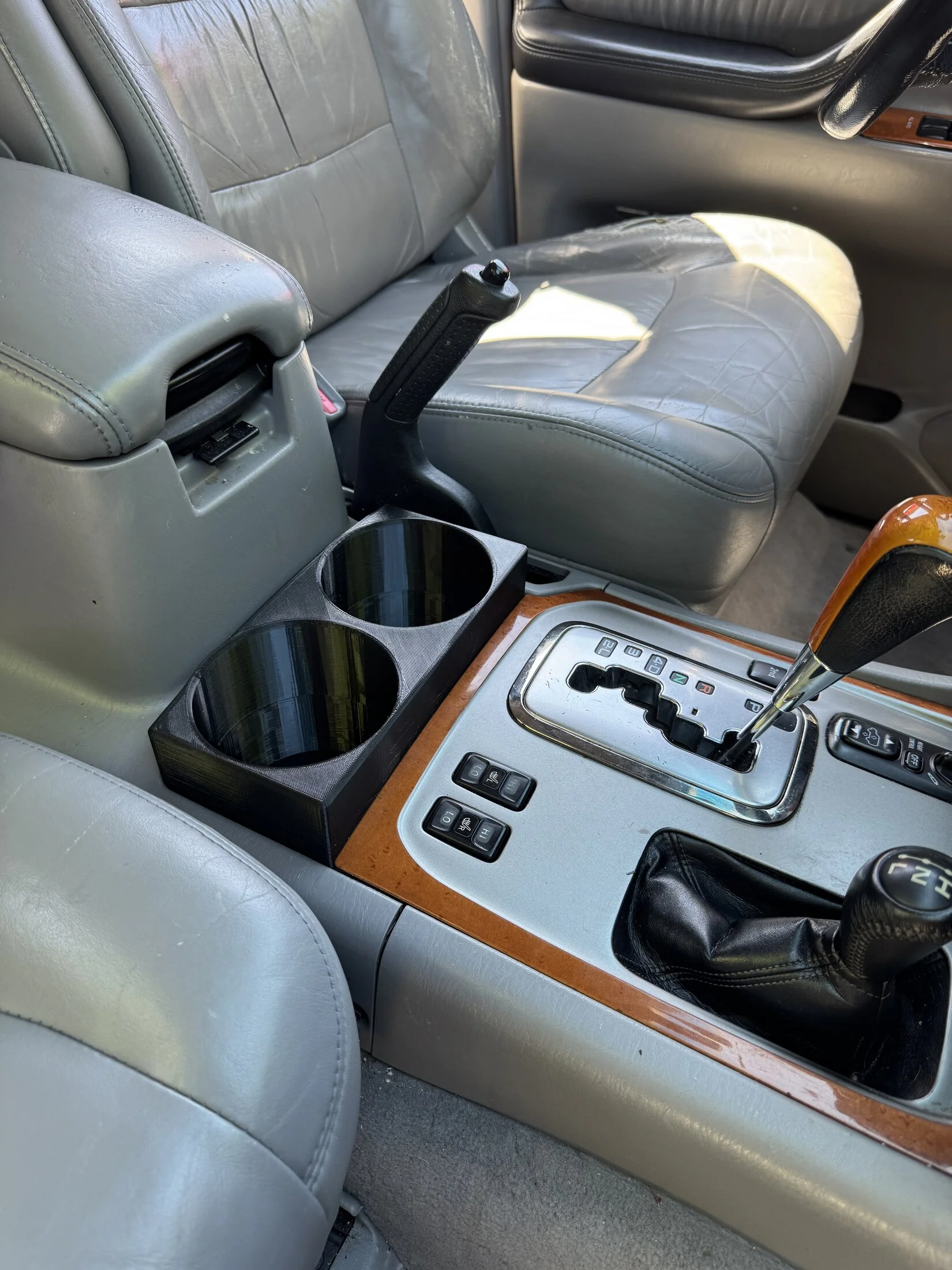

  2. Installed the @CruiserDM large cupholders. I can now fit my 40oz hydroflask in there.

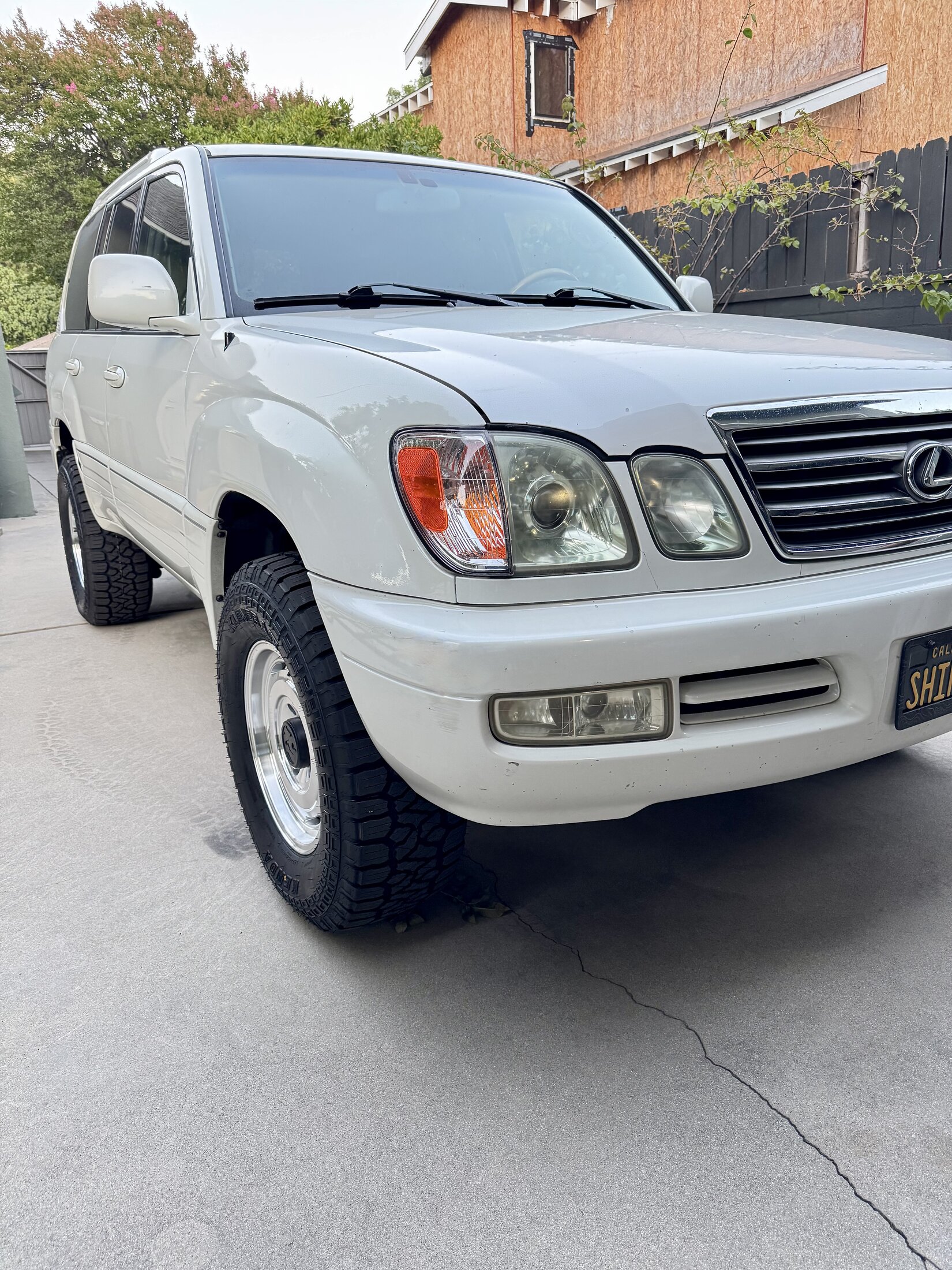

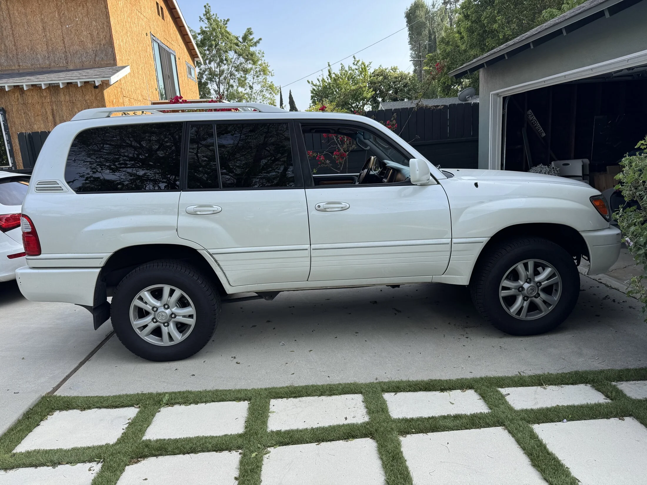

  3. Just yesterday I got my wheels and tires mounted. I went with @fifteen52 Analogs machined finish in 17x8 +25. After extensive research I ended up getting the Kenda Klever AT2 in LT285/70/17. The price and positive reviews out there really sealed the deal. I was able to order the center cap spacers from @CruiserDM.
Got to install the subwoofer cover made by Ben3D. While I was at it I put sound deadening tape throughout the sub area. The new cover gives the sub space to move therefore eliminating any rattle I had.
