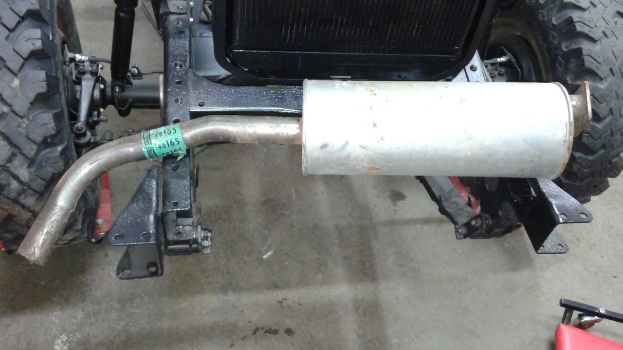

Anybody have any idea what this muffler is for? It came with my 1977 45 when I bought it and I assumed it was for the 45. Its older but never been on. I went to put it on today and the inlet end flange was right but the tail pipe end was not even close. I couldn't find anything on Walkers site using the numbers on it. A 40 maybe?
I think I answered my own question by looking on SOR. Looks like a late 70's 40 oem style that goes across behind the rear axle.
here is a brand new OEM muffler for a US spec 82 fj40
Toyota still sells a black muffler for late 60-mid 70's Cruisers, its really cheap, $55, got one someplace, going to use it on my 45LV I think

Is that flange four sided or three? The 1/79 and later is three sided.

John could you get a picture of the bracket the tail pipe hanger bolts to. Working on putting my 79 exhaust back to stock and the muffler/tail pipe the PO installed uses a hanger that's closer to my stock exhaust on my 76. 82 frame I have has a bracket but only uses two of the three holes in that location on the frame.:hmm::meh:
I picked up the heat shield for the pre 75 muffler over twenty years ago. Believe only used from 72 to 74. Wish I would have bought a few instead of just one. Seventeen dollars comes to mind as to what it cost.
think its for early to 74, its nothing exciting just a black tube type muffler.
