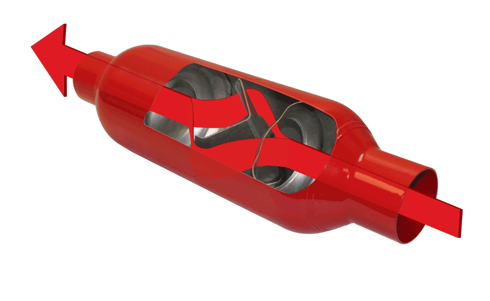

Cherry Bomb M80 is a decent tubular single chamber to knock out drone. Jones makes the same thing, too for a little less.
I'll have to talk to the muffler shop about that. Would be nice to keep it a one trip ordeal. I have a feeling my original plan would result in a bad drone.
I have a Jones version I need to get the flanges welded onto so I can put it on my Tacoma. It is the exact length of my plugged cat I removed and now it sounds like someone blowing raspberries into an empty 5 gallon water bottle. When I get it on I will let you know what difference it makes. It is also a 4cyl and not a v8.
Same design as this m80.
I always thought 4 cyl tacos sound better than 6 cyl. Hope that setup works out for you.
