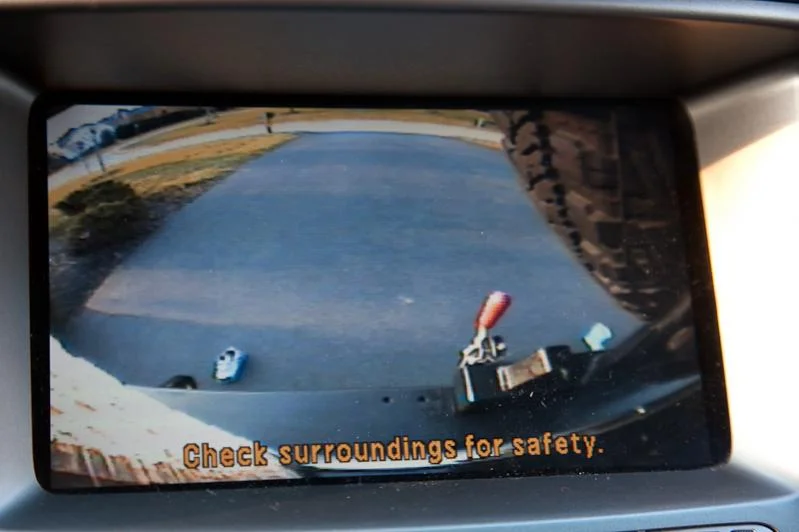

The view is not so bad anymore
Nice work. Very clean. Thanks for pointing out that Slee has a bracket. I wasn't aware if that. Here's mine from the other thread for comparison. Similar if not the same tire size.
Before pic
Thanks Jon. I made them about the same size for a better comparison
Now instead of the tire being in front, your catching the side of it. I may have been able to move it over another inch, but I am happy with the result

And here are the most important ones (the results.)
You can track in the pictures the location of the blue boot and sneaker. They are stationary for all the photos so that you can get a sense for what is now visible from the rear-view camera.
My only negative observation on the mod so far is that the drivers side reversing light creates significant interference/flare with the camera at night. I think I will just remove the bulb, or try to create some type of a shield to try to block the light pointing into the camera (on the screen shot, you can see the reversing light on the left/bottom edge of the image)--I was planning on installing a separate reversing light in any case, so this should be fine.

Glad it worked for you. Interesting as it looks like we located them the same, but I don't have the light in my bottom left corner view as you do
attachment.php
mine
attachment.php
Now I see, thats a feature of the LX. I don't have a light there
