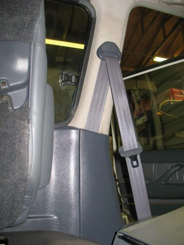

Purchased an 80 back in Sept. The previous owner disconnected the seat belts (shoulder straps) and it looks as if he improperly installed prior to the sale.
I will need to start using the rear seats and want to insure that I have re-installed the belts properly. Any reference pictures or help would be appreciated.
KS
2nd Row Seat (Drivers Side)

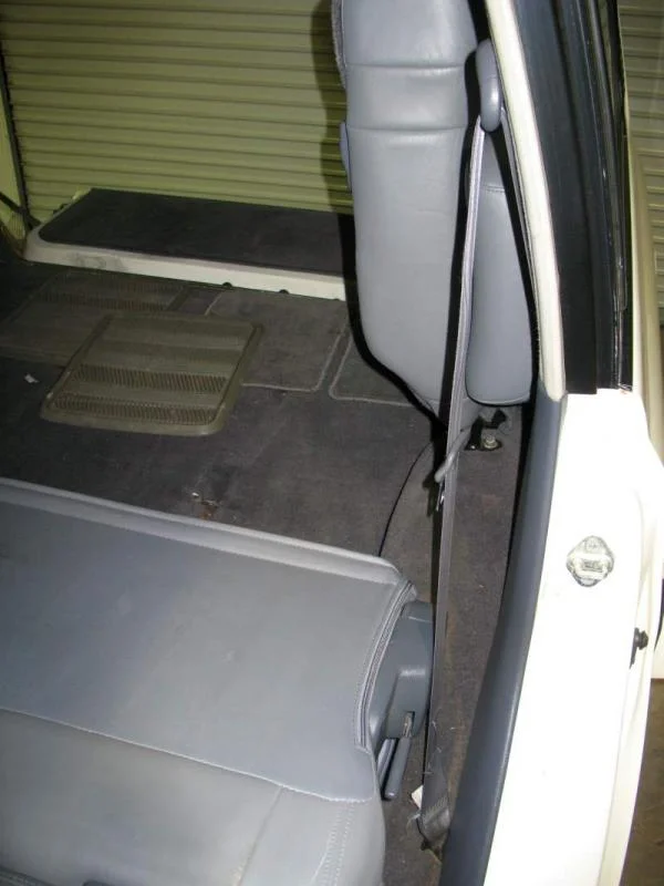

Here are two pictures of the drivers side seat belt in my wife's '95.

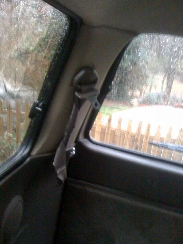

3rd Row Seat (Pass Side)
And here is an image of the seat belt for the 3rd row passenger side.
PS Had these pictures ready to post yesterday, but I kept getting loading errors. I hope you still have some time to make use of them.
