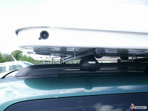

Here is a Maggiolina on a Thule 450 Crossroads system on late model 4runner factory rack rails...
Romer
