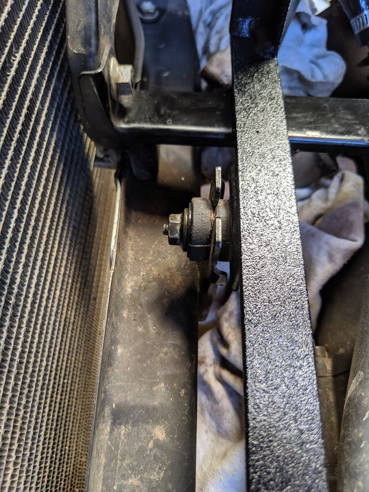

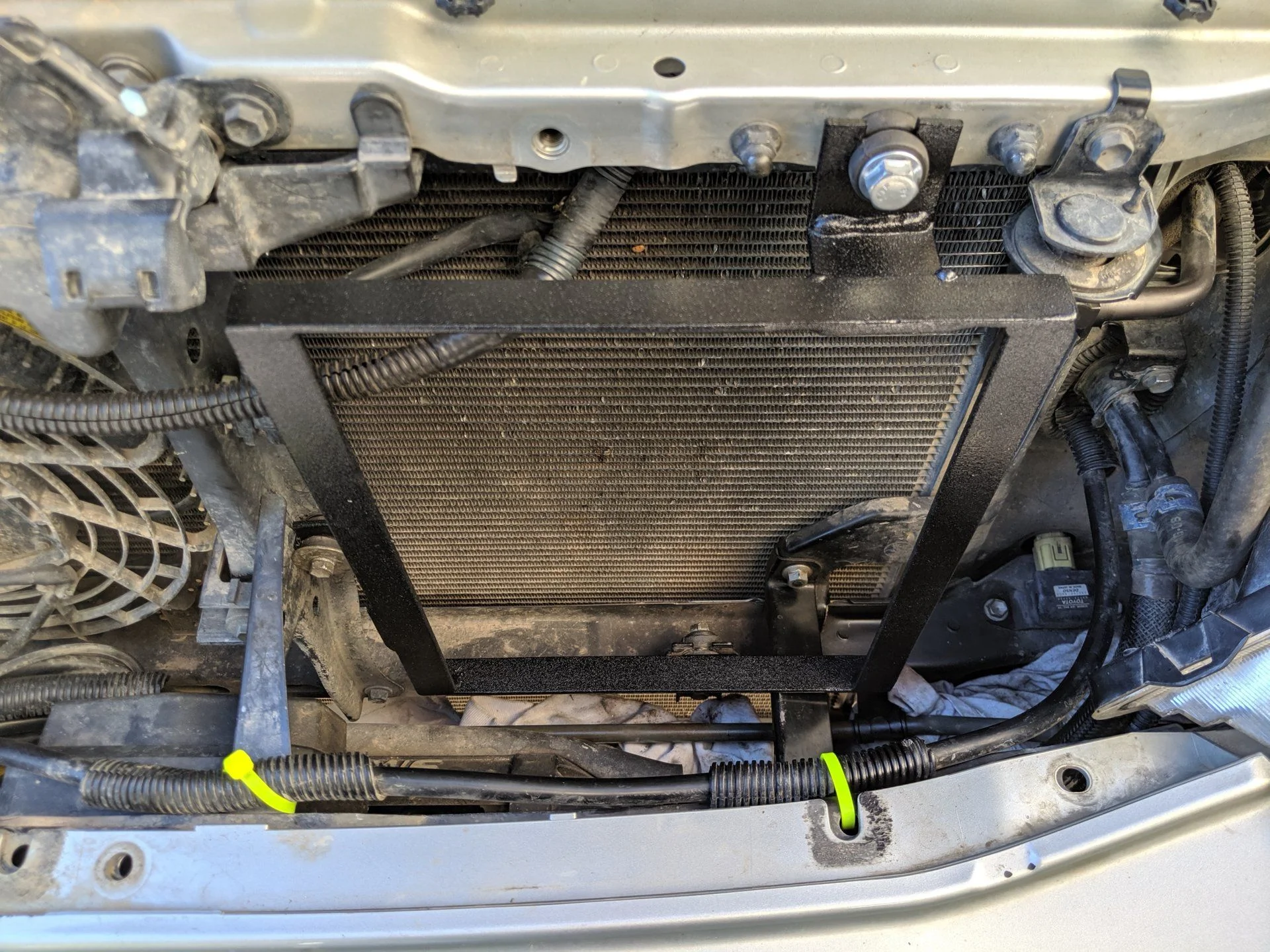

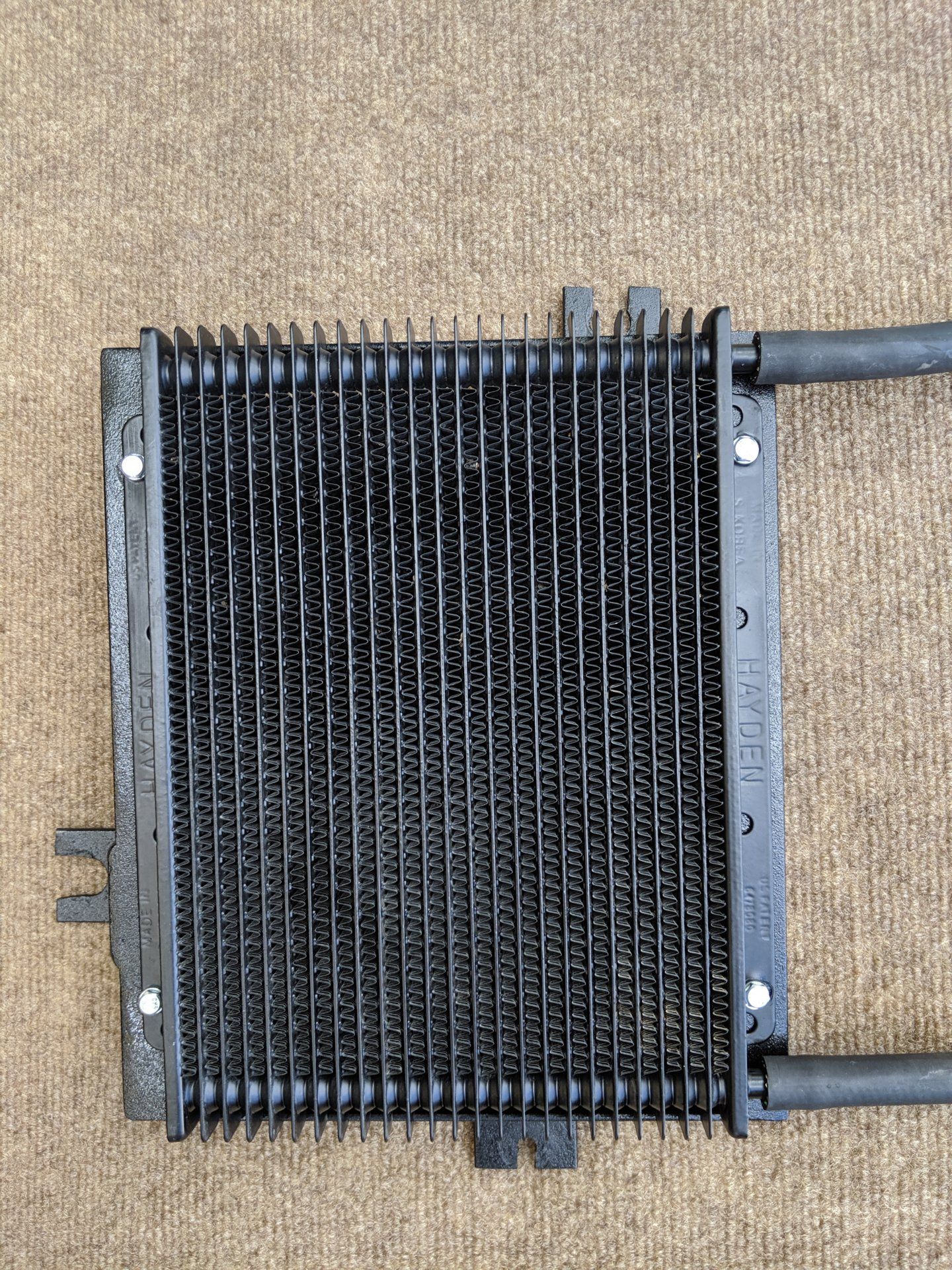

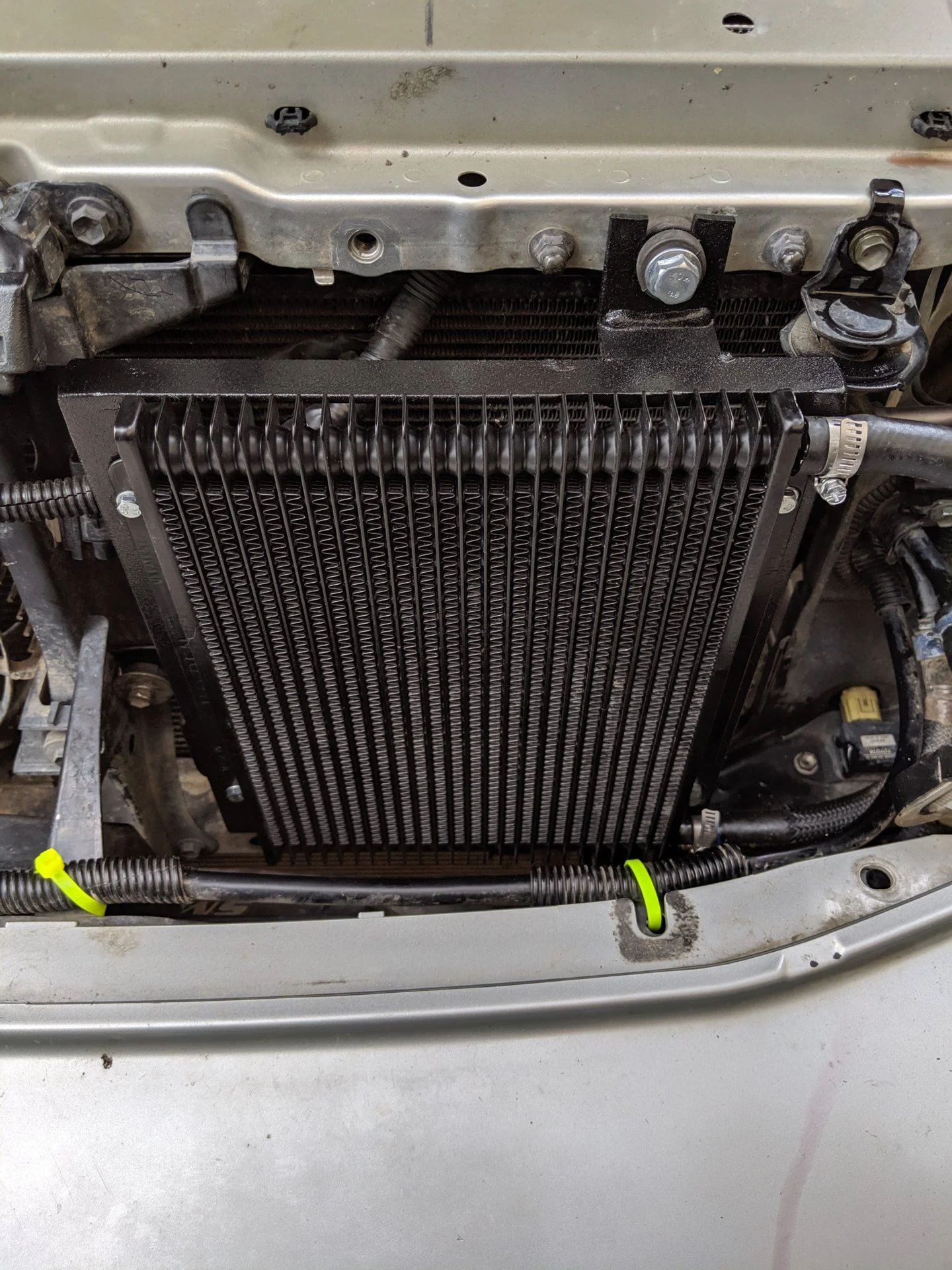

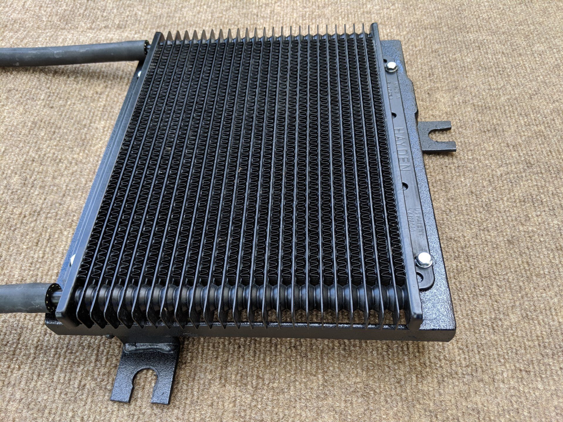

Introducing the Mountain Passes Transmission Cooler. This replaces the OEM cooler but is 3 times larger at 11"x9.5". This is a plate and fin cooler from Hayden Fluid Coolers. The cooler is under $50 on Amazon. It is a quality Plate and Fin cooler, similar to OEM. NOT a poorer quality tube and fin design. Comes with hoses and clamps. I will provide a welded frame that fits in the OEM rubber isolators just like the factory transmission cooler. This is very important for vibration resistance and durability. I also provide wires to relocate the horns and instructions. I used to see 220F+ empty on Colorado passes. I now haven't gone above 201F towing 4000lbs. Huge improvement. Frame Kit is $150 + shipping. You buy cooler on Amazon. GX470 at this time.

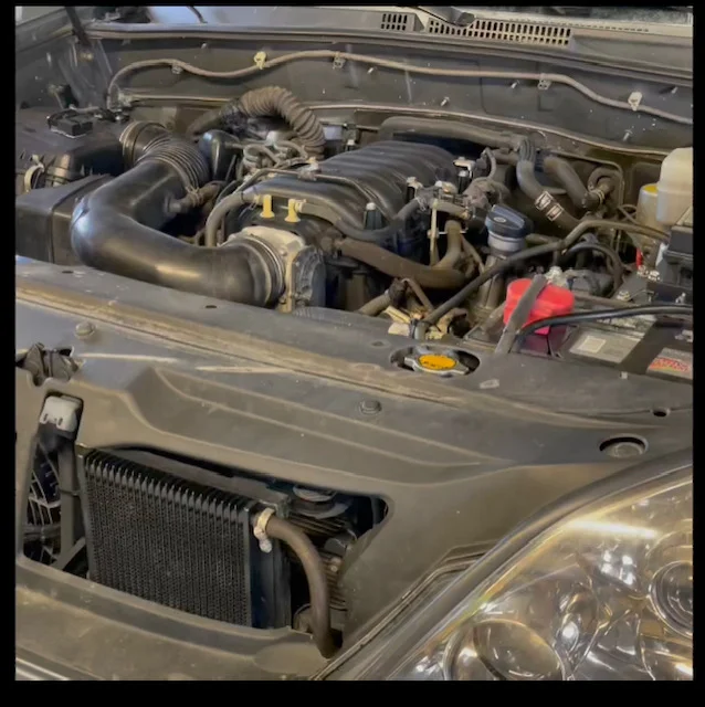

2. Getting a cooler that is much larger than OEM decreases airflow to the radiator. How big is too big?
Not worried about "over cooling" the Trans so much as decreasing airflow to the radiator. Especially as seems to be common wisdom around here that the VVT-i engines run hot(ter).

I have run this cooler kit for a few years and I like it. I picked it up from Steve(I think that's his name) along with a rear platform, at his house in CO Springs, super nice guy. The install is surprisingly finicky but the frame and cooler fit perfect. I was able to modify the trim piece to retain it because OCD. I dont have any empirical data on controlling temps but I trust that it does because bigger is more good'r. Gives me piece of mind when driving harder than I should over mountain passes loaded down with a RTT.
