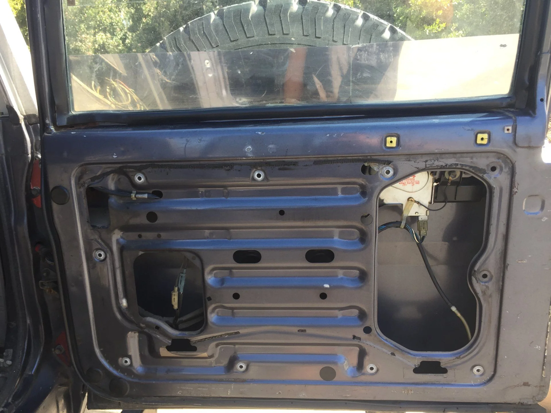

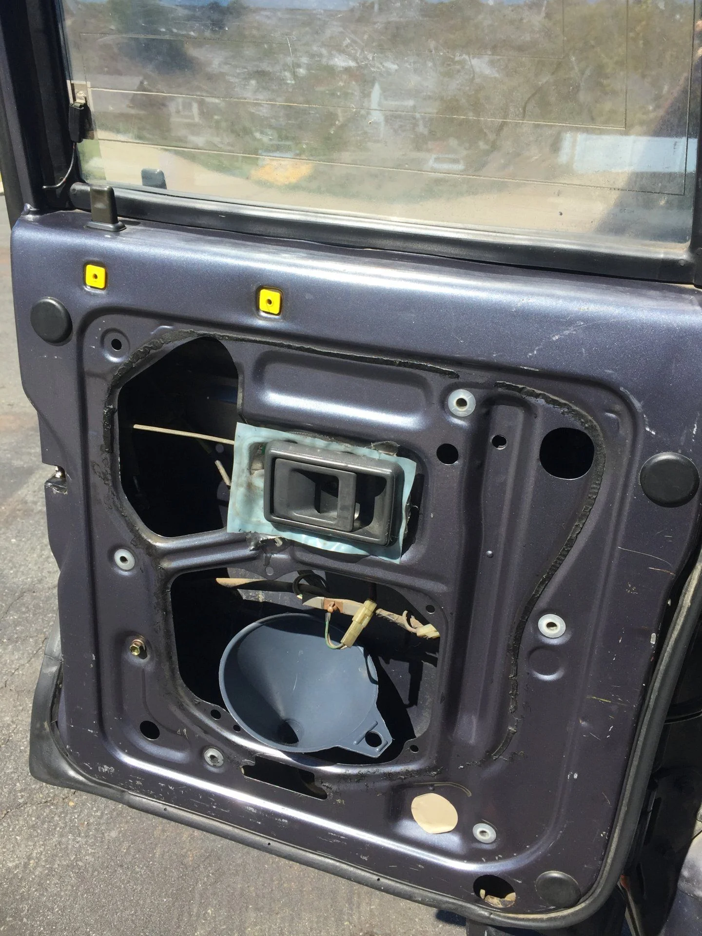

So today I had some free time so I spent it taking apart some of the interior. I spent a few minutes trying to remove the rear seat bolts to figure out that it had a female nut under the chassis. Whoops. So I continued to take off the door panels and rear carpet. So much dirt and so much sand oh my! I was sneezing and my eyes were watering! I’ll be taking a magic eraser to some of the trim and lighter pieces and continuing the dismantle of the interior. I was also able to solve my sticky door handles and locks with some WD-40.

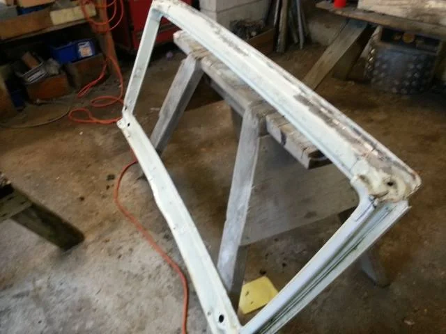

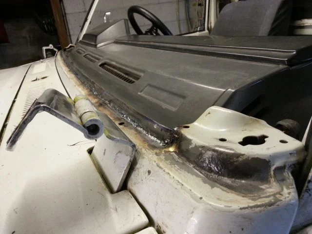

Hinge the screen forward and check for rust....Mine looked mint from the out side but the lip the seal sits on was almost completely gone . The bastards rust from the inside out....Its worth checking even if its good just so you know .. I bought a new rubber seal but it leaked so i reinstalled it with lots of urethane .( id just reuse the old one if i ever did it again )
I sure will look into that area. I kind of don’t want to know based off of fear but I’ll be taking the top off as soon as San Diego gets into the 80’s. I’ll inspect it then.

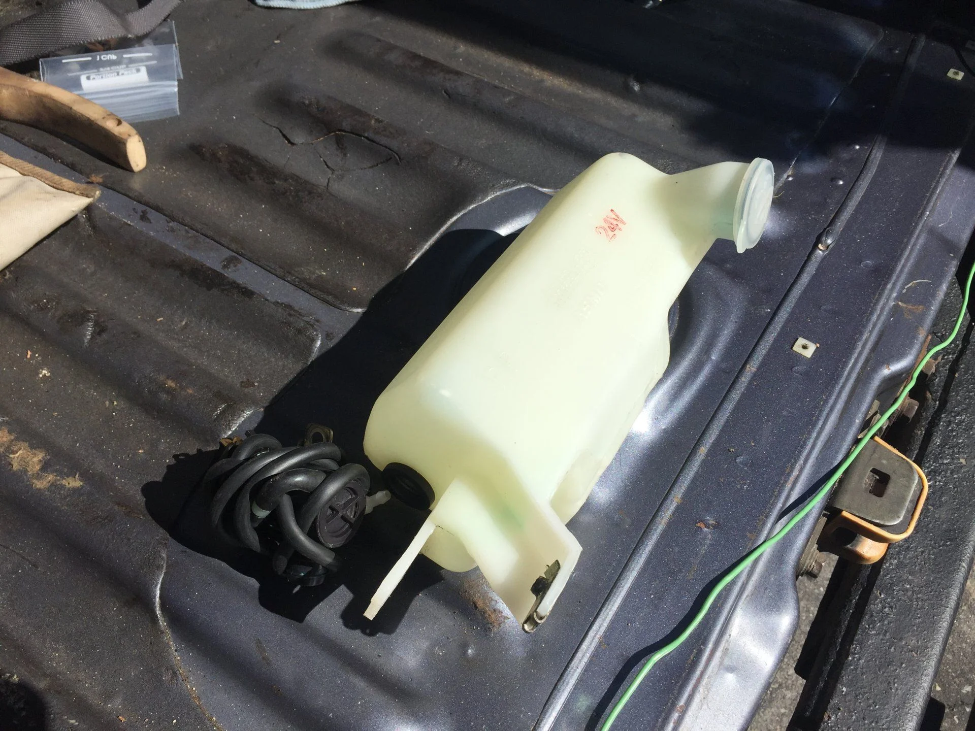

On another note I guess the PO took off the rear wiper blades so I have the sending unit and the bottle housing if anyone wants it, just shoot me a shipping label and it’s yours.

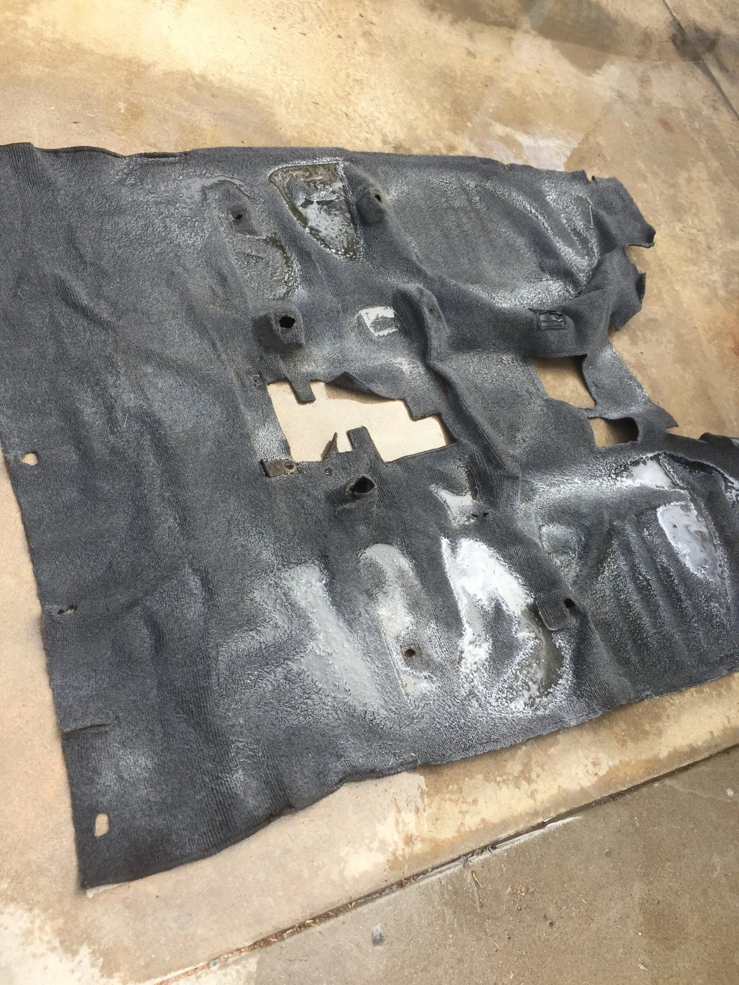

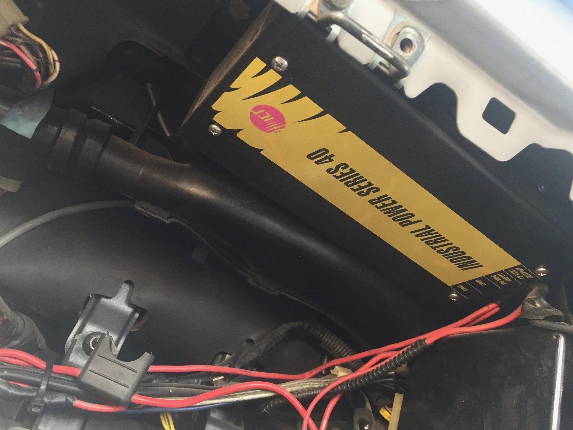

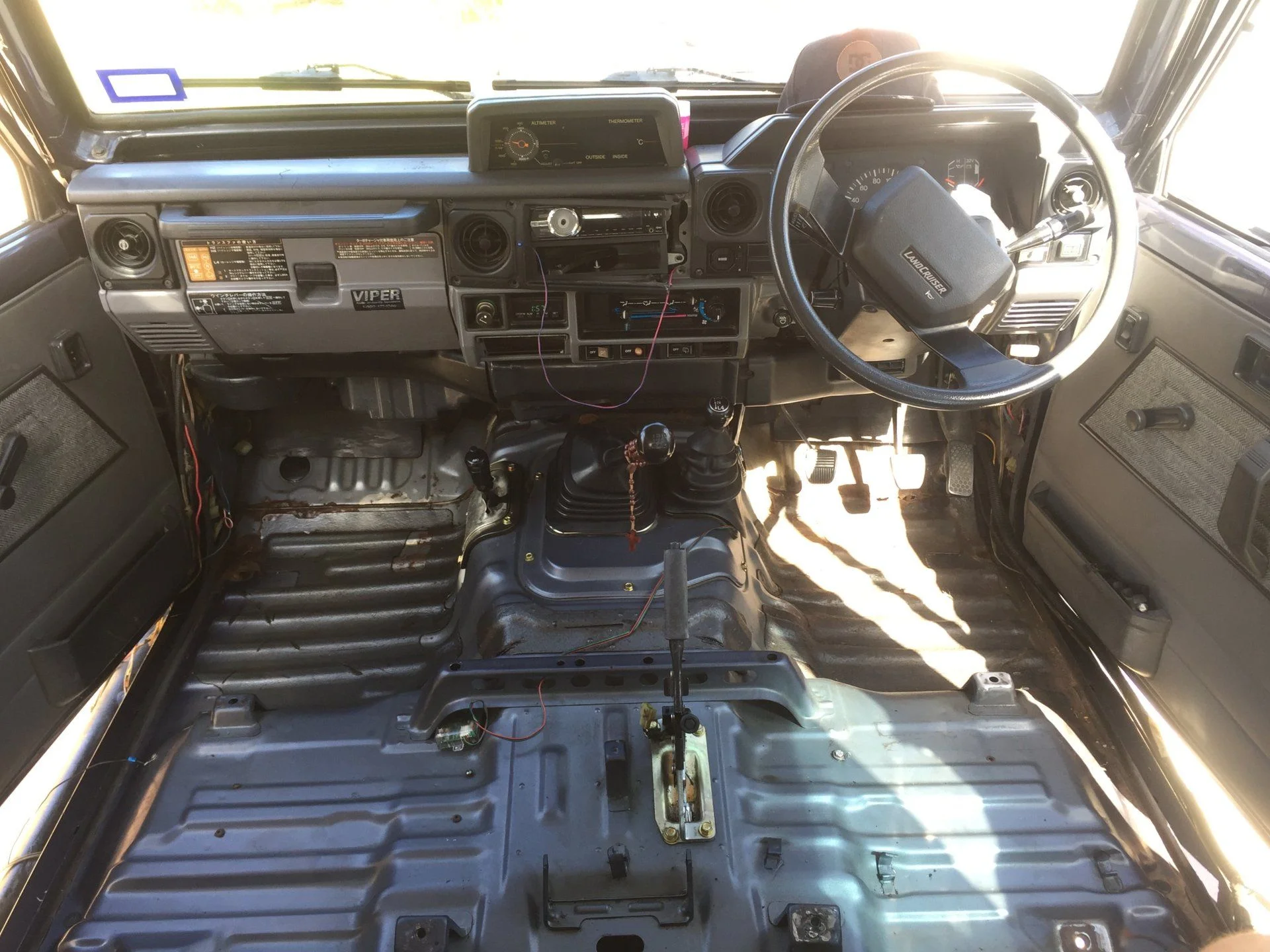

Finally had a couple hours today to squeeze in some interior stripping and cleaning. Found a couple light rust spots so I sanded it down to bare metal, Ill be picking up an inhibitor and neutralizer tomorrow to clean up to exposed steel with. Then Im going to clean it all again spray some 3M super 77 and lay down some heat insulation. Im surprised as to how dirty the underside was! I couldn't even show the picture its so scary haha. I also found the 24v to 12v converter which is cool. Im learning more and more about the Goat as I dissect it. I gave the carpet a much needed power wash with some detergent to help with the smells. After I study tomorrow I will probably soak the old tint in some chemicals and attempt to remove it. I also removed the rear A/C. I have the pigtail for the button and can remove some of the wires if anyone wants it. Not sure if it works or not.
Edit: I forgot to add that I found 4 blown fuses that need replacing from the P/O jumping the truck incorrectly. Gotta love fuses.
