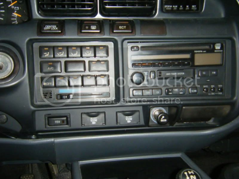

After removing my rear heater and switch I figured I would solve this issue. Toyota makes a 110V outlet and switch for a few of their newer vehicles. I ordered in a couple of outlets and a switch from an 07 Matrix and installed them where the rear heater fan switch was. Installation was stupid easy since these OE switches fit the 80's holes perfectly.
Wiring is pretty straight forward for the outlets, the switch has leads for the dash lights as well as a power.

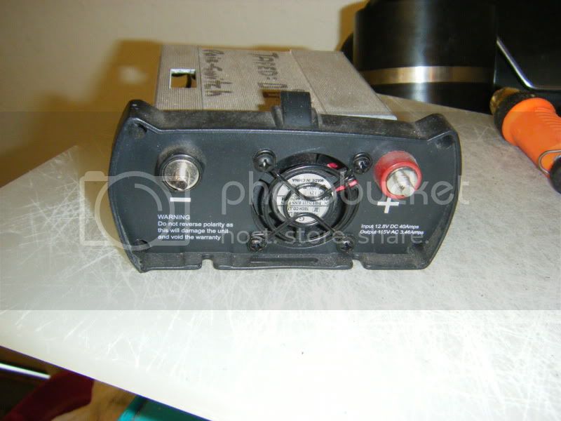

First, I removed the stock radio amp which made room for the 500W inverter.
I removed the case and connected the inverter's on/off circuit wiring to the OEM switch through a 30 amp relay.
Next, I removed the inverter's outlets and extended the wiring to the outlets in the dash.

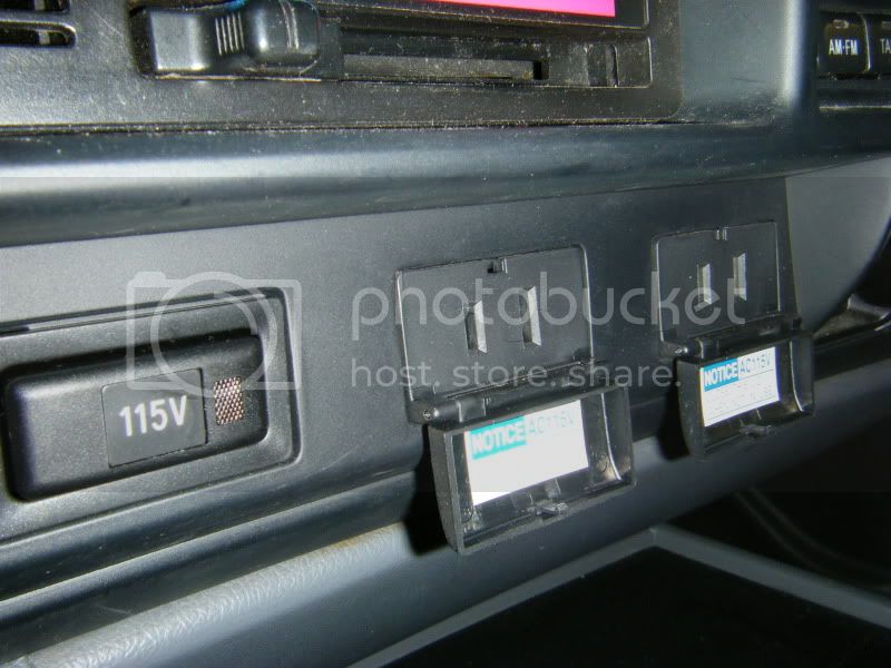

Switch and two outlets
Close up
Covers open showing recepticles
I did the install in a few steps spread out over a few weeks. Wiring is pretty straight forward even without the plugs for the back of the recepticles and power switch.
I'm pretty happy with the clean look of the install.

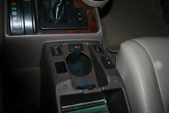

Cool, I am working a 110V project as well but I am using a custom cup holder Nakman was kind enough to make. It is similar to his other cup holders but with an extra front slot: Gamiviti - roof racks and cup holders
I know I had some other slots open on my console but I intend to use those for rock and rear light switches.

great idea.. just to be clear ..the inverter went where the rear heater is( by the cd changer under center arm rest)? i noticed that the outlets don't have 3 holes, missing grounding plug. do low wattage appliances not have a ground plug?
Three prong won't work, the receptacle is two prong.
