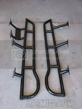

I grabbed these photos of a much more simple design from 'Mud. I can't remember who did these, but they're custom "garage-built" units. As you can see, it really isn't rocket science. The biggest obstacle is that stupid cat.
still dont look that hard to copy..... and make ... thats just me....
sched 80 is a bit overkill on it too... that will add alot of weight to your truck... i would go sched 40....

those sliders pics you posted look awesome. looks very similar to All Pro's with different mounting brackets of course. the legwork around that cat does look tricky. i bet even buying ap's without the mounting legs, and getting that done at a shop can still get you under total landed cost of hanna or slee's..
