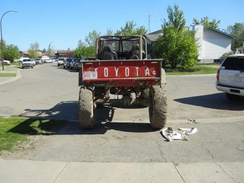

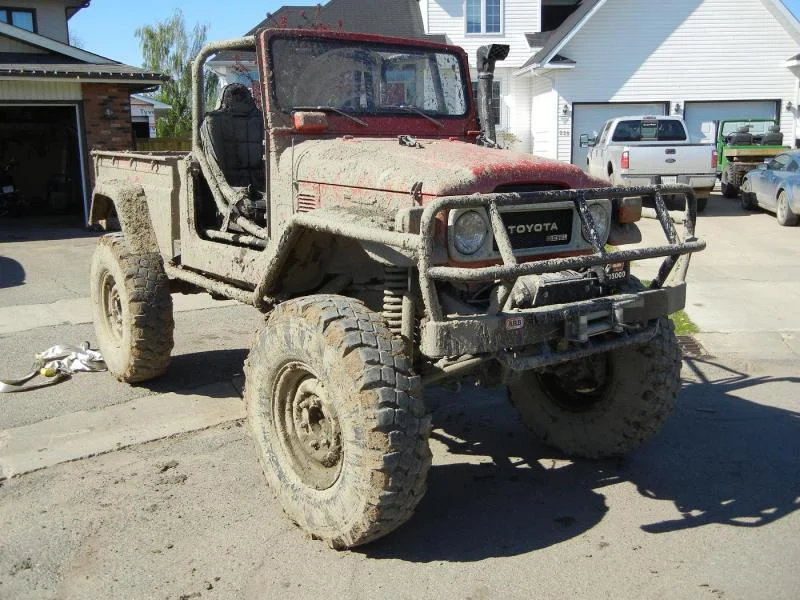

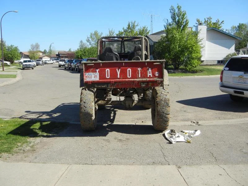

Finally got some seat time in the truck. I spent some time tightening all of the bolts on the chassis (links, steering, shocks) and it wanders a BIT less than before.
It was 25 deg (celcius) today and the truck sat at 210-215 all day. Lots of gear noise from the axles at higher speeds, especially when decellerating. Lot's of flying mud due to exposed tires. Only the outside of the tailgate was still clean when we were done.
Any action shots? :D
loud gear noise on decel usually point to bad backlash set on the gears or ring and pinion

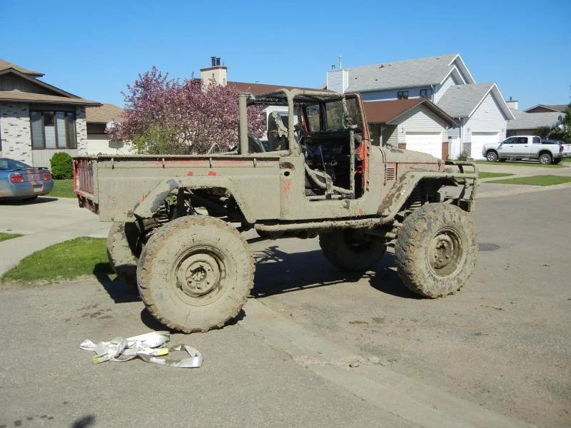

Finally got the truck cleaned out from the last go. Took the seats out and sprayed inside. The cage makes it tougher for sure
I put the hard top and soft doors on, hoping it would keep the interior a little cleaner
Then I decided to give it another go in the mud
Putting the roof and doors on was the stupidest decision I made. Shoulda just taken the windshield off. I couldn't see a thing and the inside got fricken dirty anyway

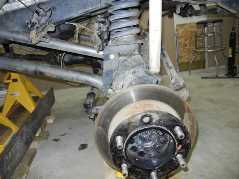

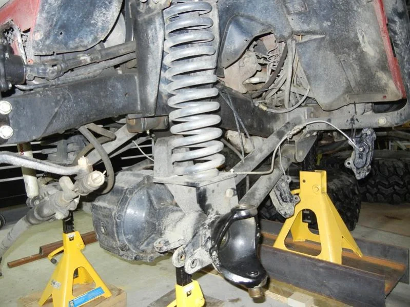

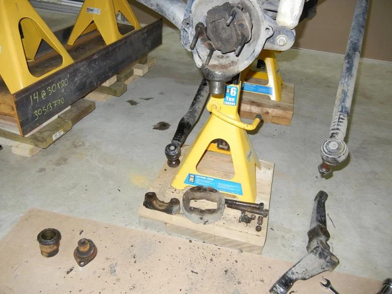

Pulled the tires off.

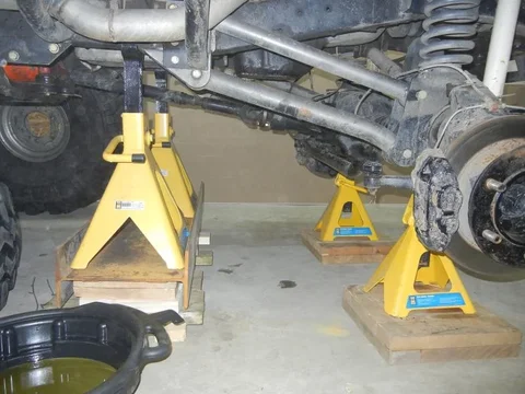

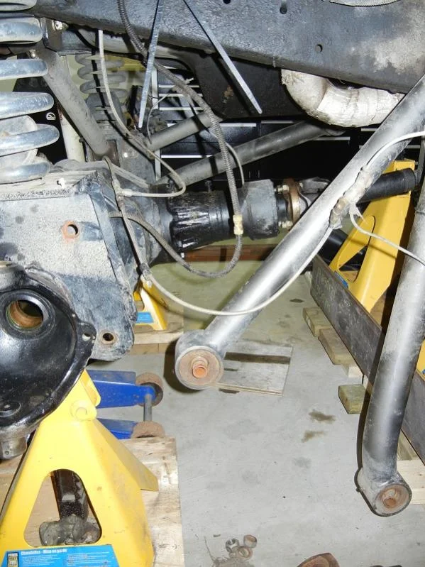

Supported the frame on some lumber and jack stands and the front axle is supported separately
Pulled the calipers off (2 bolts a piece) and tied them out of the way (haven't disconnected any brake lines)

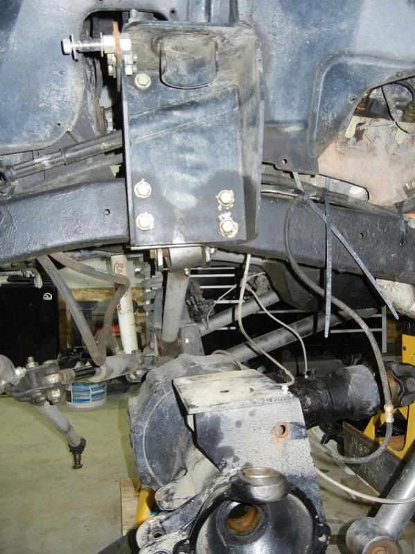

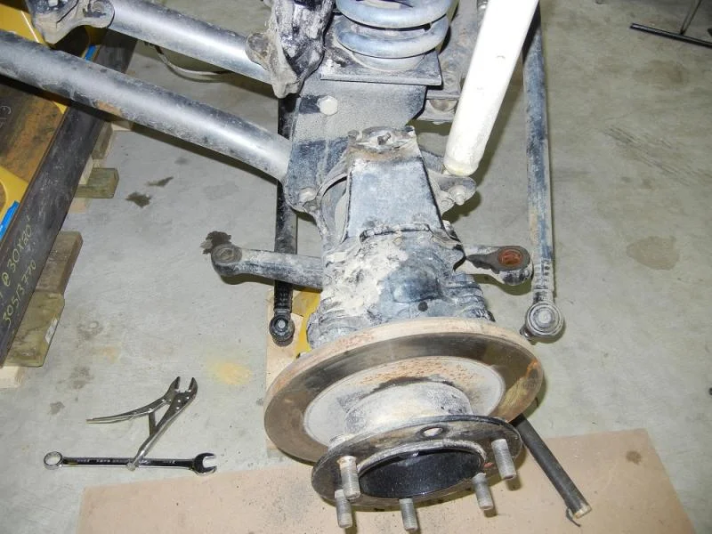

Disconnected the relay rod and tie rod

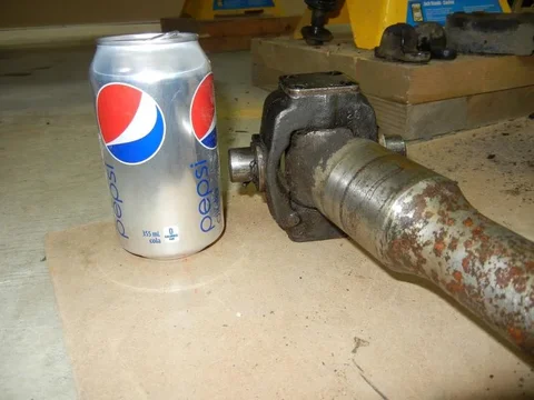

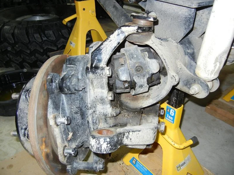

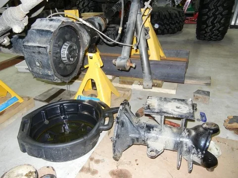

Split the drive joint so I could keep the weight down for the portal and not have to move it with the axle. Is just 4 bolts

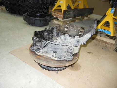

Pulled the portal off (pass. side). Here you can see it on the ground. I'll have to weigh it but it must be about 100lb (without the callipers, kingpin bushings and steering arm.
Here are the various parts. bushings on bottom left, steering arm, the axle still in the housing, and CV centre on the floor

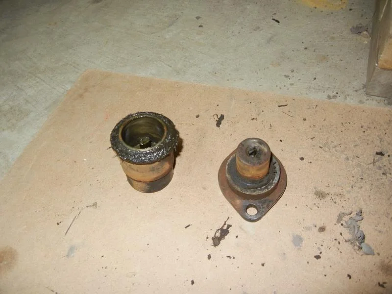

The kingpin bushings as they came out (bottom on left and top on right)
I cleaned up the bushings and checked the wear/fit on the portal. They fit nice and tight

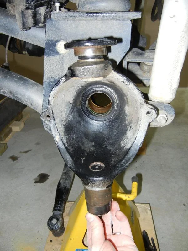

Checked the fit in the axle C. You can also see the axle bushing and housing seal. Both look pretty good. The seal has a metal outer gaurd that is bent but not bad. The bottom kingpin (in the C) has a very small amount of "wiggle" Think I'm going to leave it in there

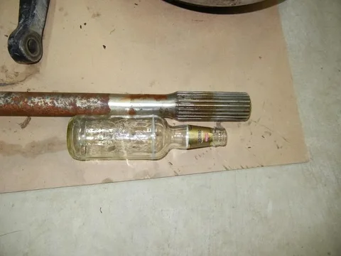

Here you can see the axle shaft size

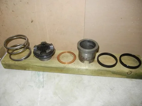

Here are all of the parts apart. The spring, dog teeth collar, thrust washer, sliding sleeve, and the 2 air o-rings
