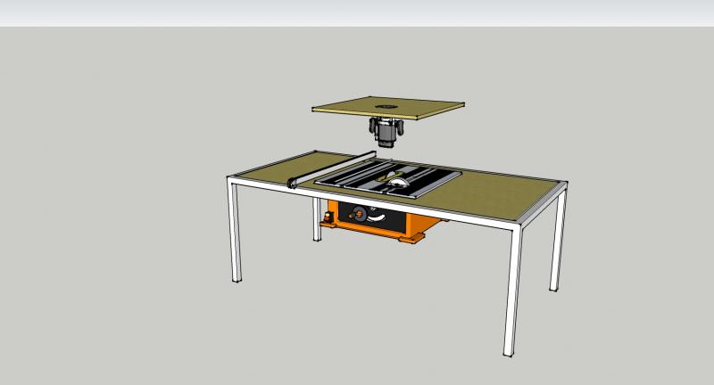

Anyone have a work table that converts to different uses?
I've been moving stuff into my new garage and trying to keep it organized. One thing I've found is that my table saw takes up way too much space for the amount of use it gets. I have a Delta Contractor's saw with both side extensions and a wide fence. It's excellent for use as a table saw, accurate, reliable, powerful, etc., but it's too big. So I was thinking portable table saw, but they just aren't good enough for making things like picture frames and higher precision cutting. And the tables are too small for me to rip plywood alone.
So my thought was to build a table that is something like 4x8 with a leaf of sorts that is removable. If it were 3x3' square I could make a set of blanks for different uses that drop in. Then I could use a portable table saw, a router, planer, drill press, belt sander. Basically you name it, it could be attached to a blank that fits the drop in area and have a nice large size table to work with. And being square it could go either direction for a wide feed in table or a long one. Probably have a good quality fence that can be used for any tool as well.
I just figured it would be more efficient use of my limited space to have one table for all the tools. And it would be a better table so each tool would be more useful. I figured it'd be on rollers and the frame underneath might have drawers or some sort that store all the tools for easy access and storage.
Here's a pic of what I'm thinking; Anyone ever built something like this? Thoughts on why it won't work or suggestions for making it most useful?

I went ahead and built a table like my first drawing. I make a handful of useful changes from my original though. First: it's only 3x8'. 4 feet deep was too wide to fit nicely with my other tools. It has two 3x3 foot square removable top panels and one 2x3' one. I don't have a table saw for it yet as I still need to sell my current saw before I'll buy another one to mount in the table.
I have used my router. I used the original router table top and removed all the legs and such, and mounted it up for a weekend project (plantation shutters). Worked great. An 8' runout table is great.
In the middle section I've put a secondary lower shelf on the inside you can't really see in the pics. It is 3.5" below the surface and when a board is in that slot it fits the standard height of a miter saw. So I can use either of my sliding miter saws and my planer in the middle and have nice table area on both sides.
Tools then store underneath.
I still have some work left to do.
First is mounting a table saw.
Second is figuring out a good way to get the panels to drop on to pegs that are conical and self center and align. I'm not sure at this point what hardware to use for that purpose.
Third is building a double fence system. I want to be able to use a fence going either axis. I haven't decided on what to do with this yet. My thought is 80/20 rail and brackets, but I could go with a bismeyer style fence as they are really easy to build in steel. It's not a top priority as I can just clamp on a piece of square tube for now.
Fourth is finding a good spot to permanently mount a dust collector and vacuum tubing.
I'll get some more, better, pics when I have it out next time. The snowplow is kinda in the way in the pic. - also what you can't see in the pictures is that there are cross braces at each joint in the top panels, splitting the distance, so each top panel rests on all 4 sides on something solid underneath. The shelf on the left will be where the table saw lives when not in use.
