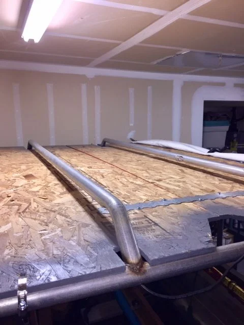

Are those bed bows a custom job?
Haha, she was fun inspiration for all
The bed bows were first made to carry the kayak
This trip they were the support for platform & possibly awnings next

Sure I'll post up a couple pics in the evening
The platform is simply plywood from Home Depot and I secured it with some ring clamps
I hashed it together in the two days before the Rubicon trip

Had to stop worrying about the wood splintering into fragments and JUST DRIVE......It actually held together just fine
Tube rack is welded to 2 strips of angled steel and 6 bolts on each side of the bed hold it secure. Two eye bolts on passenger side are also used to hold down my 5 Gal water jugs that sit in a steel cradle just inside the front of the bed. I've seen another 45 with a tubular frame that holds up a rooftop tent and it was fabbed and finished very nicely @Mudrak in Sonoma
