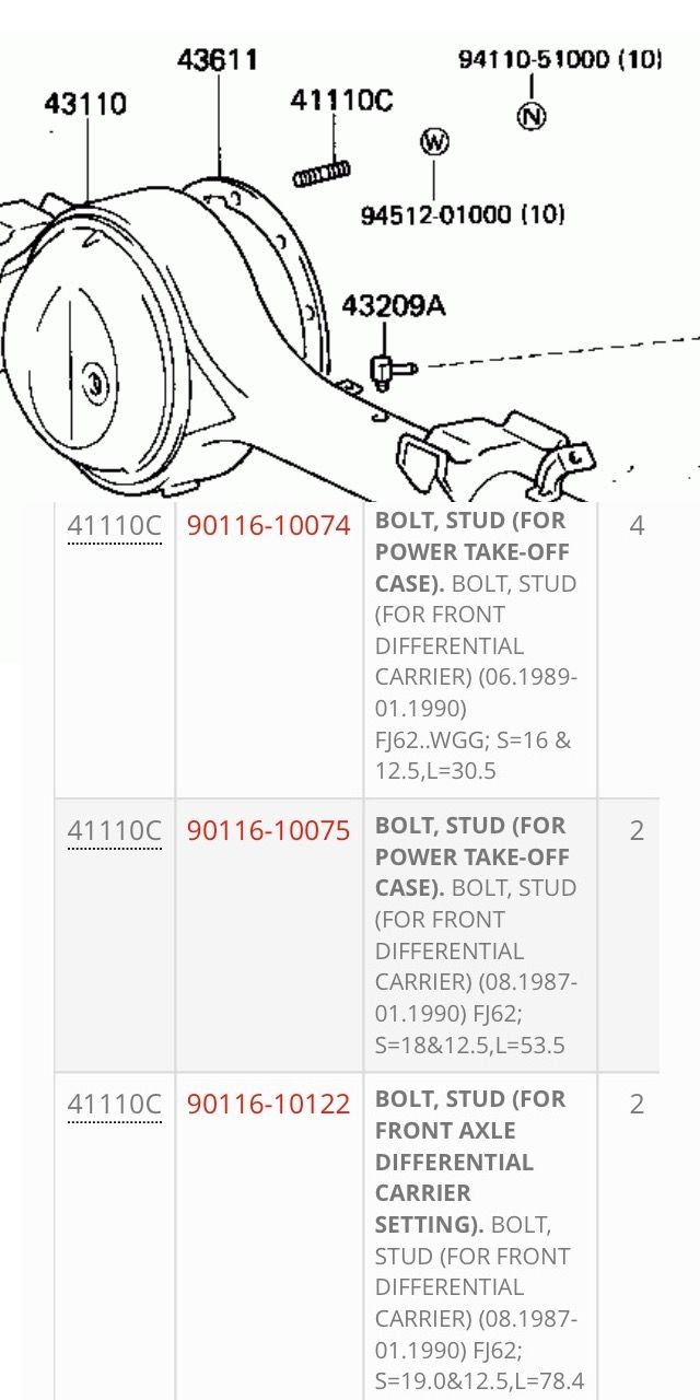

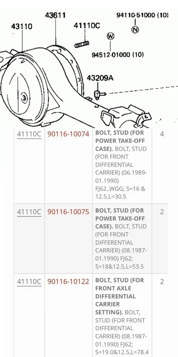

It's likely they are studs, and kinda hard to track down at a local ace hardware. If you can identify the actual location, we can get a better idea of where you need to source them.
Apparently there are 3 different stud sizes.

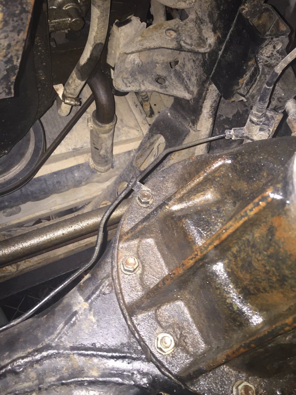

Here are the missing bolts. I hope the pictures are clear. I was trying to take the photo laying on my back while trying to sip my beer.
Those are nuts. ;)
Ask in the wanted section for some replacements..
