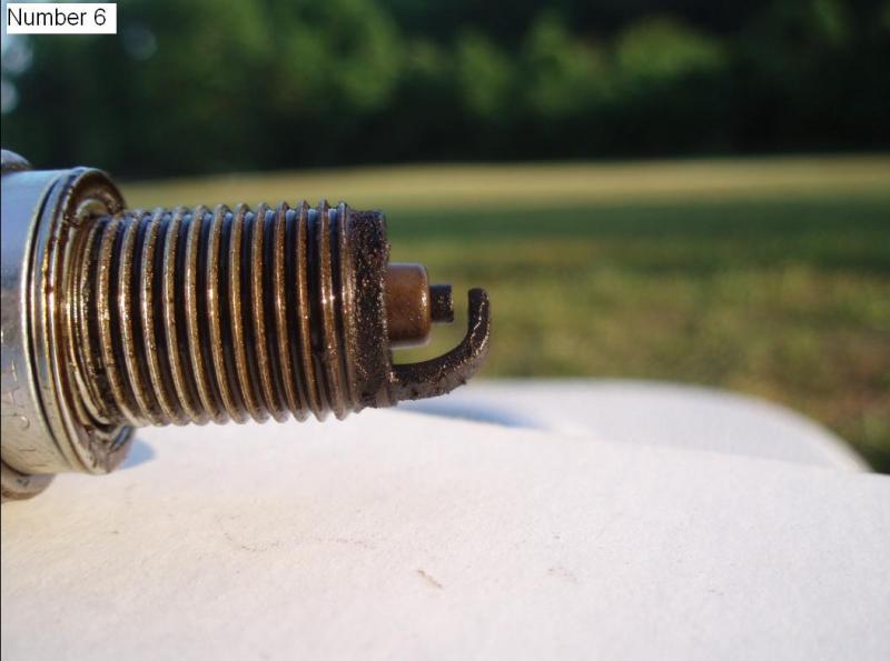

Pulled the plugs and they look good/the same with the exception of 4 and 6 (pictured below). These plugs probably have 6,000 miles on them.
The only thing out of the ordinary that I have done recently is to put a can of seafoam in the tank. That was right before it got really bad. Maybe it freed up some junk that is now clogging and injector or two.
Thoughts on these plugs? I am hoping that is not the "steam cleaned" look on the number 6 plug.

To me, the #6 only looks like it is not firing. It does not look at all like a steam cleaned plug. Also, it doesn't have black carbon oily goop all around the base of the electrode indicating oil leakage in the cylinder.

I didn't think the plug looked steam cleaned either, but it also didn't reak of fuel and it was a bit wet, which got me nervous.

Check the plug closely where the porcelain insulator meets the metal base. I had one with a nearly invisible hairline crack which was causing an intermittent misfire.
I will check the plug again, but this is not an intermittent misfire. It is a very noticeable very repetitive misfire. I will also swap a different plug to that cylinder.
