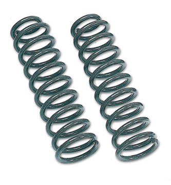

Simple, maybe a dumb question .. buddy here have a 22RE mini, and he wanna run 35" with a SAS ( yeah ! I recomend it :D ) already have the front live axle out from a Hi Lux ( you don't have that thing there .. ) 1997 ( the lastes non IFS model ) ..
But he wanna made it more comfy running coils at front ..
So I was searching in this section and found most of the SAS are made with spring packs ..
There is a recomendation about whcich coils we can use . ?
I thought from a TJ 4" over stock .. like
from ..
Coil Springs - Miscellaneous - Jeep 1997-2006 Wrangler TJ - Front 4" lift (over stock height) coil springs (pair)
Or found in the OME catalog the OME874 that measures 16" and have a 200lb/in spring rate .. ( from a RJ70 )
So .. I'm here to pay atention of all of your recomendations ..
thanks !

4 link yes + panhard for sure, don't need to be a radical flex, just compfortable. How much cost a coilover set . ?
Which Sprig Rate hould be ideal .. ?
Note, the SAS it's based on a 90 22RE mini truc .. using a 97 hi lux front axle .. front bumper ( nothing extreme ) and winch ..

220 inch/pounds sounds pretty close to the OME numbers ( 200 ) and maybe would be a good deal .. ( are not cheap anycase but are rated for a 70 series with the same engine ).
Knixen .. which engine and coil are running your friend .. ?
Unluck I already found a front axles that come from a spring pack hi lux .. but I have no fear making the arms and links .. no big deal, lot's of work ..
Thanks for all comments guys ..
One more question .. does anyone know the springrate from a TJ coils for example a skyjacker coils .?
he now runs a 4,3 chevy v6... coils I don`t know... I think ome...
OME 874 maybe .. ?
Thought the 4.3 it's much more heavy than the 22RE .. but would be good to know which are those coils ..
