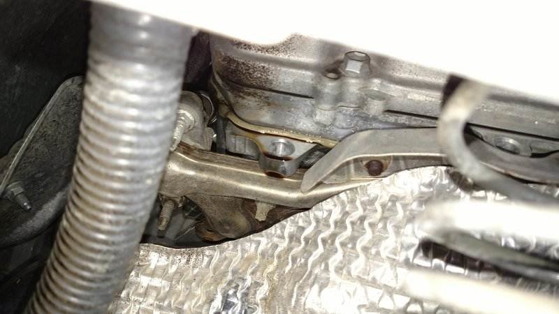

Don't forget head cover gasket leaks. *grumble*grumble* It's likely due to poor assembly or not understanding where additional sealing is required but it's too early to know for sure.
Do you mean the cam tower leak? I'm not aware of any head gasket problems
I had the cam tower leak at 68,000 miles.
@Narkhelek - ah ok despite what Toyota called it, I'd call this the valve cover gasket (which is what it was called on my 20R!). head cover gasket sounds too much like head gasket...

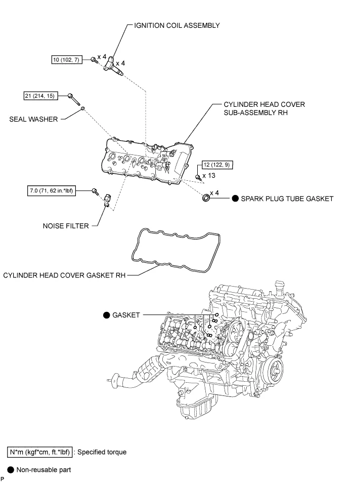

So using your diagram, it isn't the cylinder head cover gasket (#5) between the cylinder head cover (#4) and the camshaft housing (#15) that has been leaking? Is there another gasket between the camshaft housing (#15) and the cylinder head (#2) that is the culprit?
