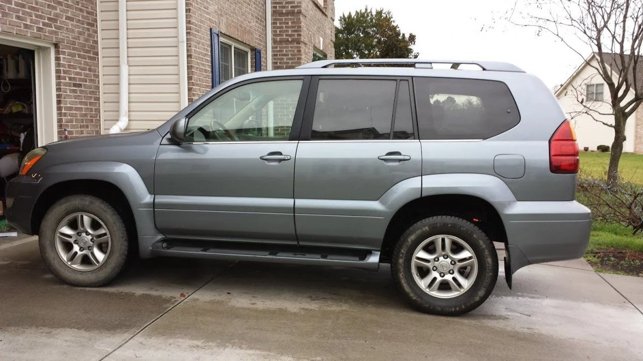

I've replaced the rear air springs with regular springs. Also removed and then replaced the running boards (was not wife or daughter approved).

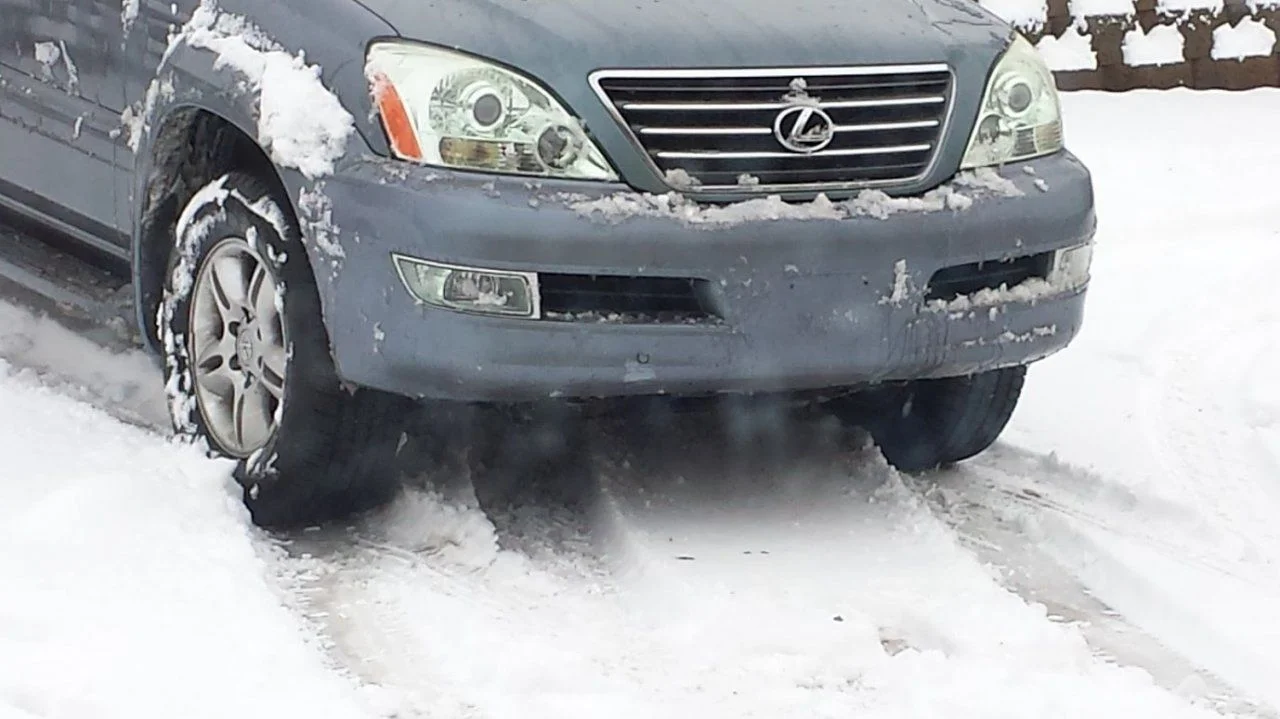

First, my accident. I drove to work in the snow last year and was so impressed with how it handled that I came in the parking lot a little too hot and gently slid into the building. Only damage was the outside faucet that punched the bumper, which also then broke as I backed up. Luckily there was a giant rock outside that my tire hit right before I really hit the wall. Ouch.

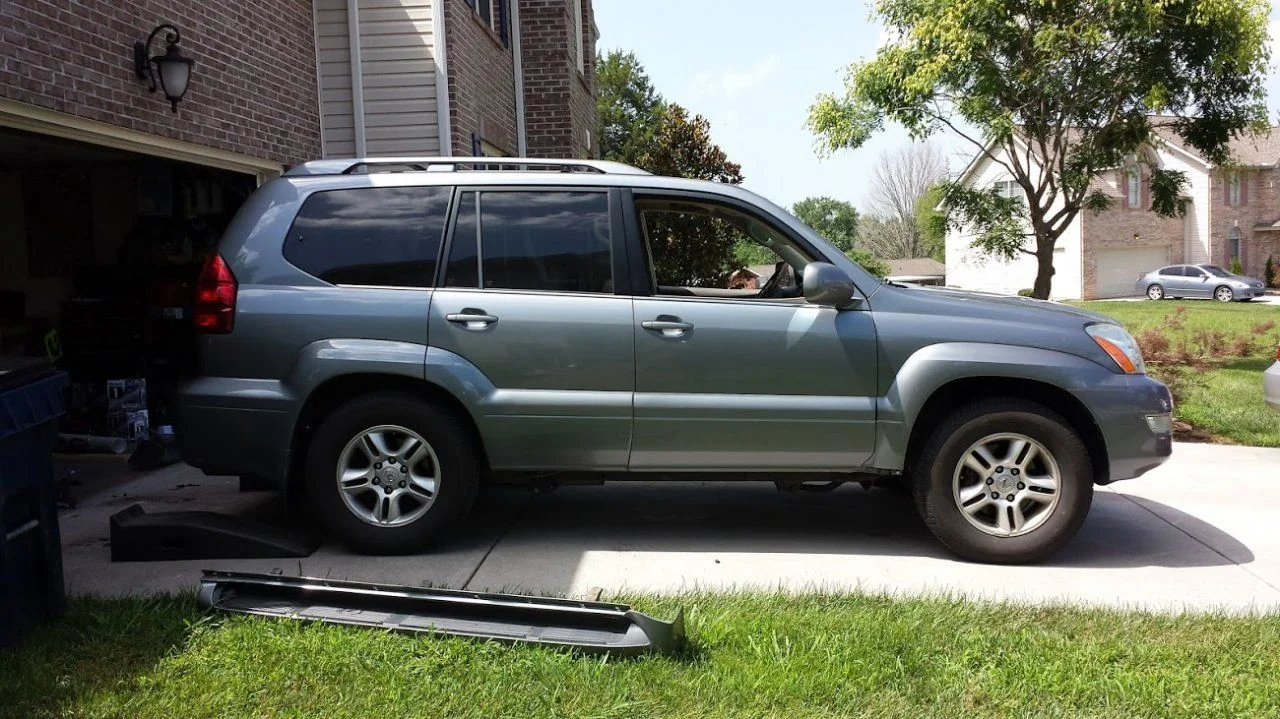

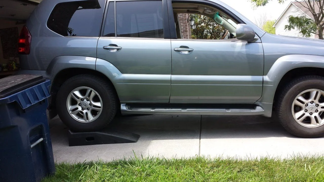

Once it warmed up, I decided to remove the running boards.
On
Off
As I mentioned, neither the wife nor the daughter was thrilled about this, so they went back on a few weeks later.

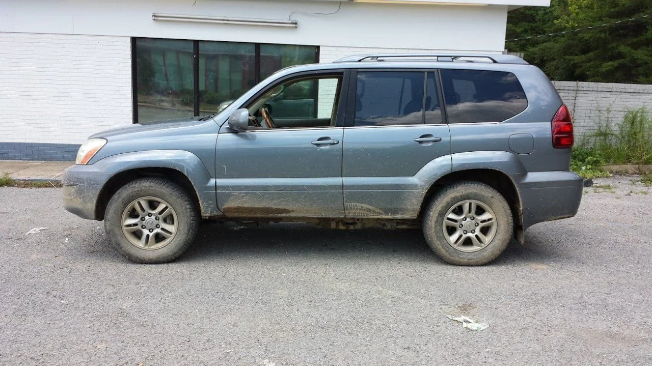

While the boards were off, I did make a quick run up to the North Cumberland OHV, but didn't venture too far into anything.

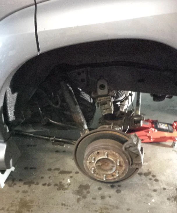

Then came goodbye to our Camry with 176k miles and hello to FJ Cruiser springs, Metaltech conversion kit, and some parts from @beno and I was all set for the spring conversion.
Here we go!
All done, rides so much better now.
Good to have you on the forums!
Oh I wanted to add. When I did the rear spring conversion, I sat there longer than I would like to admit trying to get the airlines to release by pushing something between the frame from the outside. Eventually I dropped the spare, crawled underneath, and was easily able to remove the clips holding on the air lines. So protip, drop the spare, which was not mentioned in the instructions I found.

I thought you might get a small bump in height from the FJ springs - guess I was wrong.
You know, I am a little bit kicking myself for not measuring before and after to see. My airbags would deflate every time I parked so I don't know if I could get a stock measurement anyways. I might have gained 0.5" but thats it.
