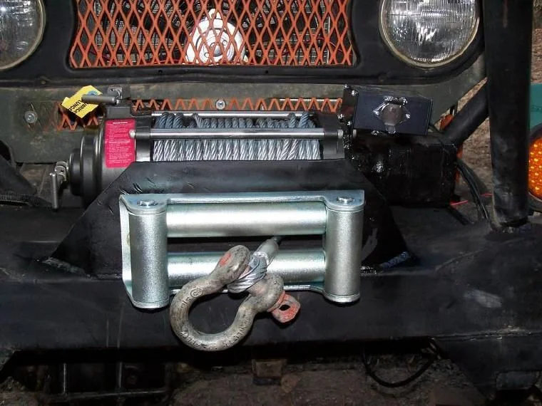

Here's some pics of my install. I need to clean up the wiring to the remote.
