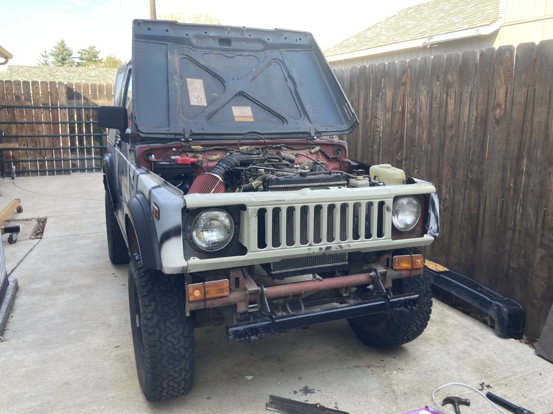

Long time ago I had bought this SJ410 grille, and stashed it. Started trying to fit it up this afternoon. Proving to be a major chore so far

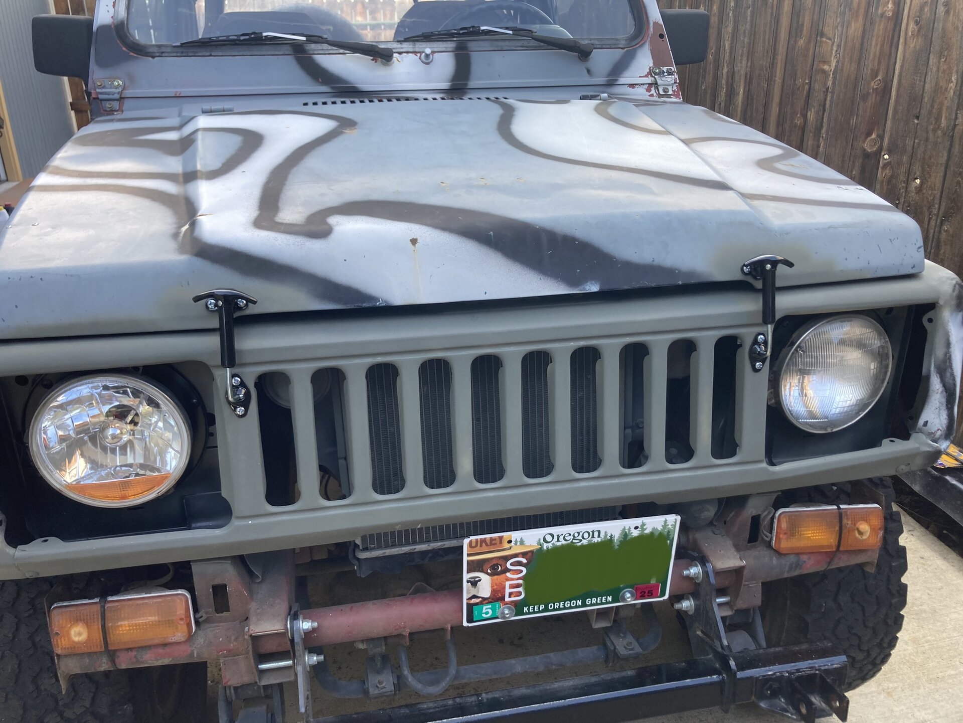

got the grille mounted up. It is different enough that the stock hood release mechanism wouldn’t fit right (too close to the radiator) so I eliminated that setup and installed some jeep style hood latches.
Also test fitted an H4 headlight housing I had laying around. May use them for an LED conversion and use the bottom portion for a marker light.

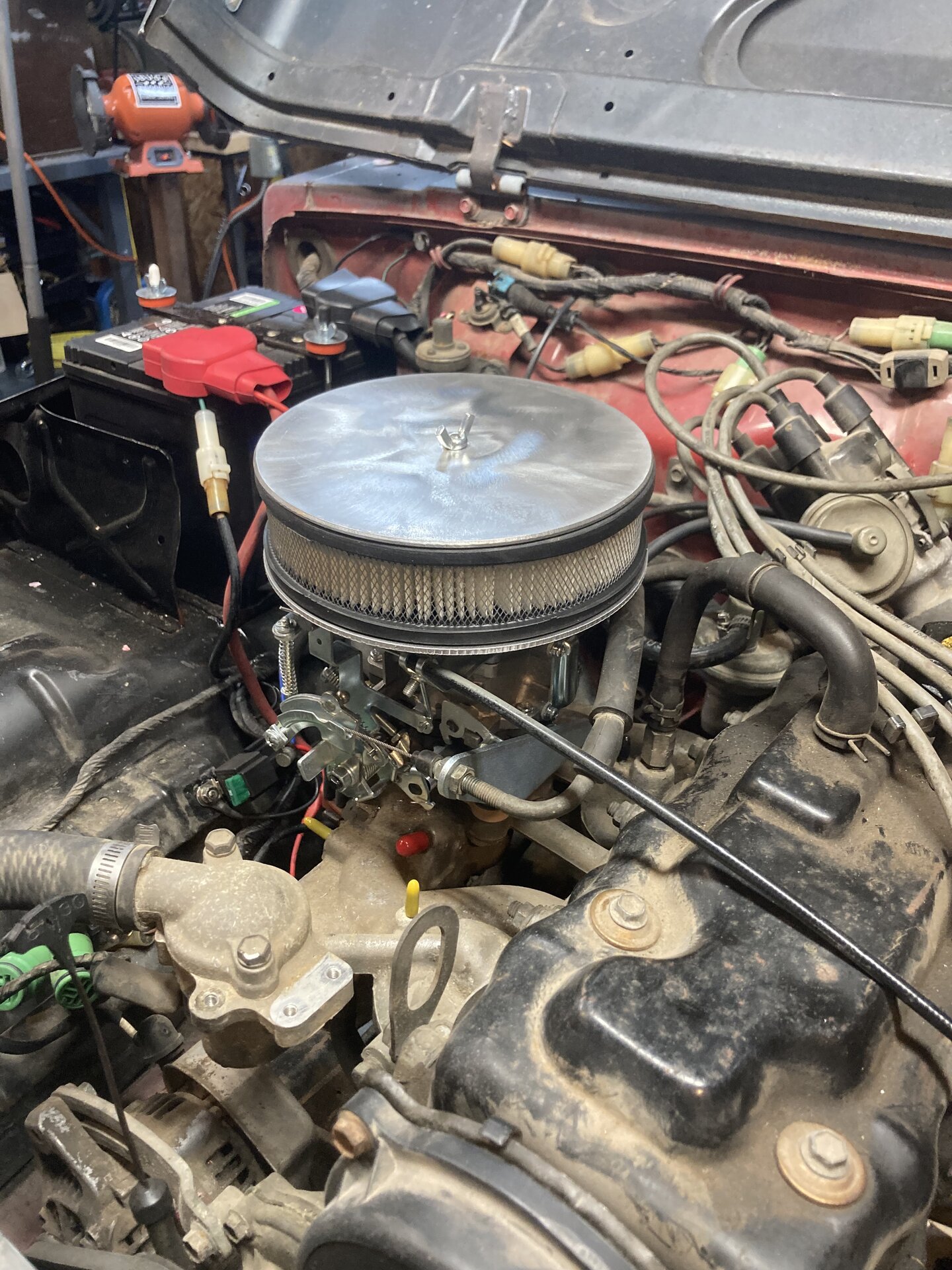

Installed a new Chinese Toyota 3k carburetor clone with a kit from Certified Machine in OKC
Good kit, good customer service too

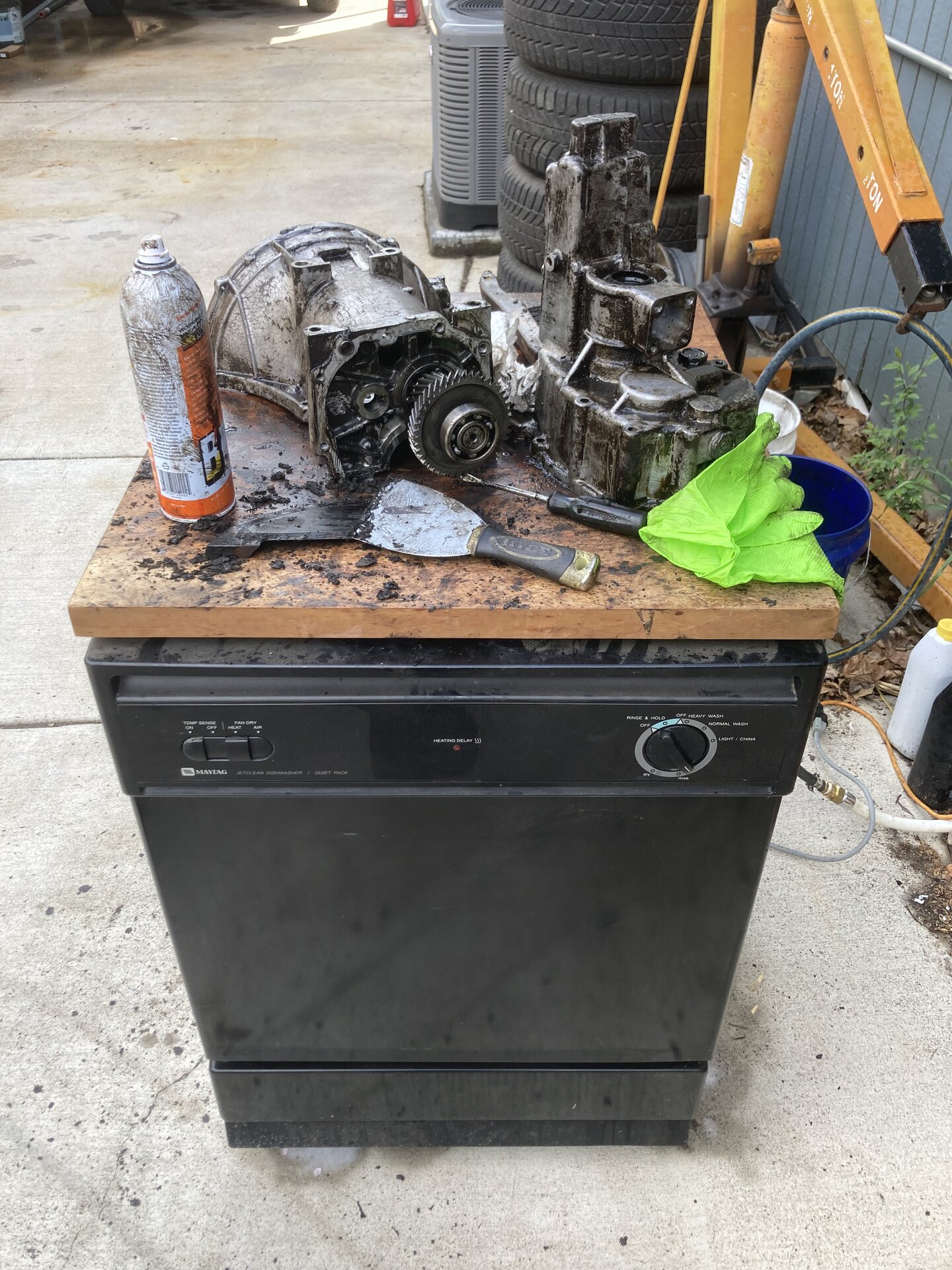

Got the shifters all tightened up, engine running great and took it for a test drive…..only to discover some horrible noises coming from the transmission.
Pulled the tcase and trans and discovered some wasted bearings in the trans. Thankfully the gears and synchros look good.
Started cleaning the trans in the old dishwasher and ordered a bearing kit

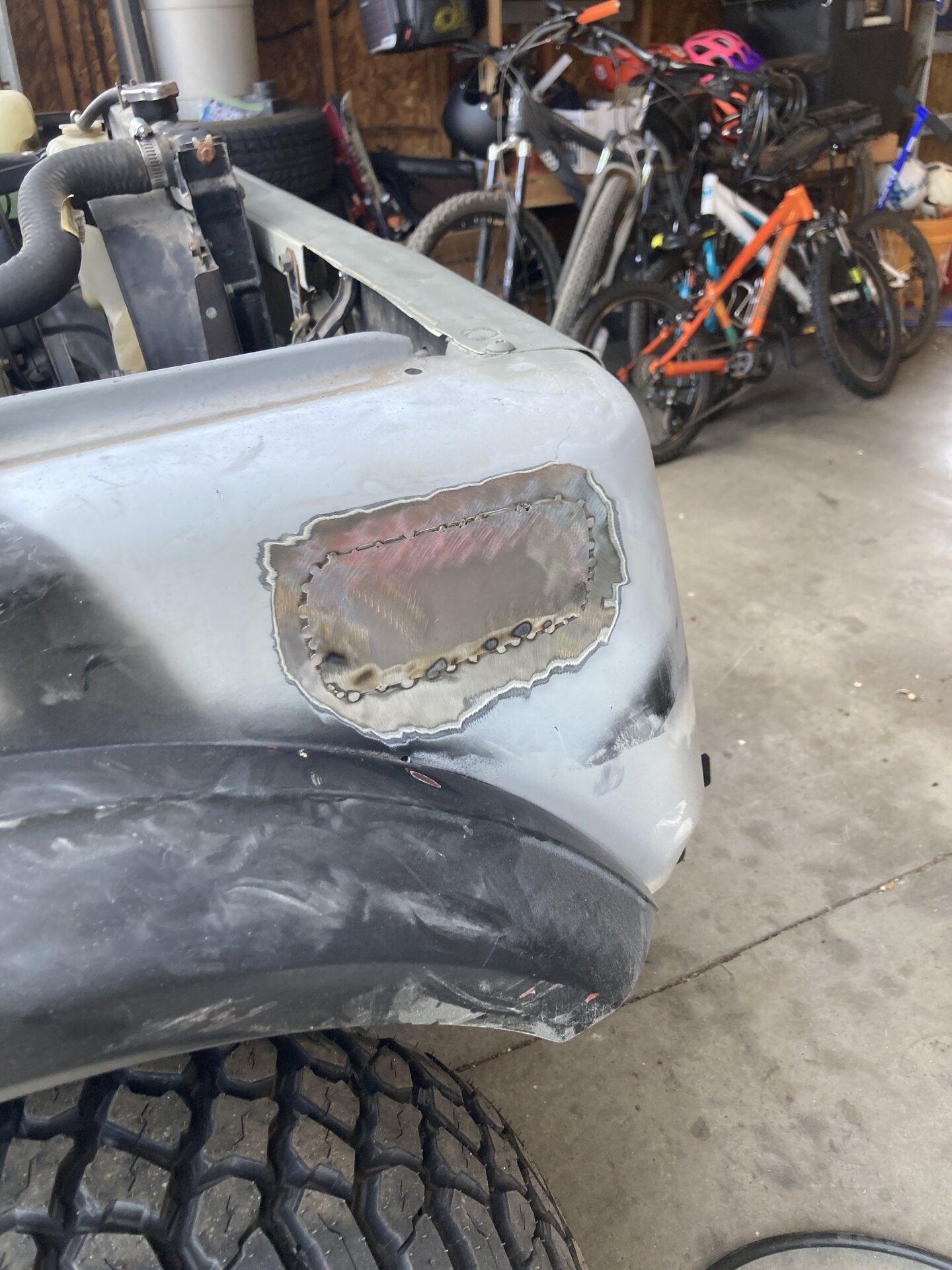

Trying to make the intermittently functioning front marker lights work today snow balled into welding in filler panels and fitting 2” trailer LED marker lights.

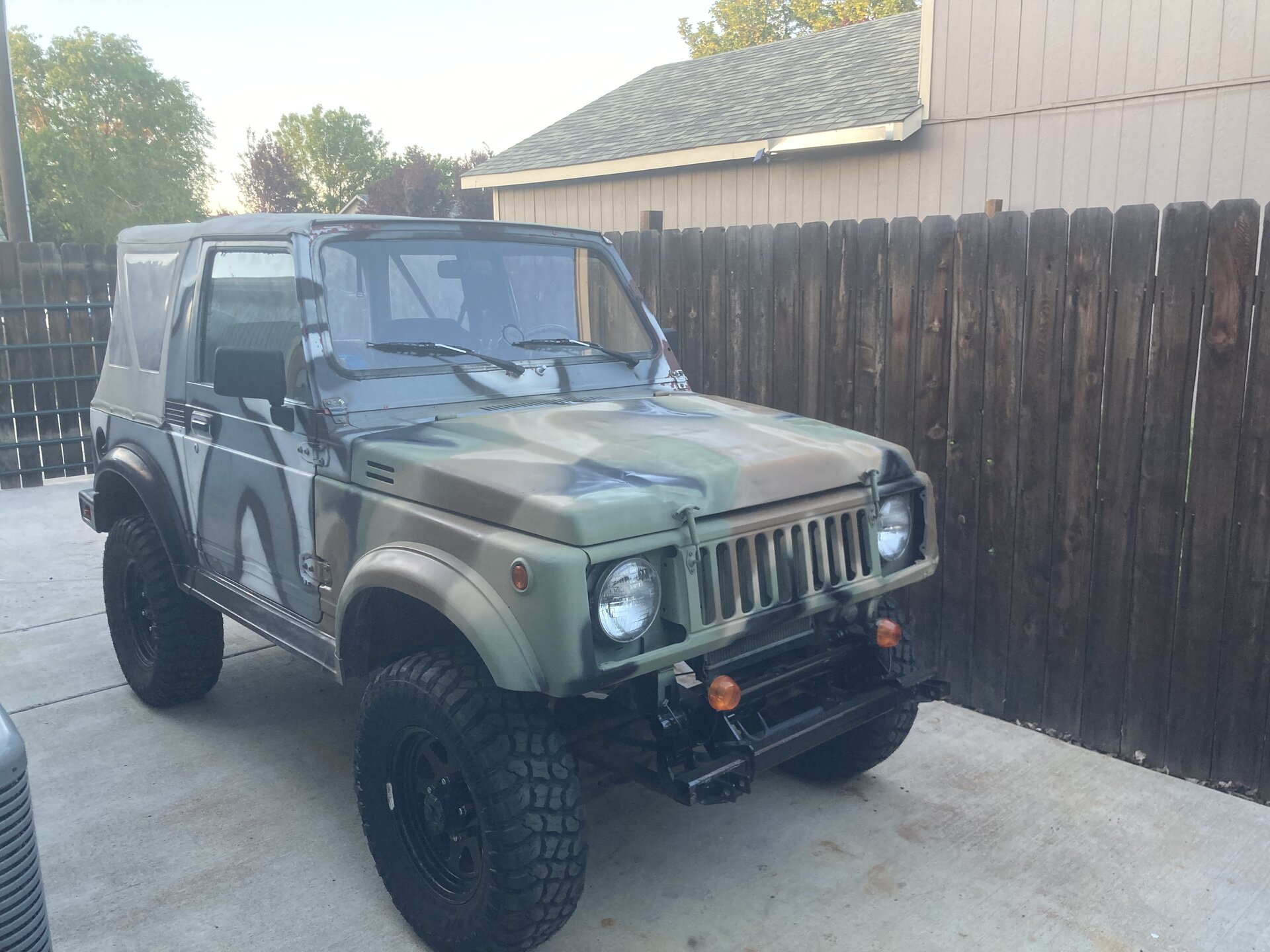

Started working on body/paint but quickly realized this Sammy needs more filler, dent repair, etc than I am willing to do. Nothing uglier than a shiny paint job on imperfect metal. So I decided to re-camo it using the old MERDC scheme as a guide. I’ll get more pics later but i did snap these
