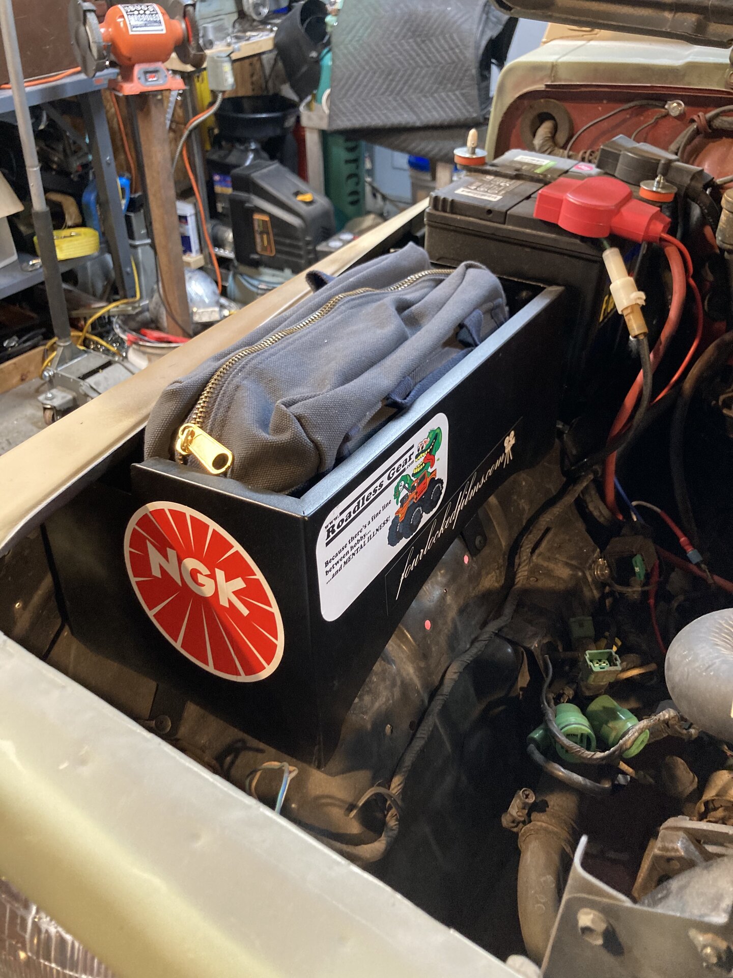

And finally under hood storage cubby from Roadless Gear

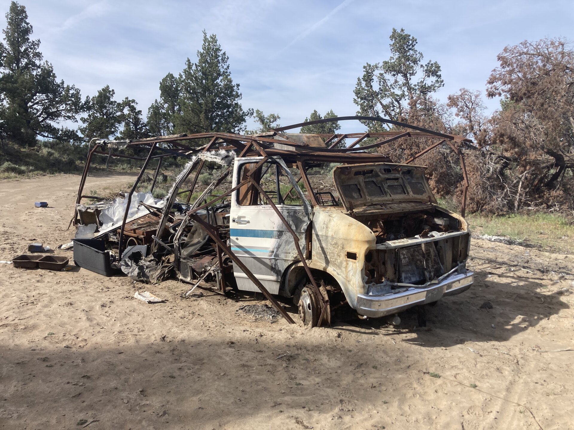

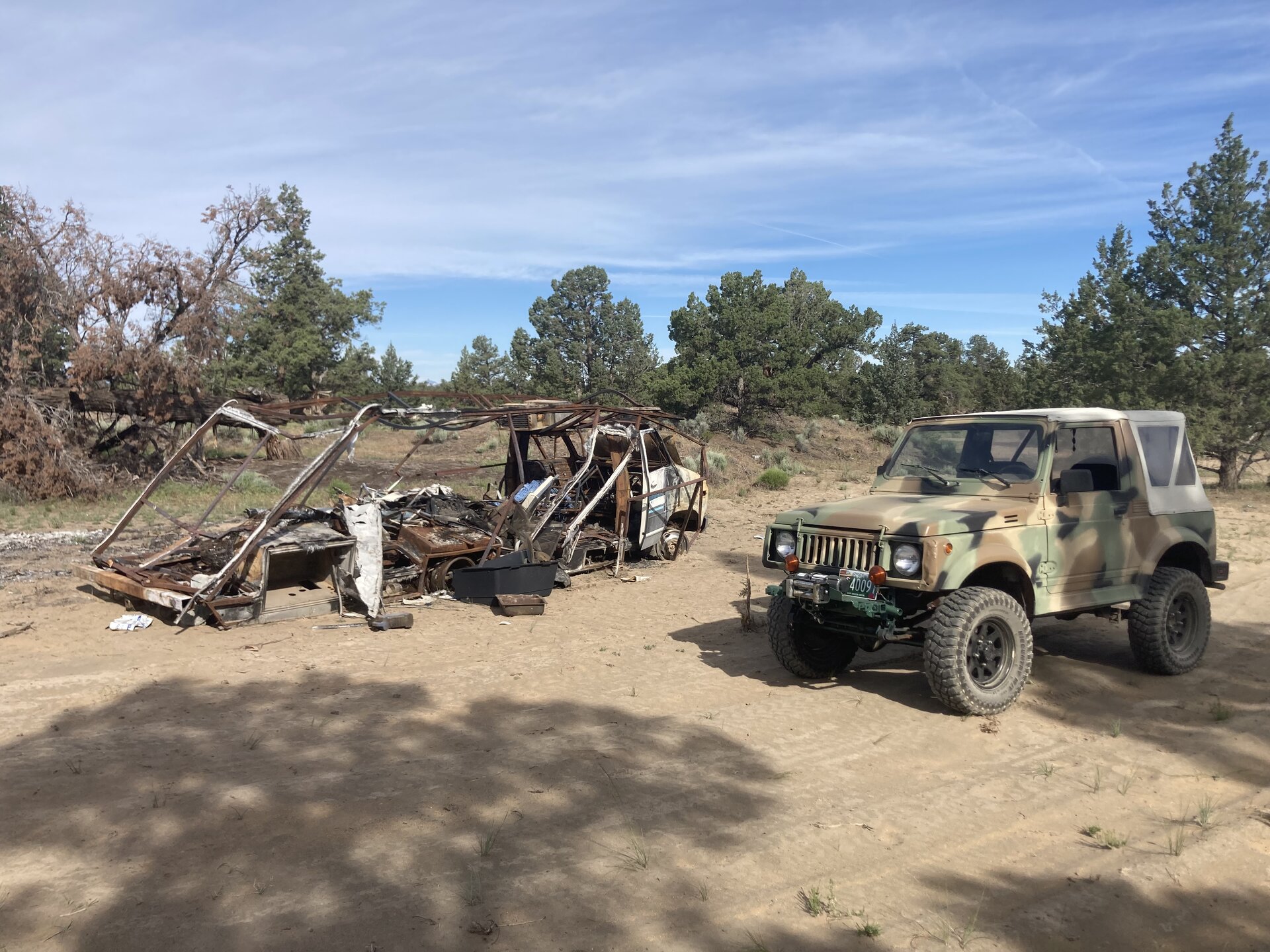

‘nother little drive around BLM today. Paid homage to the wise old burned RV of the desert. 😂

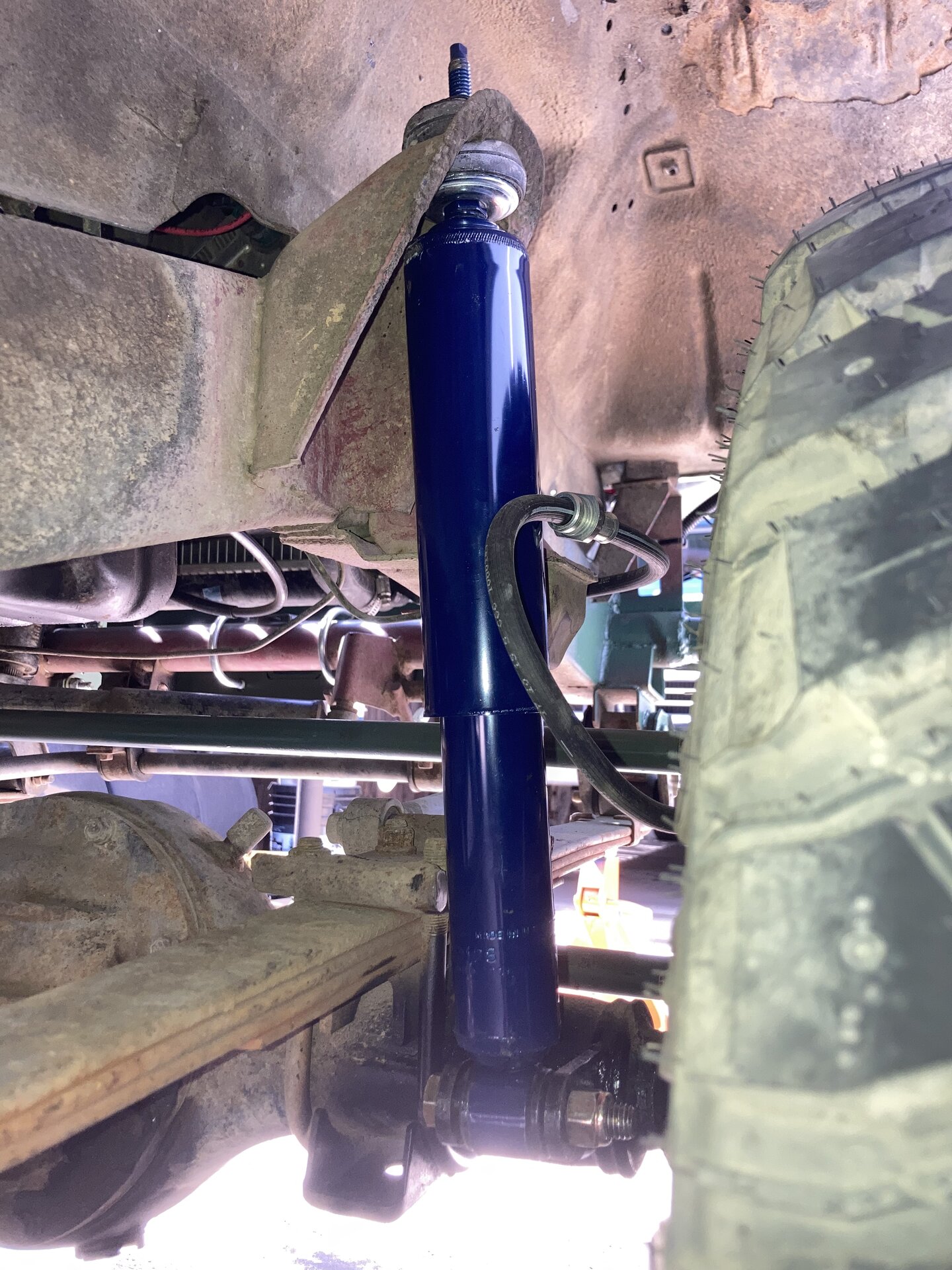

welded in new front lower shock mounts so I could use longer shocks that won’t bottom out. Cheapie blue-bodied Monroe shocks for a Crown Victoria (God rest the Queen)

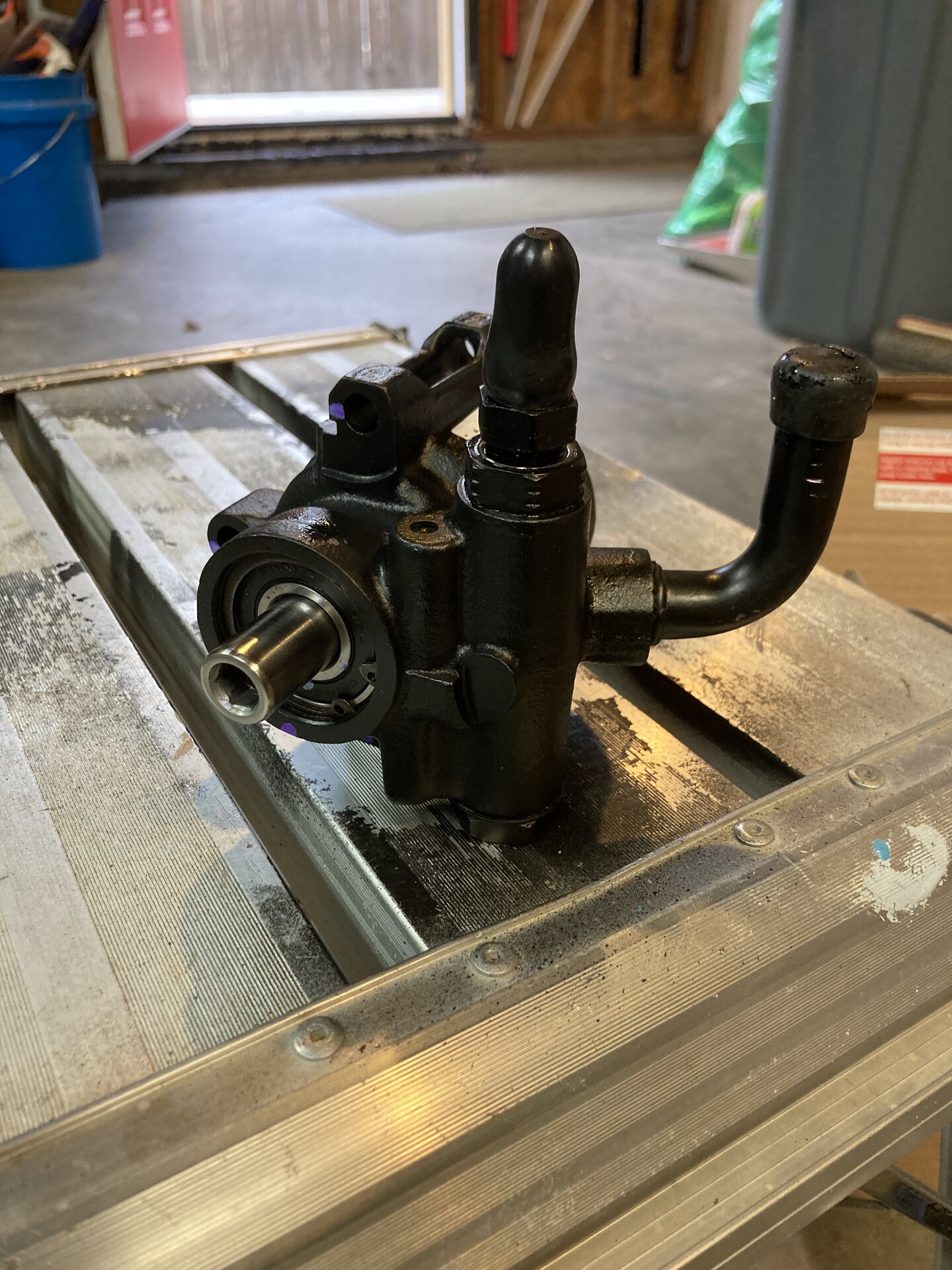

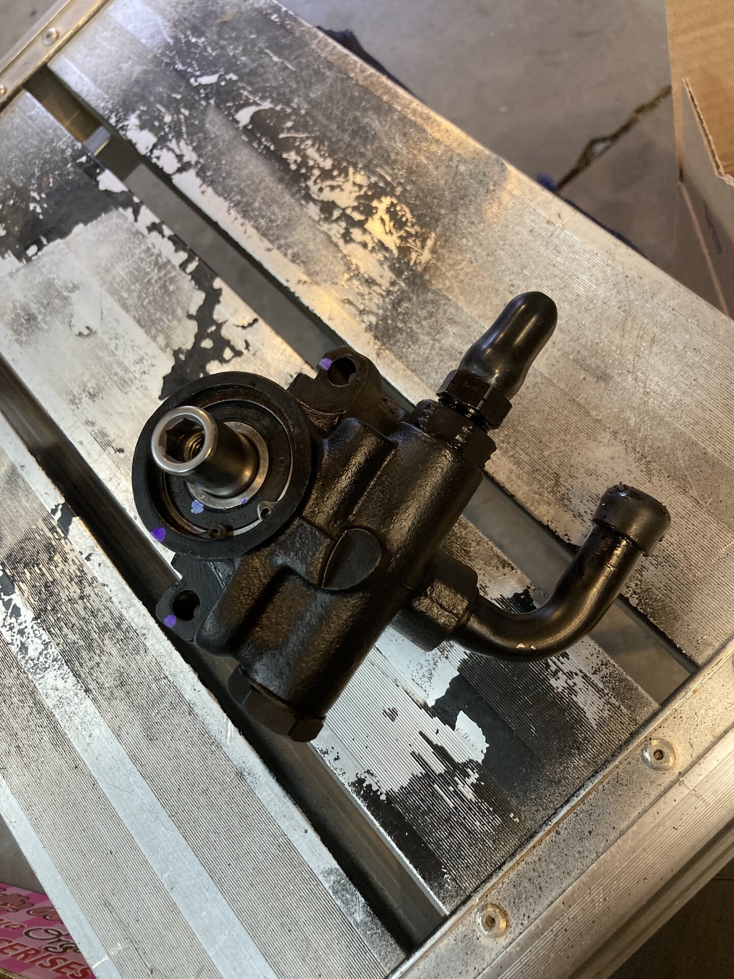

Also received the first piece of the future power steering puzzle, TC power steering pump. Cardone 20-813 was the cheapest option, about $40 on Amazon at the time I bought it. I was able to rotate the outlet pipe upward with the use of some heat, and already had the M16-1.5 O-ring to AN -6 adapter in my parts pile to thread into it.
Thanks to the old pirate4x4 threads I was able to dig up for that PN

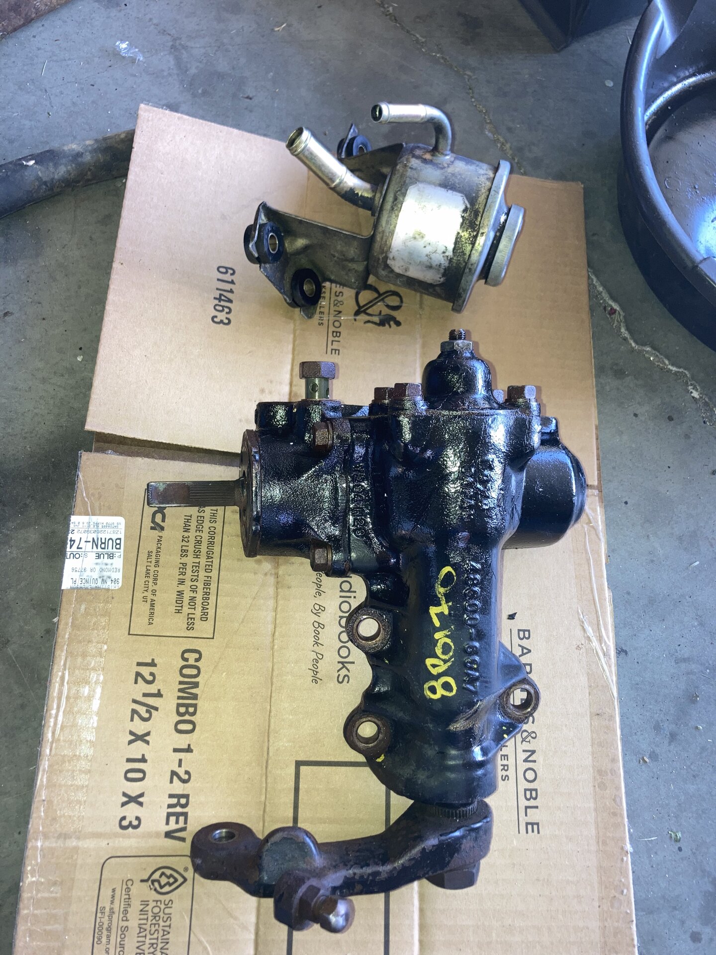

I also have a 80’s Toyota truck reservoir coming in the mail along with a Geo tracker box. Bit of a hodgepodge…..

Geo tracker steering box showed up 😁
Fittings look to be 14mm pressure, and 15mm return (weird). Had to order the AN adapters from LowRange

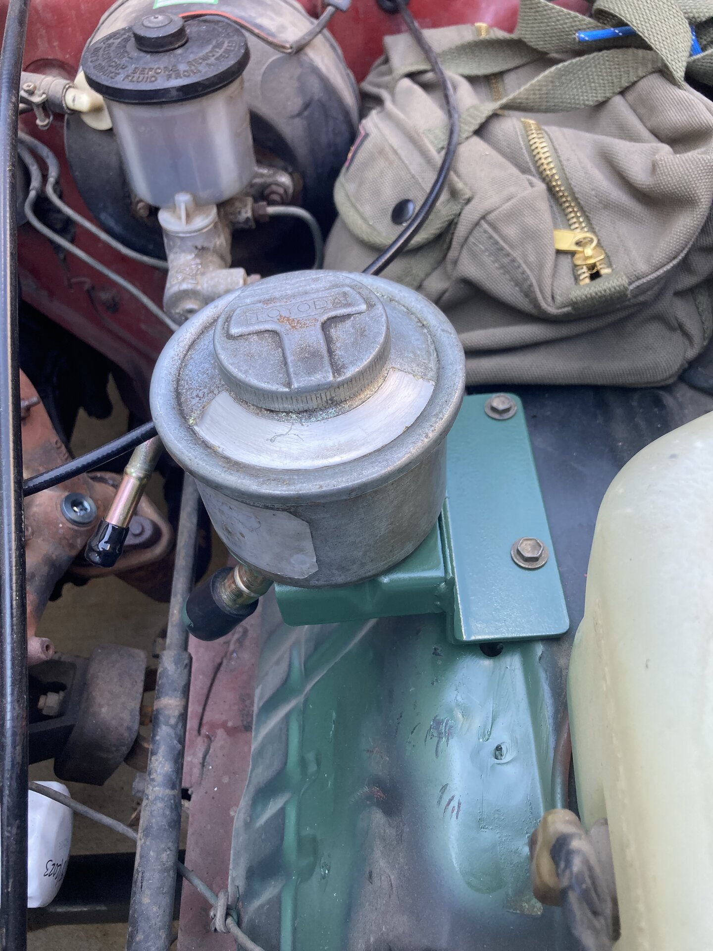

Also found a Toyota pickup reservoir to use with it all.

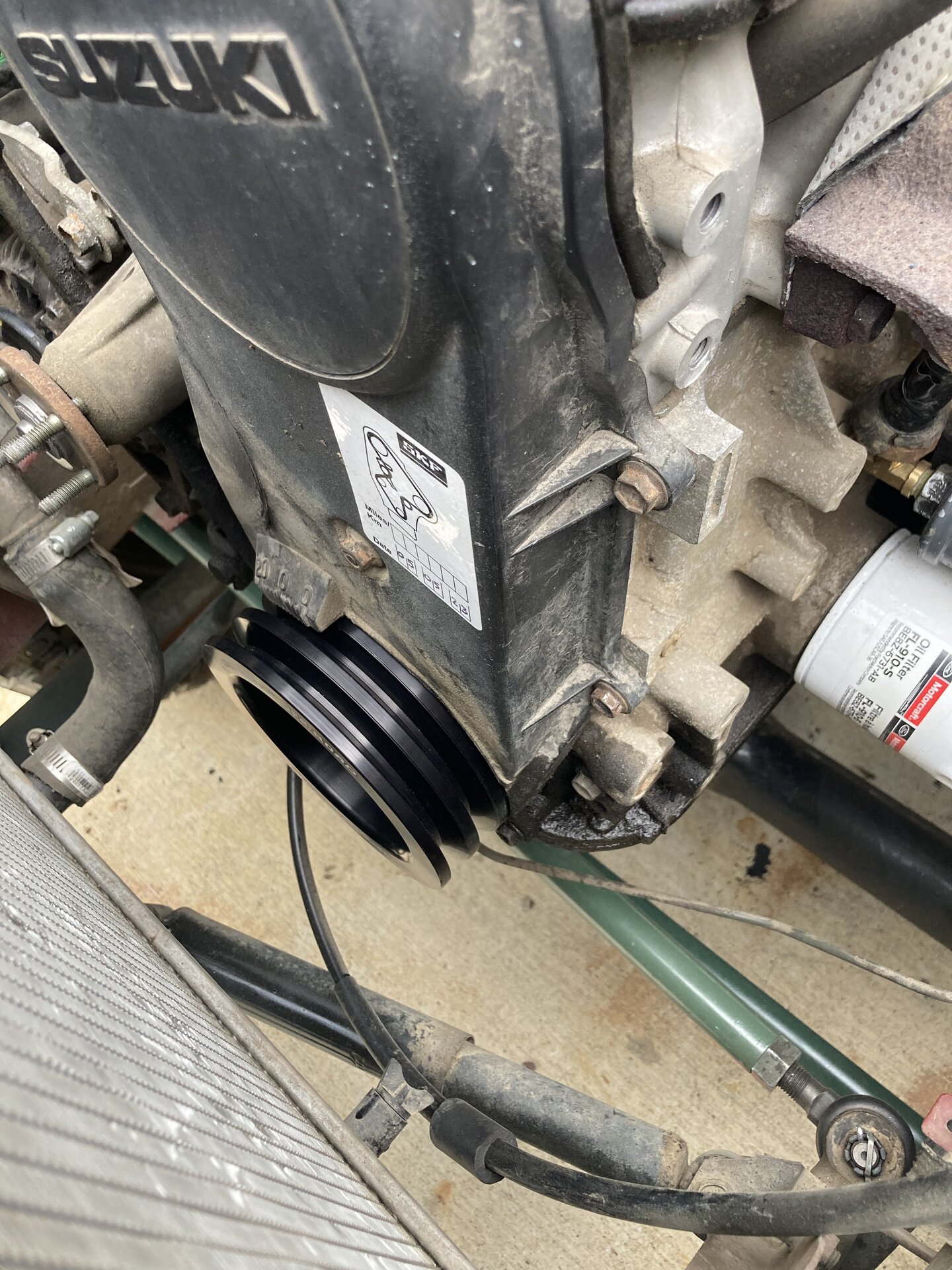

Speaking of LowRange, they were having a pretty good Fathers Day sale last week and I ordered 4.16 transfer case gears, a double row crank pulley and a wedge mount for the PS box.

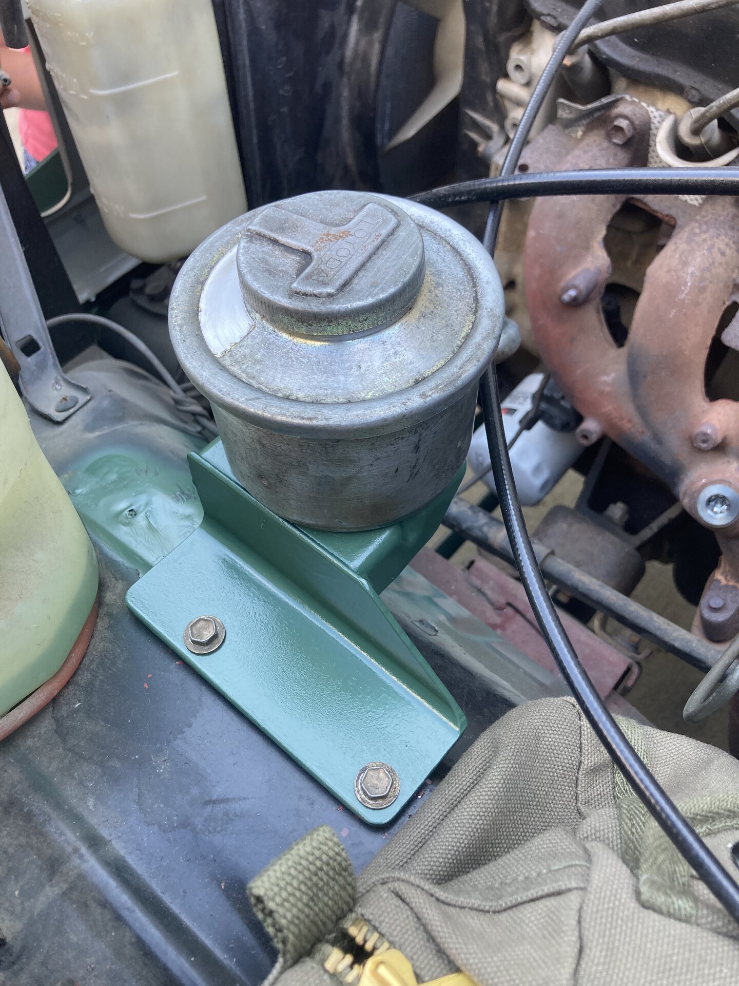

Got a little bored and decided to rework the ps reservoir mount with some angle iron and green paint. Mounts to some existing threaded holes on the inner fender. Had to remove the factory scissor jack holder
Received the AN adapters from Low Range today, the return looks like it might actually be 16mm-1.5 but my other adapter wouldn’t thread into it for some reason….
But both of these fit and I also got a AN to 3/8” hose barb for the return. Test fit the Low Range wedge bracket too
I think all I need now to round out the PS swap is a pump pulley, cooler and some pressure line. And fabricate a mounting bracket for the pump to block.
