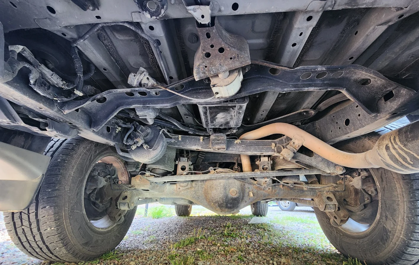

All of them are air-ride OEM and rated at 6,500# with the proper hitch (which you purchased). Air bags are IMO superior to coils for towing - I deleted my bags before getting a camper (as they were leaking), and have no added aux bags inside the coils. In hindsight I would have considered extended-length aftermarket bags meant for lifted GXs.
One thing I forgot to mention is that there should be a metal bracket on the rear cross member that connects down to the center of the OEM hitch (08925-35870). My GX had it from the factory, despite (to my knowledge) never having a OEM 6,500# hitch on it. It might just be some of the early GX models that didn't have it. Here is an old thread with some photos of how it goes together. I'd look up under your bumper and see if the bracket is there.
Very helpful, thanks. Im going to check out that thread and ive finally got time today to crawl under the lexus to check for that adapter
Well just as the panic set in because that part may be discontinued. I went outside popped the cover and was relieved to see I think I've got what I need and this rig should be all setup and ready to receive the OEM hitch

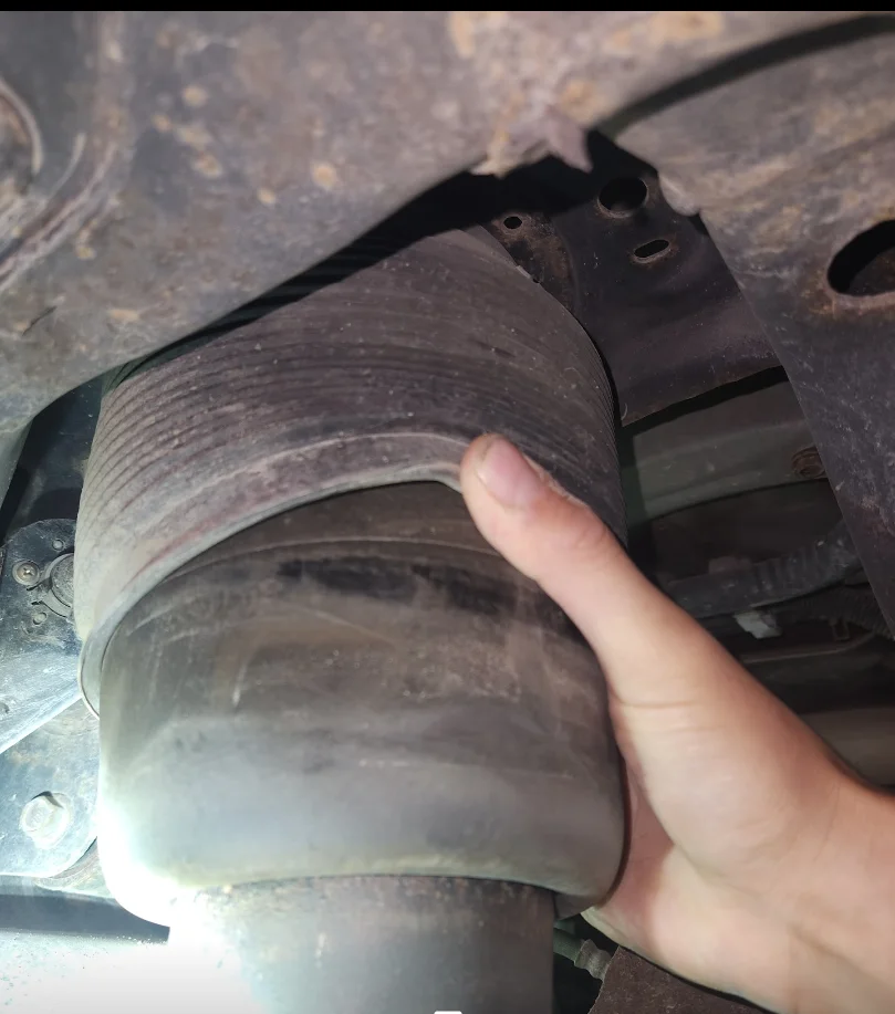

  • Remove rear bumper, clean up any rusty crusty areas
  • Drop spare tire , consider replacing if original
  • Inspect airbags on high for any cracks

That's the right bracket. Your bags look good as well, although my opinion is online-only :). You could always buy a spare aftermarket bag or two and throw them in the camper, so you aren't totally screwed if one craps out on you in a remote area. Looks like aftermarket replacements are around $100 per side.

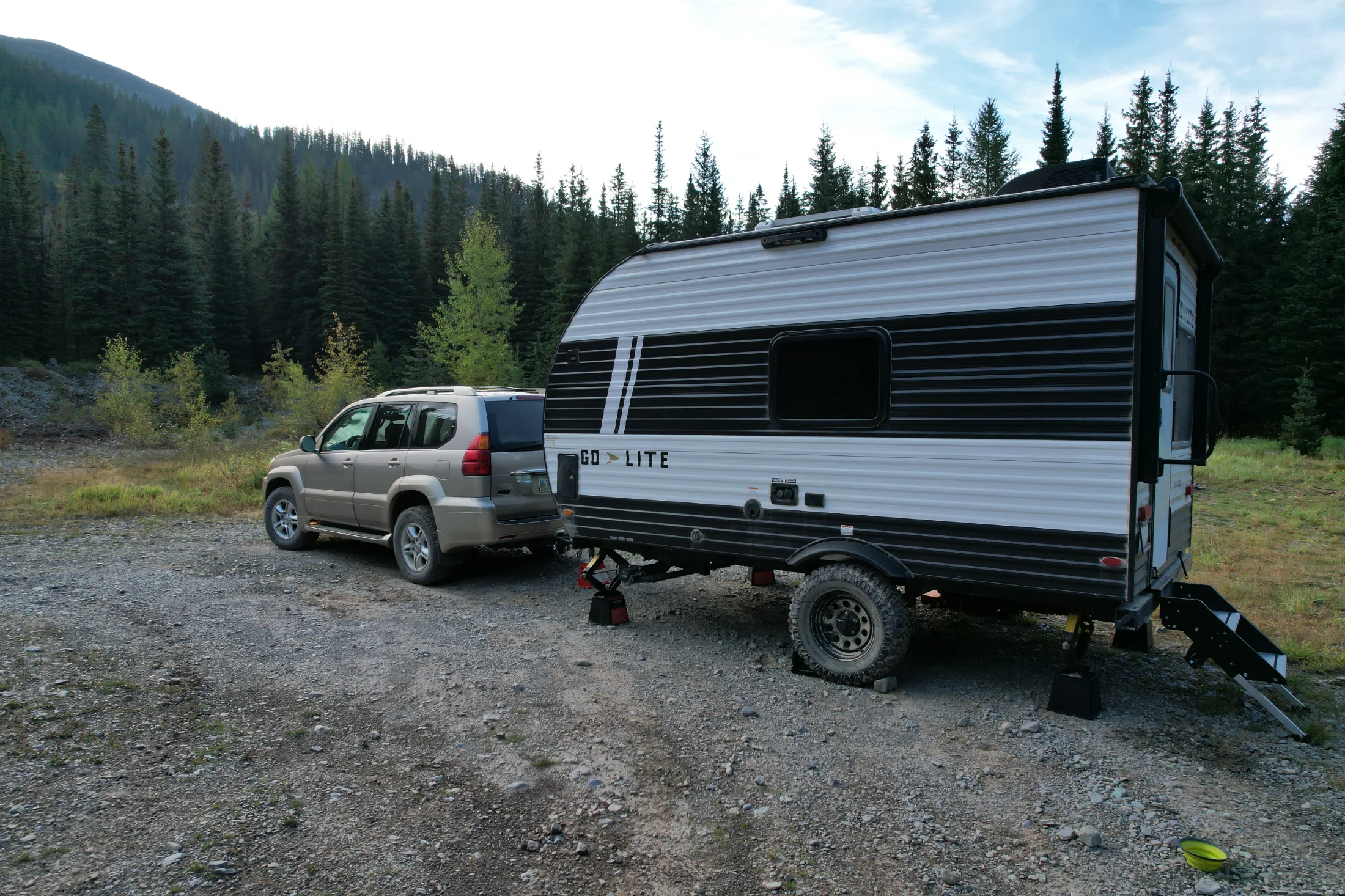

Finally got out with the new camper setup this weekend ... All and all she did pretty good but I did have one issue
  • This may be a coincidence, but since I started pulling the trailer I've had like maybe 6 different rough start / stalling problems
  • To be fair , I don't drive this truck too often, but I've started it in the dead of winter, hot heat of summer after sitting plenty of times , and commute with it a few times a month and its always just fired right up. Way better than the 2UZ in my 100
  • In the past, it was so brief that I wasn't sure if maybe I didn't turn the key all the way and just ignored it
  • But this weekend, we pulled the trailer for only like 1.5 hours... It wasn't too hot out and I was watching temps and everything stayed OK
    >> We got to the campsite and shut down to go look around a bit and then when returning to the rig it tried to start, stumbled, and stalled
  • Turned the key again, same deal...rumbles briefly, and stalls right out
    >> No check engine light, and she started on my third attempt and acting like nothing ever happened
Anyone experience this before? I don't believe this is a weak fuel pump symptom but who knows. For now it'll just be a guessing game
OK otherwise, towing with the GX470
  • Handling seems to be just as good with or without the trailer. Its really impressive how the ride just soaks up the bumps where otherwise I'd expect to be bouncing around
  • The compressor kicks on now and then but doesn't seem to be running excessively. When I park for the night I take the weight off and disconnect the trailer. When I got to hook back up I just set it down real easy and the compressor kicks on and levels me back out
  • She definitely feels the weight back there ( only 3klbs ) The reality is I'll probably be that guy who stays cruising around 60-65. Any more and I think it put a bit of strain on everything
Life with a camper VS sleeping in the back of my 100 series
  • I'll admit I almost immediately regret buying this thing lol....Its definitely cool if you can find a spot but now we are subject to poking around campgrounds and more well traveled areas. We drove a ways into the woods last night and was met with dozens and dozens of people taking up all of the spots . I pushed further as I got more nervous about not being able to turn around and all the usual BS that comes along with camper life
Anyway, here she is
