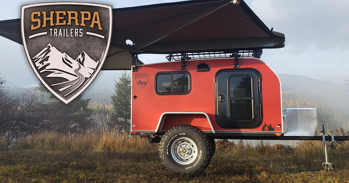

Lately I've been thinking about a small trailer for some light duty camping. I've done minimal research but my first step is wondering, can the GX handle this task ?
- I know it's got the power but what about the air ride in the rear, would I need to remove all of that and add coils instead?
-I suppose the same question goes for the fancy shocks, any reason why they can't handle a light tow load or would I need to think about swapping that too?
- Do I install a normal hitch receiver ? I saw I have some kind of mounting setup right in the center of my stock bumper that looks like it is meant to accept a hitch like this ?
- What would be a good weight to stay under to have an easy time towing? Looks like I can stay under 2k lbs and get a little off road teardrop style
Maybe something like this little thing
Did a little more research, seems like the GX470 in it's stock form will be just fine to pull around a small trailer....I suppose paranoia could push me to replace the airbags but since this won't be a remote off-road-er I'm not too worried about possible failure..I ordered a Curt Hitch receiver and should be able to get it all installed.

Many folks routinely tow 5,000-6,000# with a GX470. I'll be using mine to tow my tractor next month, and have towed our 4,000# loaded camper thousands and thousands of miles with it. You won't even notice a small camp trailer behind it.
For a hitch, I'd recommend the OEM 6,500 pound reciever which ties into both the rear crossmember and the rear framerails. The Curt hitch only ties into the rear framerails (which is why it's only rated for 5,000 pounds). The Curt will do just fine for towing a small camp trailer, but it hangs down lower than the OEM hitch (causing some loss in departure angle), and the powdercoating quality is not very good (my rig had a Curt on it from the P.O. and all of the powdercoat flaked off - I replaced it with the OEM 6,500 pound receiver which was around $235 at my local Toyota dealer).
Regarding the airbags, they'll start to lose air overnight if the fail. It's usually due to dry rot and micro cracks in the bags as opposed to the bags blowing out catastrophically on the road. I'd put the suspension in high mode and look in the bags. If they are full of micro cracks, they'll probably start leaking in the future.

Leaning towards the Sherpa trailer just based on being built nearby and the simple build. Really hard to stomach well over $10k price tag though , for a box of wood on wheels
