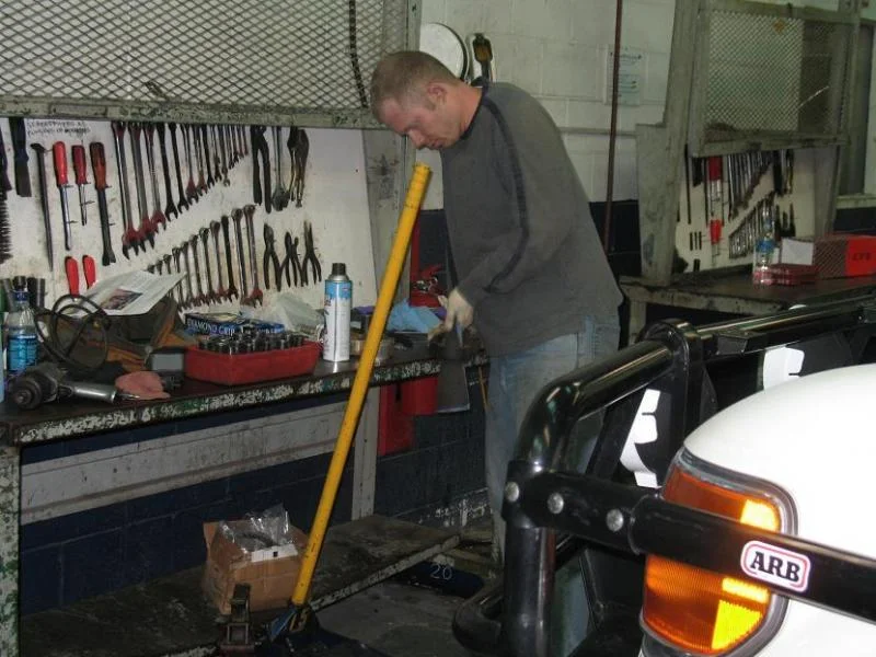

Me and mikedamageinc spent two Saturdays wrenching at NAS Oceana's Auto Hobby Shop. On Saturday (11/22/08) first, we had a Starbucks Coffee to start the day, then we headed to the hobby shop to do the wrenching on Mike's truck.

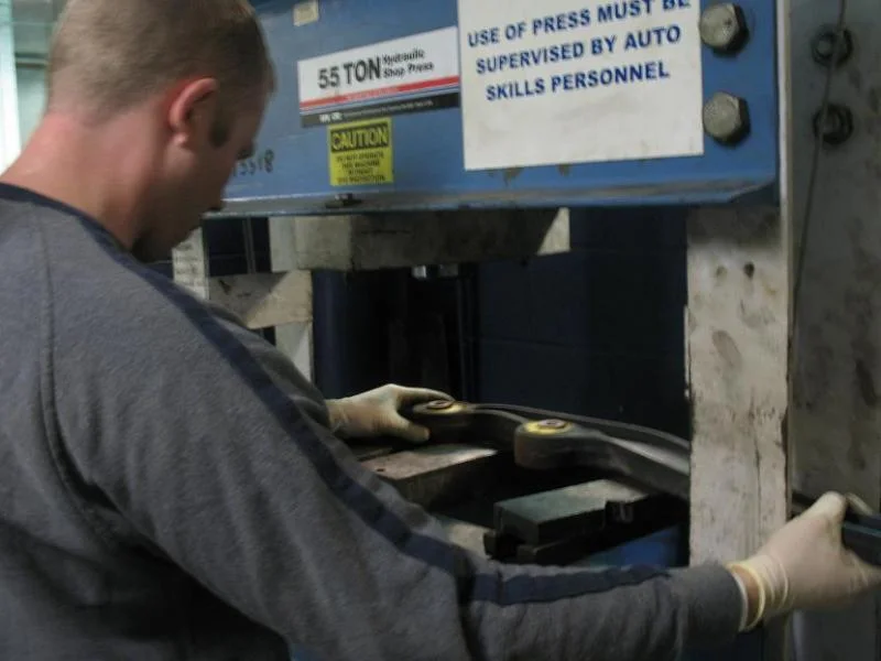

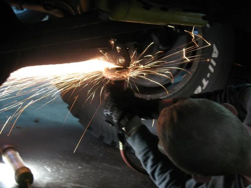

Once we got there, we went straight to one of the stall, then we proceeded to drop the PS side front control arm first to press out the old OME bushings by using the 55-ton hydraulic press, we pressed-in brand spanking new OEM bushings he bought from CDAN. Once the PS arm was done and re-installed back on the truck, then we did the same thing with the DS control arm. Once both arms were completed, we then proceeded to grinding/cutting off the metal tabs on the front axle to mount the new Slee Caster plates he bought from Slee.
What took us longer in doing this wrenching was the pressing out/pressing in both OME and OEM bushings and the grinding of metal tabs to facilitate the installation of the new Slee Caster plates.
Pic #1. Mike's positioning the control arm to press the OME bushings while I snap pictures.
Pic #2. mikedamageinc cleaning the control arm bushing holes to press-in the OEM bushings he bought from Cdan
Pic #3. He's grinding the metal tabs on DS front control arm to install the Slee Caster Plates.
