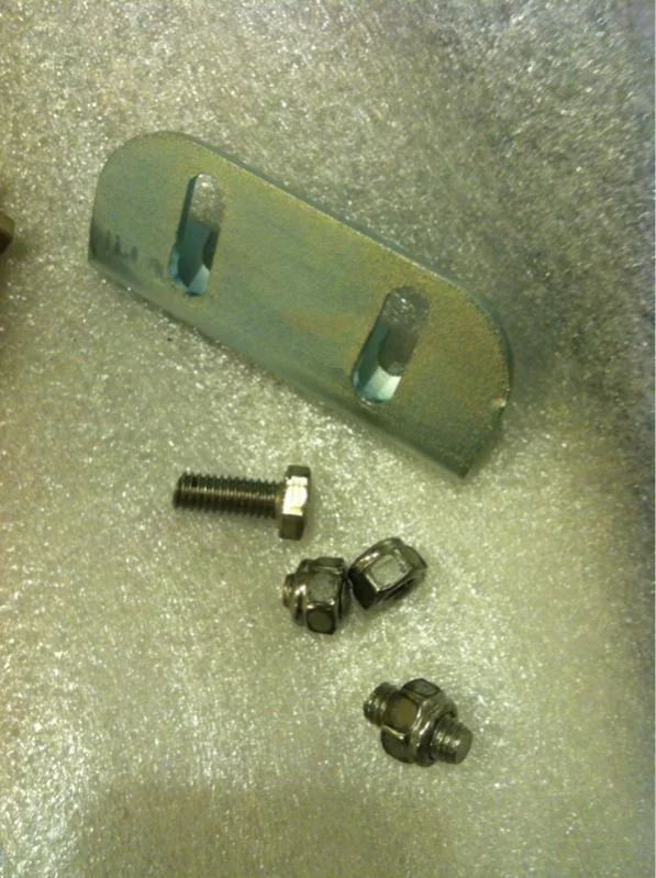

I just put one side on. It took 2 painful hours. I had to widen the slots for the piece of the latch that bolts onto the body so the holes would line up. Also 3 of the hinge bolts that came in the kit broke when I installed them. I think the bolts were stainless and the nylock nuts weren't and they galled up. When I do the other side, I'll put some anti seize on them. Finally, the bushings for the new hinge pins that I ordered from CCOT didn't fit, so I had to drill out the hinge holes to 3/8".

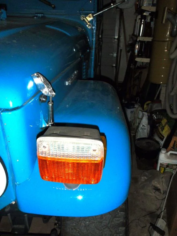

Senor Aguas, here is photos of your driver side fender of your '67s on my '78. It fits like a glove. The passage side is still in rehab.

I totally forgot about my fenders! I'm glad you could use them. I hope they weren't in too bad of shape under the paint.

If the bolts are stainless steel as are the nuts. If our hardware vendor used the same series of stainless for both the nut and bolt, then they can gall. Typically our bolts are 304 and the nuts are 316. No issues. I will pull a pack and see if they did not do this the last time around. The other option is for us to just use plated hardware.

I ran a magnet over the bolts and nuts. it stuck hard to the bolts but almost not at all to the nuts. whatever that means (im a mechanical engineer but dont know stainless).
also, this piece with the slots.. the slots are slightly too far apart for my '67. I had to widen the slots to get it to fit on the passenger side. I'm guessing it will be the same for the drivers side when I get to it.
Yeah I had to take a Dremel tool and a grinding wheel to my latches to widen the slots. Too close together on my 67' also.
