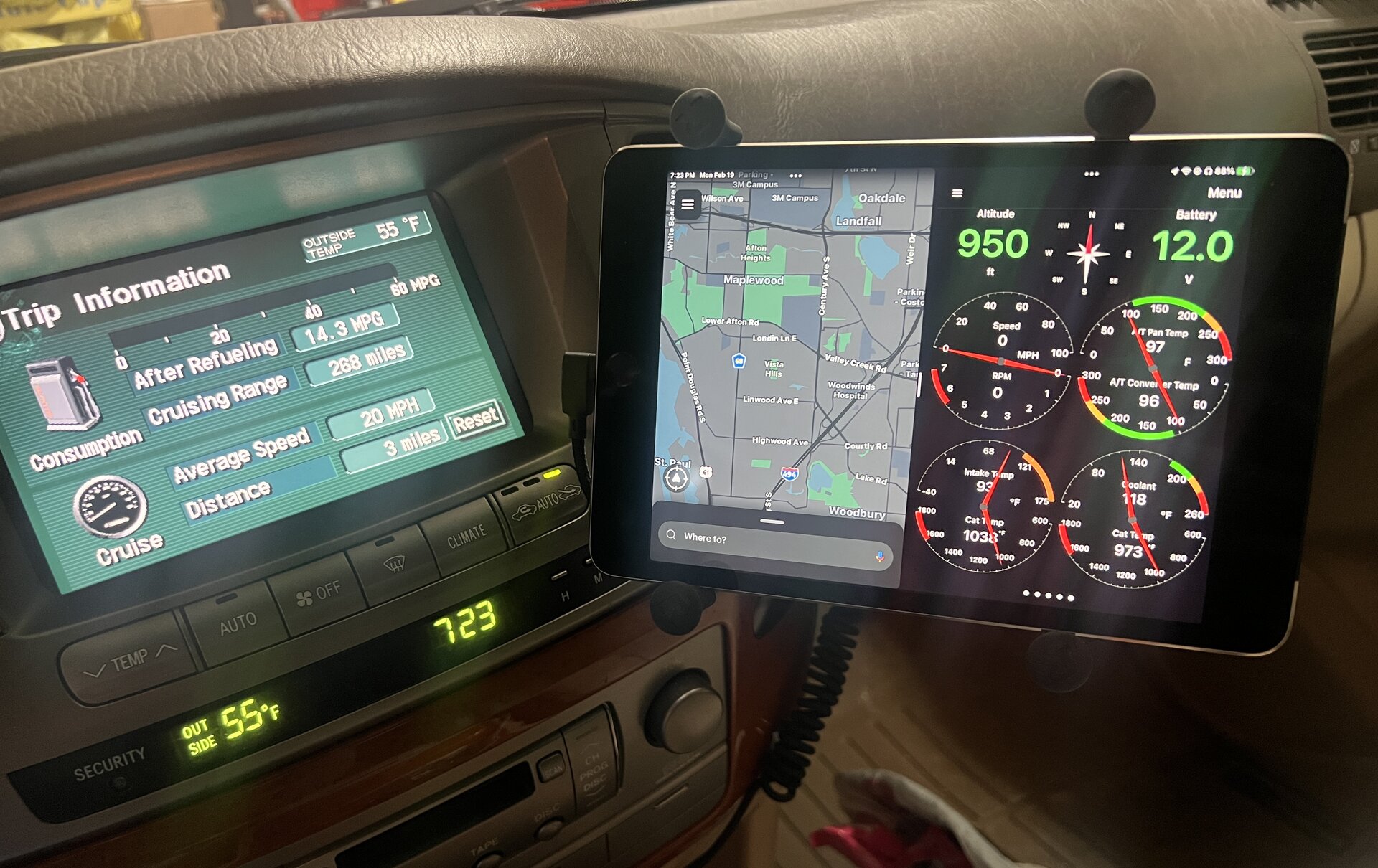

I mounted an iPad Mini 4 w/Cell and use it split screen for Nav and OBDFusion. I also have Spotify running on it connected to Grom's BT unit. Total install time would be about an hr to add in the Grom unit and the panavise mount. I now have modern tech that I can replace as new options are released and the truck retains all factory systems + a nearly factory look.

Do you have pics of this setup?

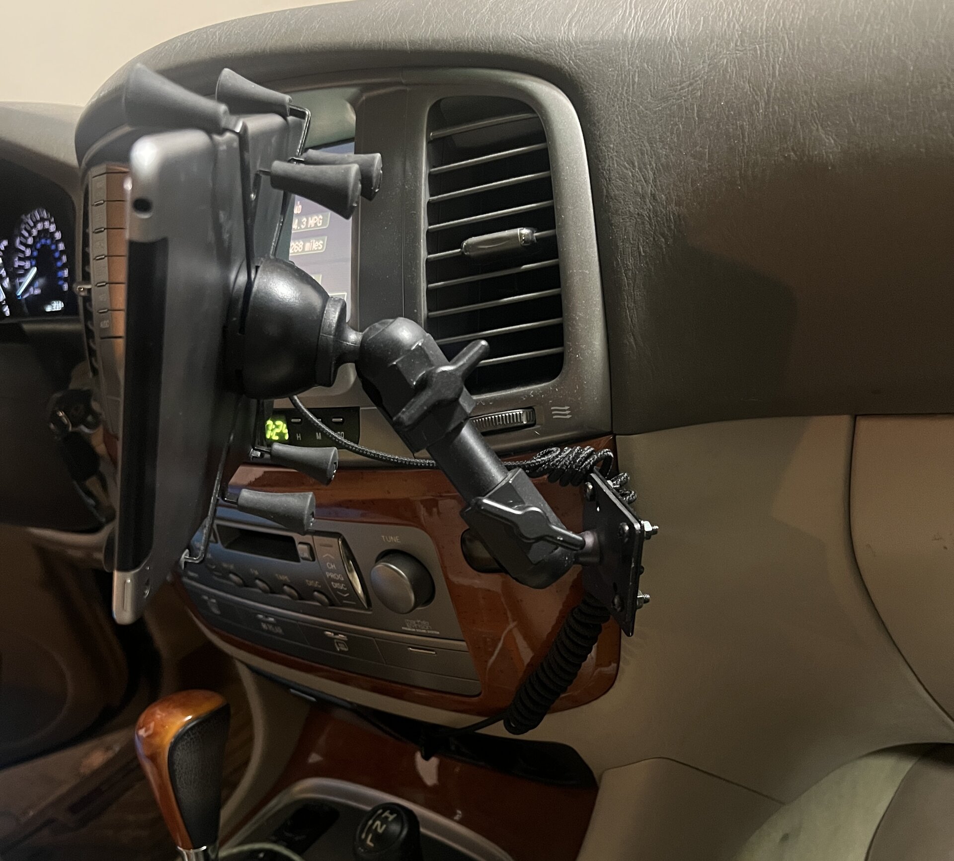

rhetoric, very interesting mount. I can't see clearly how the mount anchors to a fixed point?
Also, any bounce when on rough tracks?
You have to remove the trim around the lower radio/defrost buttons. It screws into the dash there, then the trim is put over the top.
Bouncing is... fine-ish due to the weight of the iPad and the length of the extension. Switching the orientation to landscape did help when compared to vertical. I do mostly highway duty but over rougher terrain it still works great. AKA: the iPad has never fallen out of the device. Vibration is far less when a phone is used.

Nice. is the "screw in piece" custom or an aftermarket item? if aftermarket, can you post source/pn?
