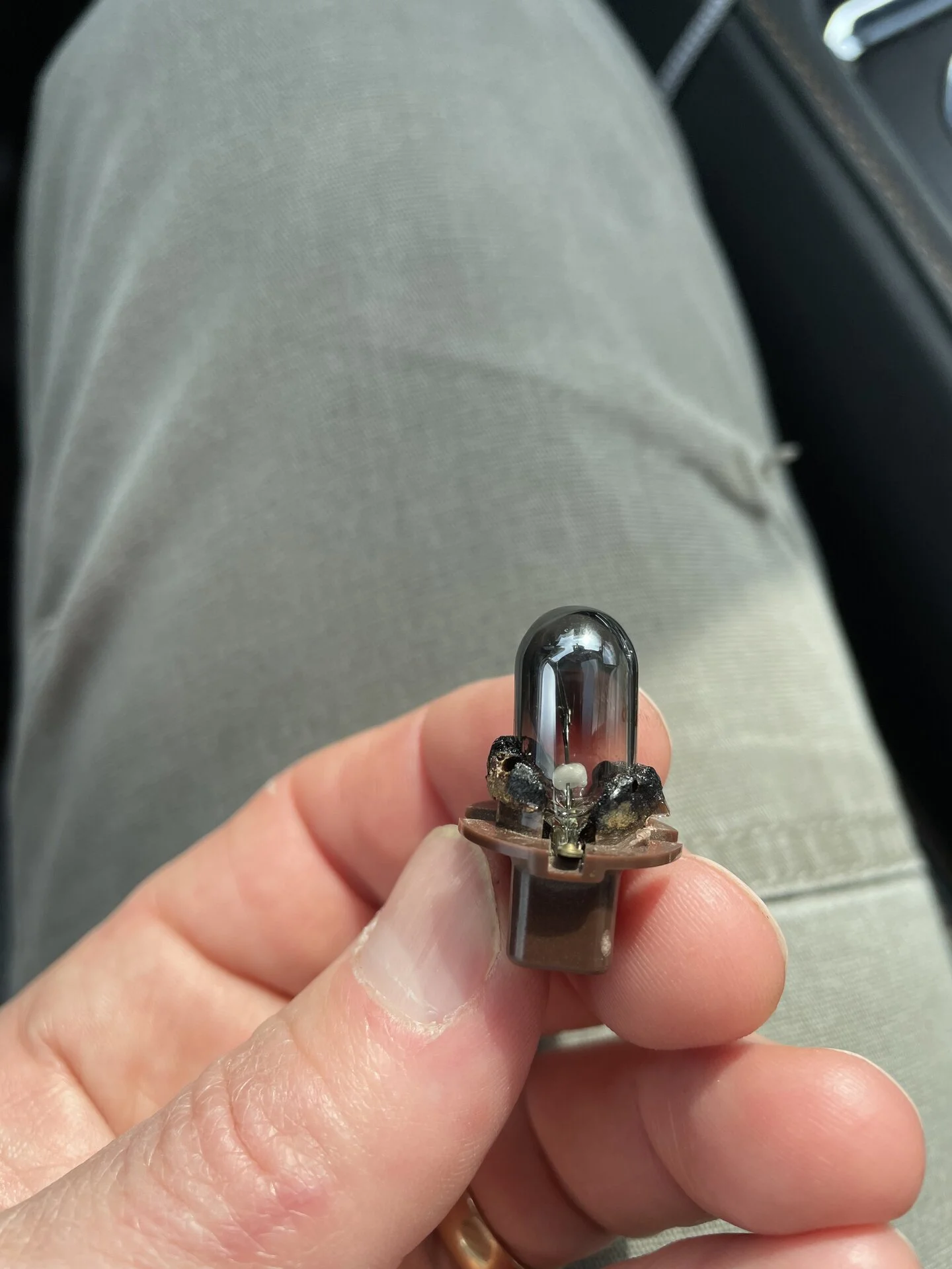

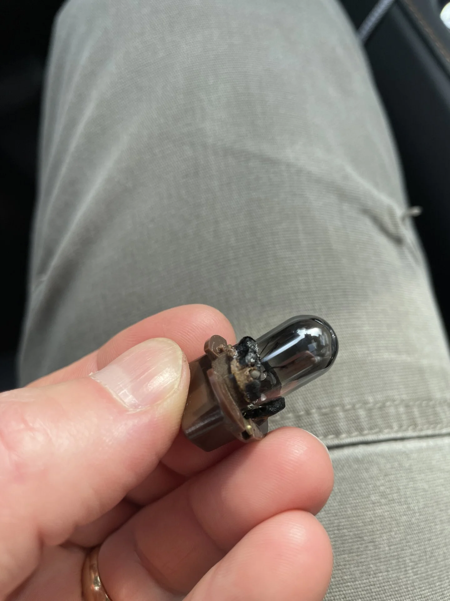

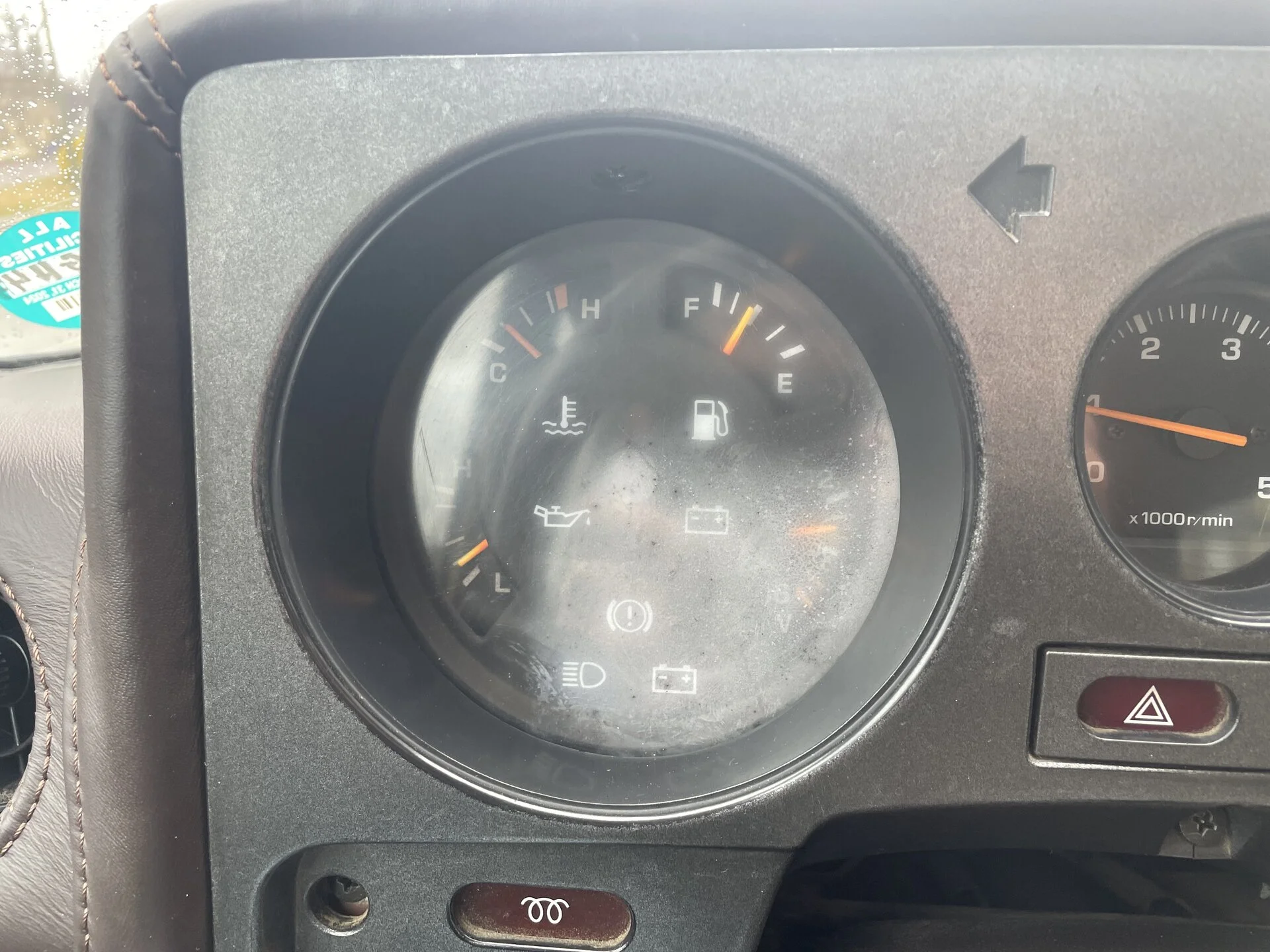

Far left instruments would not illuminate when headlights were on. Removed instrument cluster today and found a melted lamp socket housing(see below). I have been scouring the web, but can't seem to find a replacement lamp socket housing. "Yazaki" is inscribed on the back of the housing.
Instrument panel also fogs(see below). Any chance these are related issues? Do I need to be worried about anything in particular or can bulbs get that hot when they blow?

u NEED LED bulbs
and NEW OEM toyota bulb sockets
also polish the COPPER with KID gloves , using say 1500 grit wet sanding CUE TOP Style
lube all with die electric grease
verify ALL grounds are GOOD white wires w// black tracer stripes
i saw this many times ant the dealer ship back in the day
ALL above done corrected this issue
