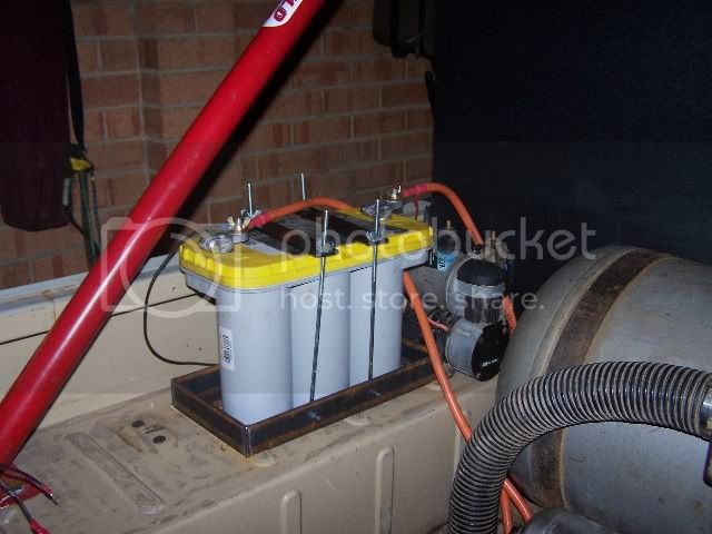

I have moved the battery out of the engine bay (because it's a pain having it in the way and I need more weight at the rear not the front) and intend using the exact same space but for a cylindrical surge tank with the outlet right on the base rather than the side.

My Batteries :D
