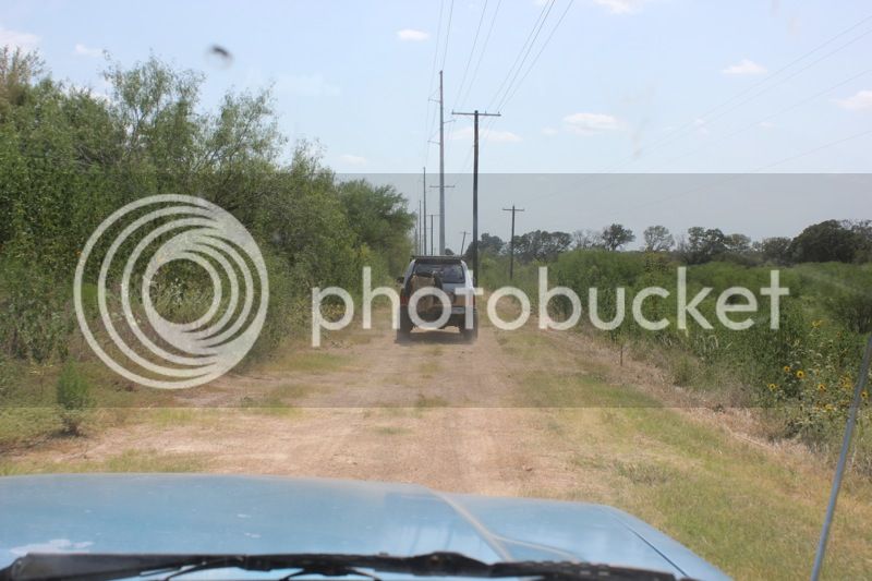

Some pics from Brazos Valley Offroad Ranch at College Station, Texas
