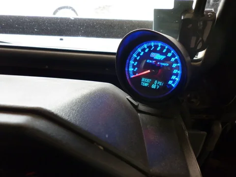

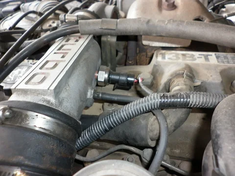

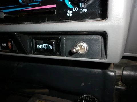

We picked up a 3 in one gauge from Glow Shift for boost, water temp and EGT's. Also had them send an additional temp probe that I am going to install for tranny temp. We also picked up an on-on switch to go between water and tranny temperature probes.

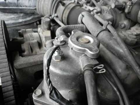

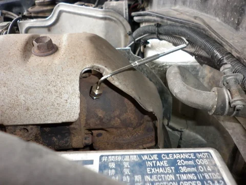

For the water gauge we installed it beside the rad cap. Maybe not ideal, but still better than the factory one. EGT's are post turbo but that was the easiest place to access, and close enough for me.
I still need to install the probe for the tranny temp, but that will be another day. So far they are working great, no issues so far.
