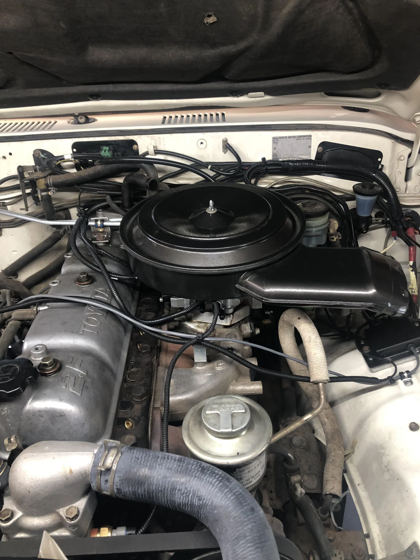

Just completed the AFI install that uses a GM throttle body. Have some wire harness clean up to do, but overall very pleased with the performance. Install was straight forward and not difficult. Engine fired on first crank. Runs very smooth even with a stone cold engine. Timing is now computer controlled. The black box on the fender is the ignition box. I did use a Holley sniper coil. Not required but the original coil had a loose terminal stud. Used an air cleaner from a 1986 S-10 which used the same throttle body. Three sensors are added a coolant temp, manifold vacuum and oxygen sensor (O2). I am going to modify the factory cold air intake hose to fit the air cleaner.

TBI setup from the GM version was very dependable / rock solid, near zero issues over time for the most part, I had a GM 1/2 ton pickup for a while with 5.7 V8 (TBI) version, not a power-house but really dependable.

I would bet, once dialed in, the truck will start and run well no matter the temps etc....right off the bat from cold start.

Agreed. It ran good for a carburetor but that is like saying it charged good a generator. In my opinion FI is way more reliable then carburation and much more tolerant of the alcohol in todays gas blends. No vapor lock or high altitude problems, the list goes on. I have done the Rubicon in a carbureted rig and FI rig and it is a night and day comparison.
