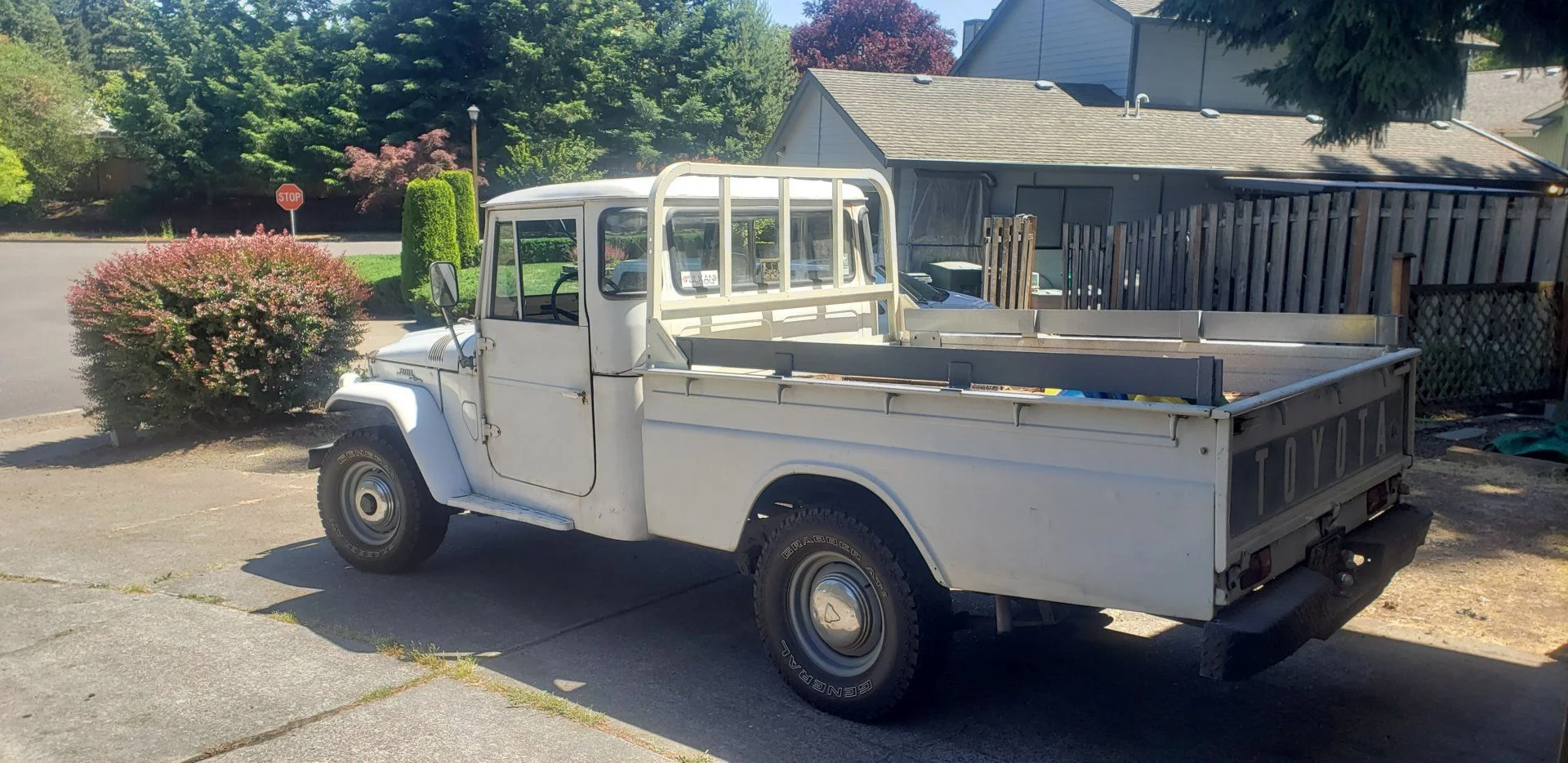

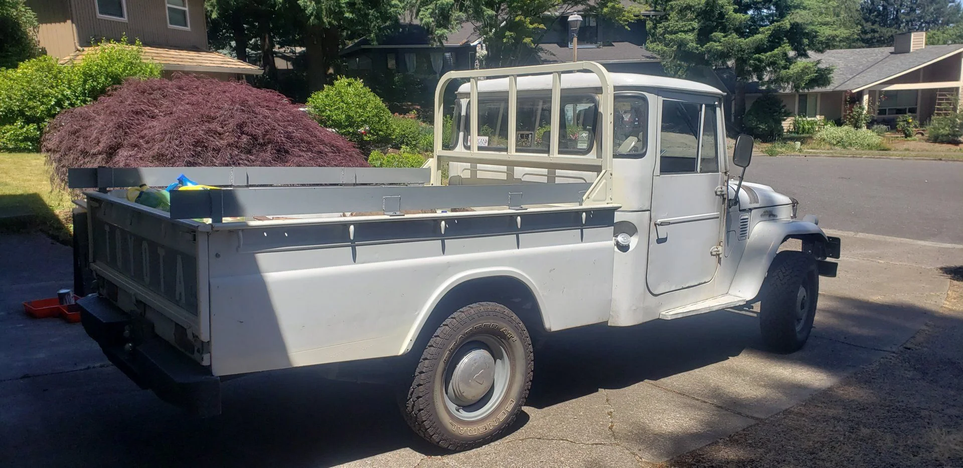

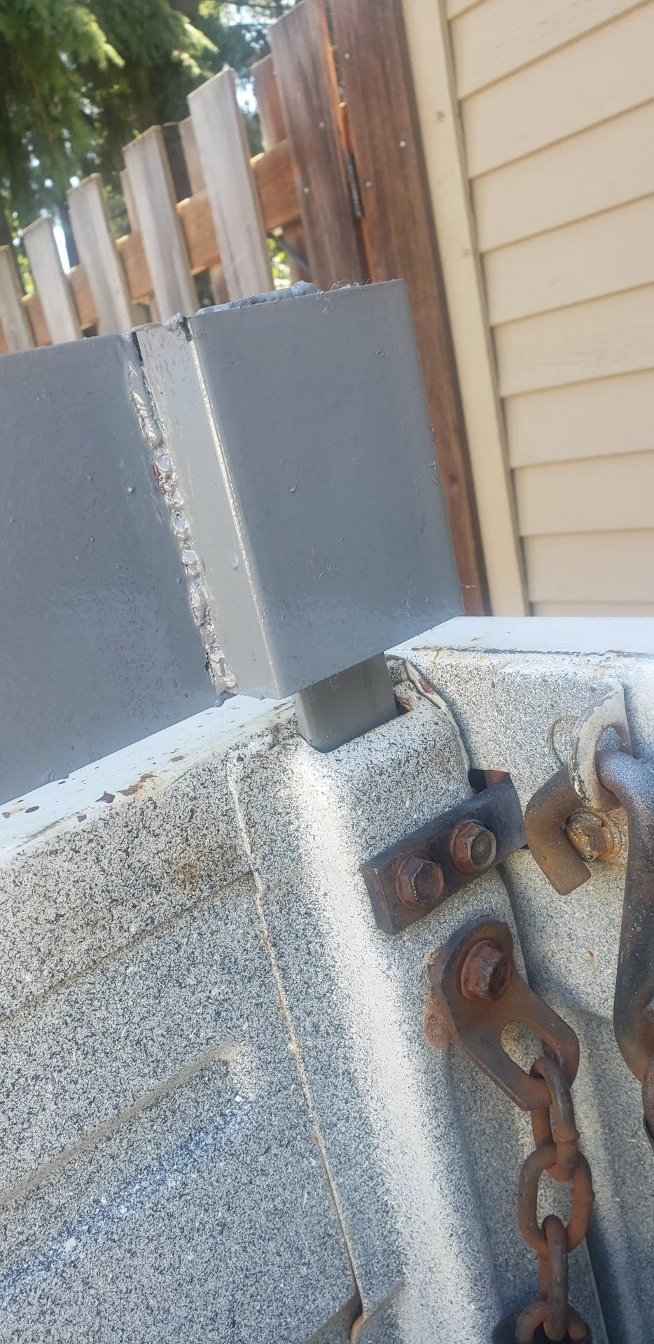

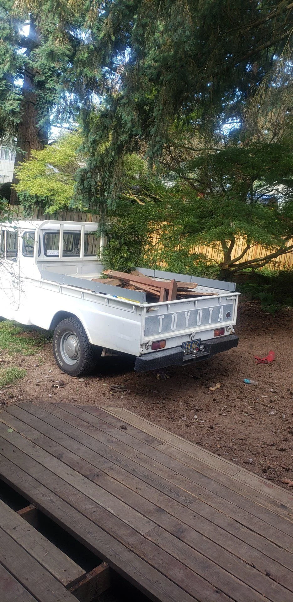

Corners wouldn't line up? I did have to take a hammer to one side of mine and cut just a tad. Looks doable still with a cut and weld. Either way nice.
Not quite. Didn't really bother me enough to spend the time massaging them to be perfect. 'tool not a jewel' and all that. Looks fine to me, and eventually it will be covered in a canopy anyway.

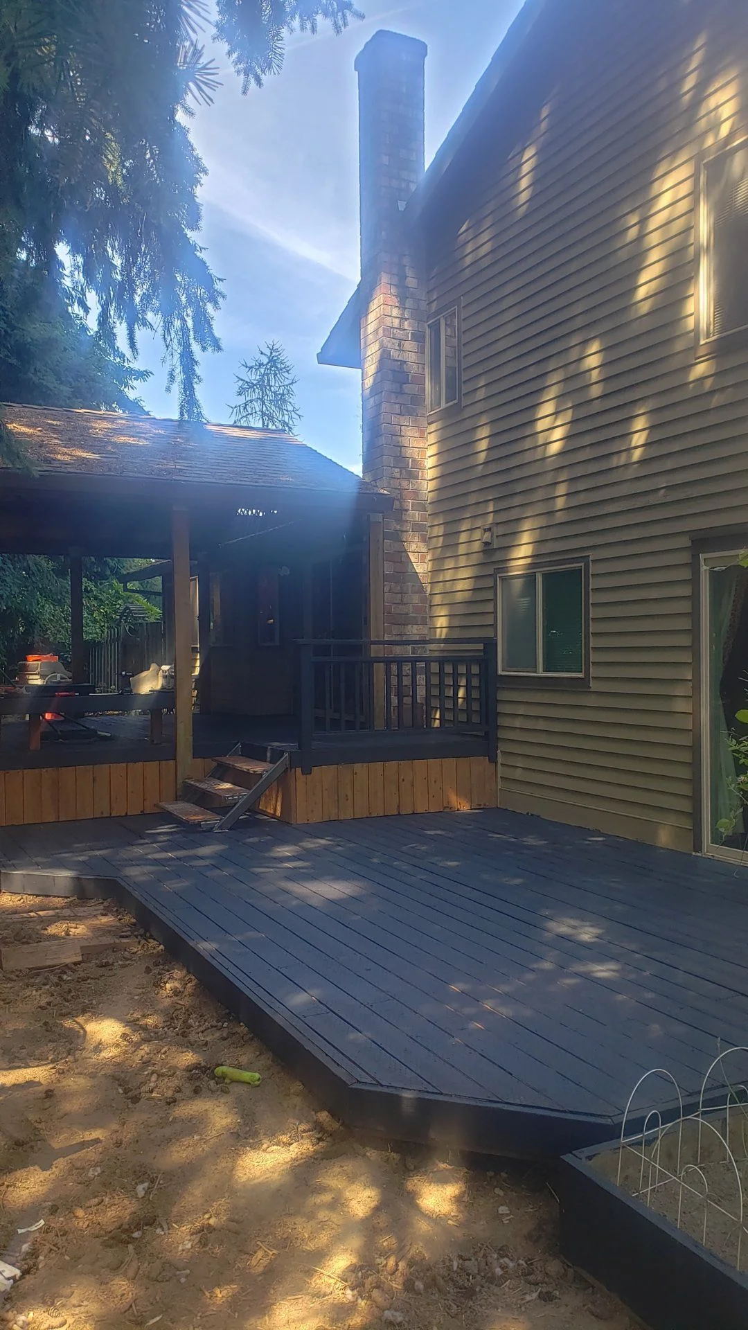

Been a bit since an update. I've been busy (as has the Maytag). Deck repairs were keeping both of us pretty occupied.

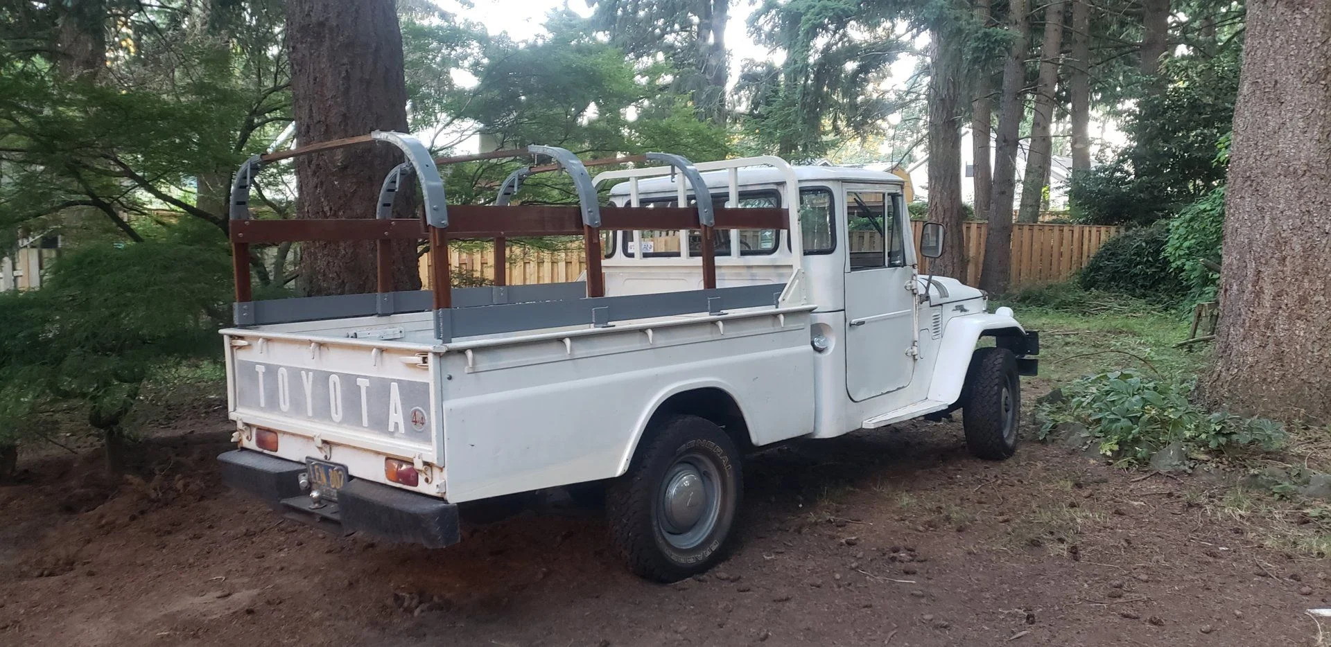

In the previous post you may spy some new rails on the bed sides. Here's where I explain those...

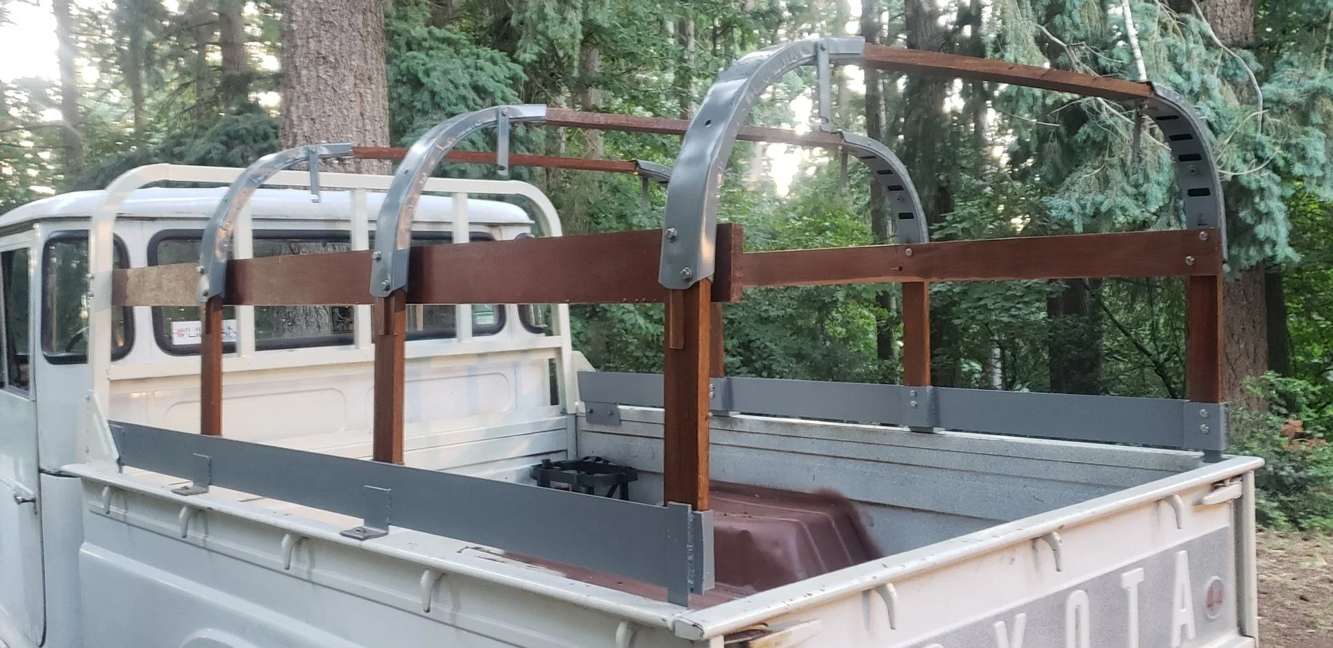

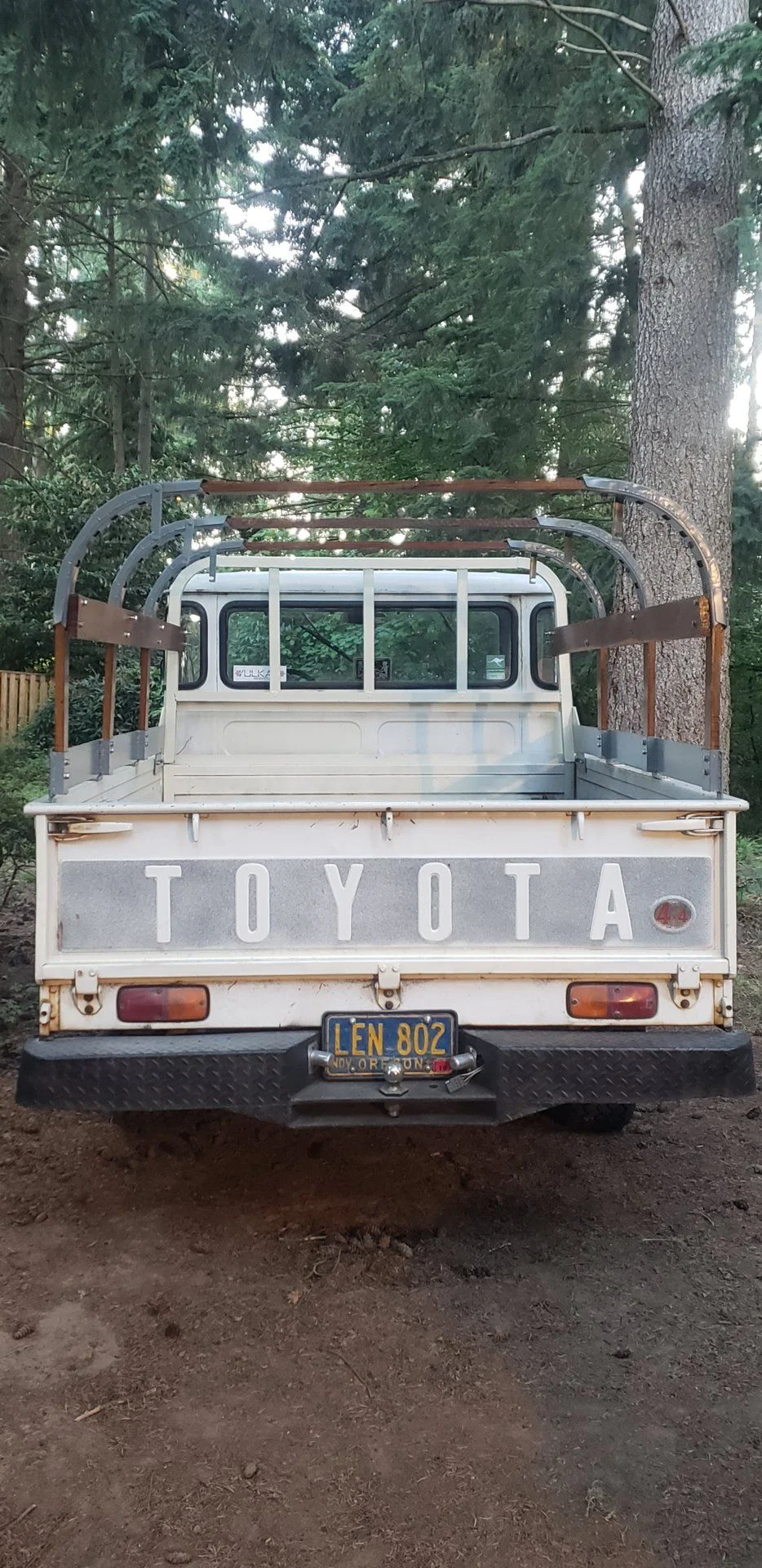

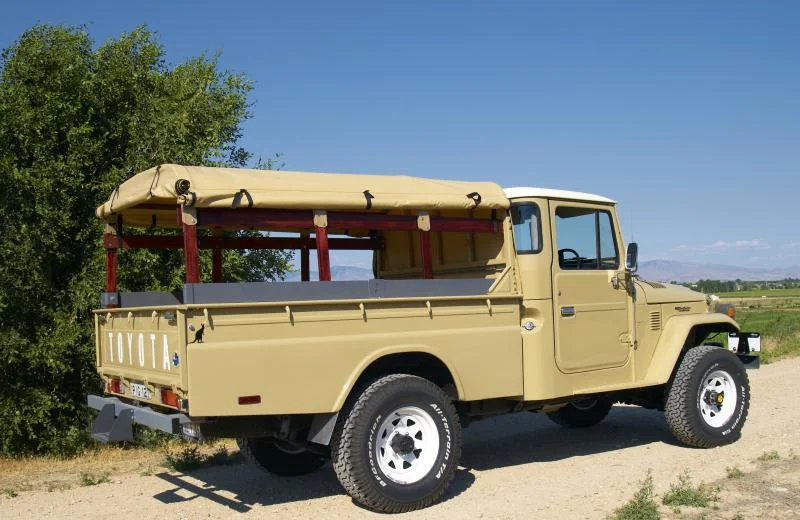

Since I got the truck I've been planning a canvas bed canopy and have been researching ways to do that.
The plan I settled on uses a combination of wood, metal fabrication, and bow corners from an M35 Deuce & a Half, for a very aesthetically pleasing result. Credit for this design goes to @love2fly. I used his pics as inspiration.
Thanks to his detailed pictures I was able to get a very good idea of how these are attached to the bed.

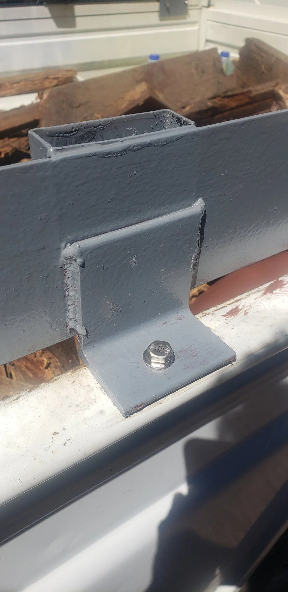

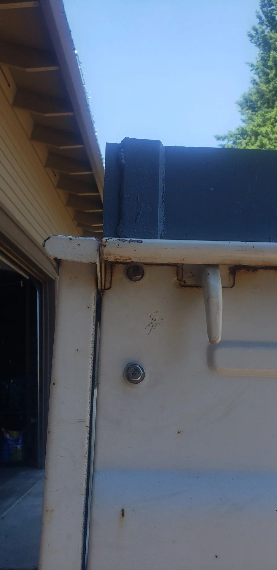

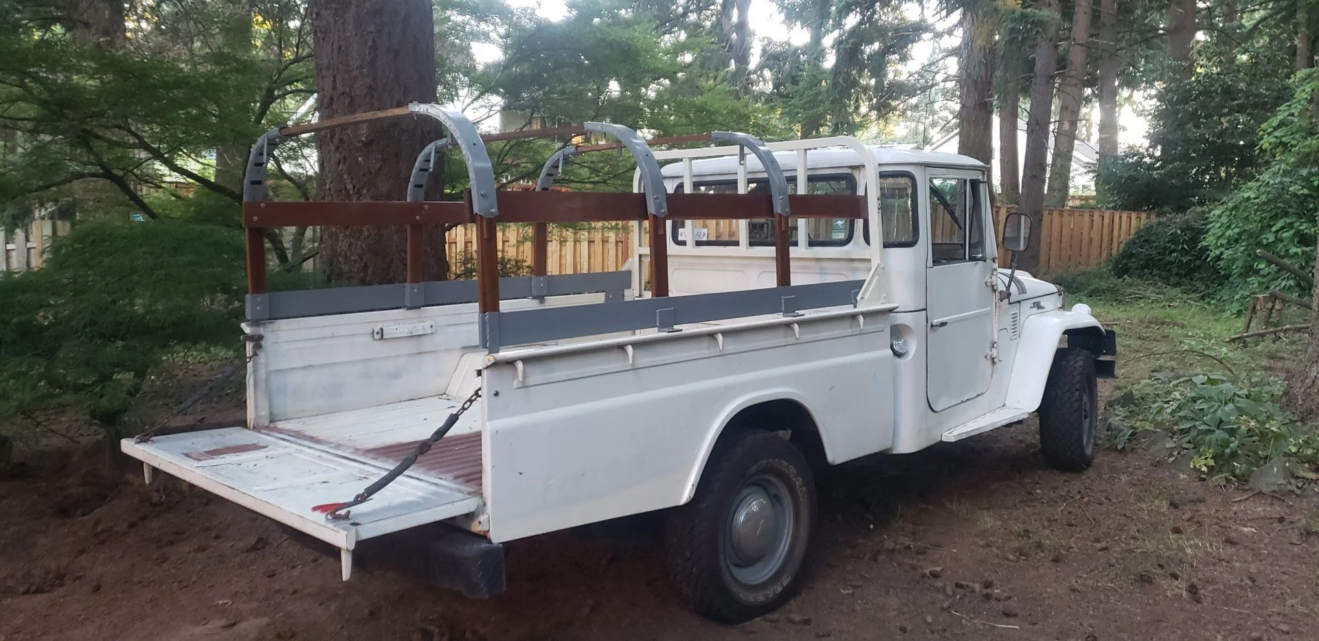

First up I needed to make some rails that would attach to the bed sides and had pockets for the wood. I made these with some 1/8" flat bar, 1x3x1/16" rectangular tubing, 2"x3"x1/4" L Channel, and some 1.5" x 3/16" flat bar
The following pics show how it is attached to the bed.
There are factory holes in the bed here. I welded some captive nuts into the 1/4" bar to secure the rails here using the existing holes. I needed to use thin Jam Nuts here so they would fit into the pocket.

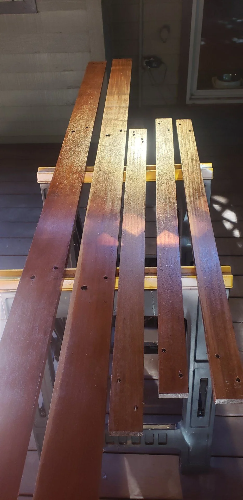

Next came the bows themselves.

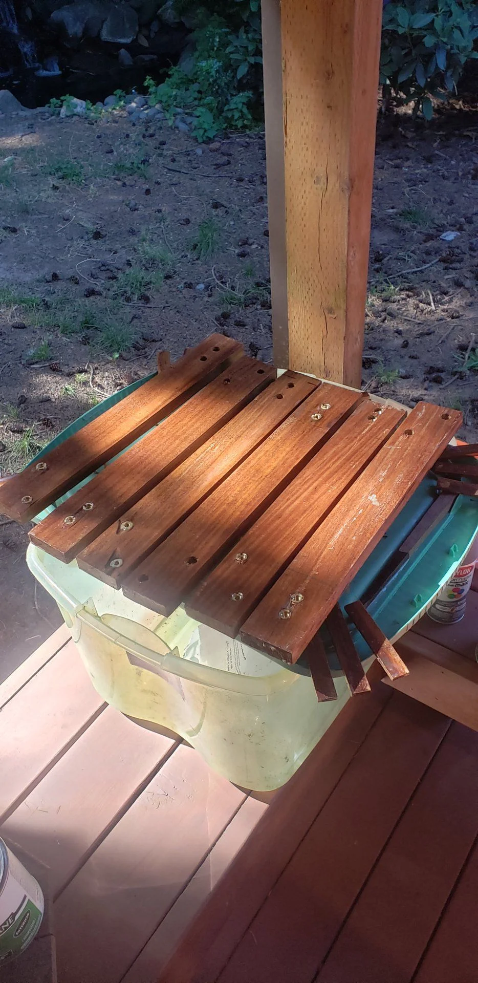

For the wood I chose Ipe, an insanely hard, dense, outdoor stable wood (also known as Brazilian walnut). Finished with Spar Urethane (or even left unfinished) this wood will probably outlast the steel.
Threaded inserts will secure the bows to the corners and rails.
As mentioned before the bow corners are military
surplus from an M35 Deuce and a Half. Easily available from many online dealers.
