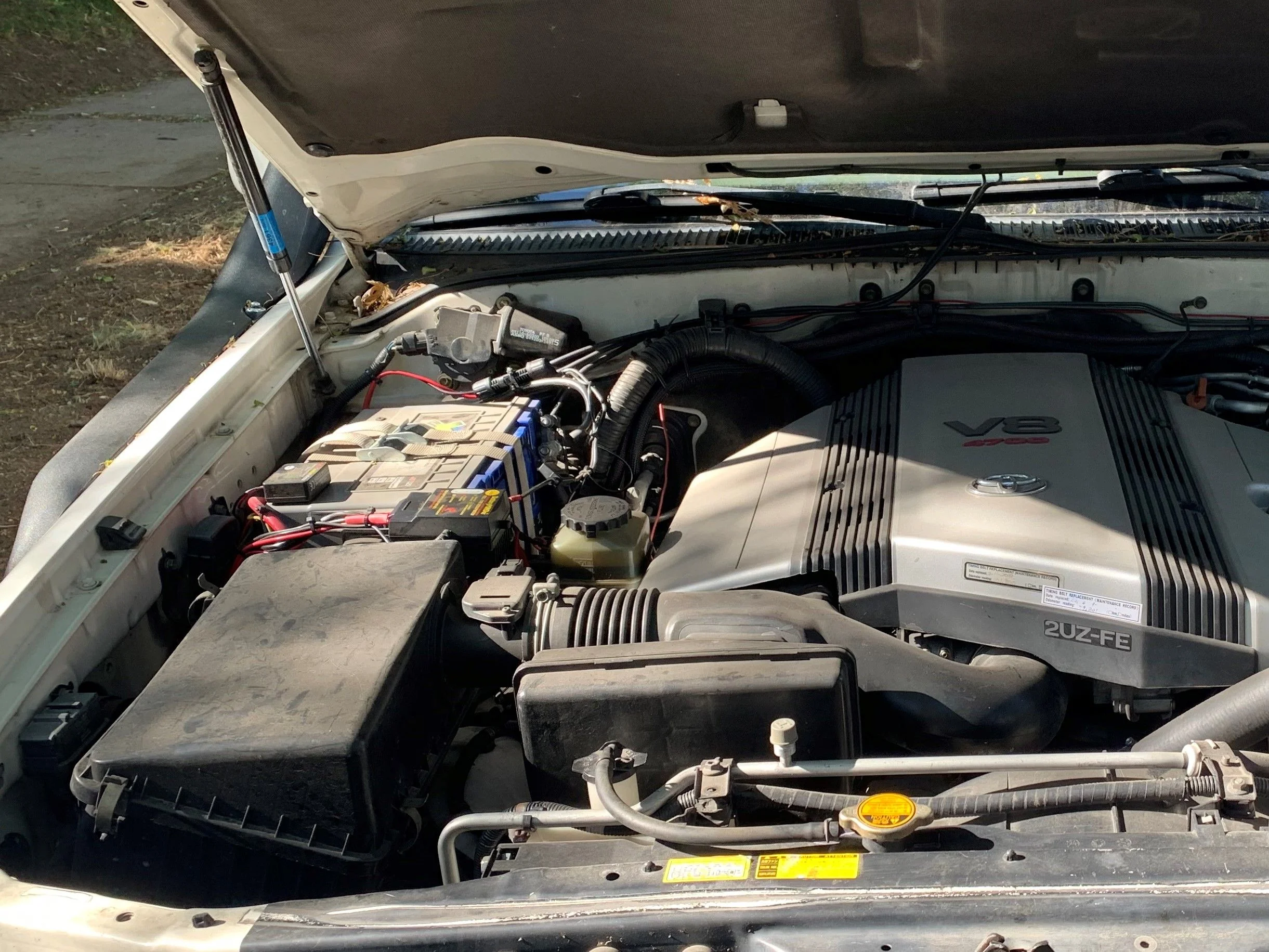

I run a 2nd battery in a Slee mount monitored and charged with a REDARC BCDC unit. I'm currently running a Group 22 60 AH AGM wheelchair battery, and would like something bigger--my fridge recently ran this down to about 50% (12V) in about 15 hours of sitting in mild weather.
The current Group 22 battery doesn't take up all the space in the Slee mount--length is about at max, but I could probably go another 1" of height (9") and another 1.5" of depth (7" vs. 5.5").
Definitely want a true deep-cycle, as I only use this battery for low-amp applications (e-locker relay, fridge, USB chargers, etc), but haven't yet found anything with more than 60AH that'll fit. Anyone have any secrets?

I had a X2Power brand Group 27F AGM (92 AH) on a modified Slee 2nd battery tray. The guy I bought my Cruiser from did it. He added plywood on the base to make it flat across. With that layout can fit the 27F on its side. AGMs can be mounted sideways.

Thanks! Looks like that's either an earlier version of the Slee mount, or he cut out the section between the compressor mount and the rest of the mount. Having just mounted a compressor on mine, I'd like to keep it, but could perhaps move it somewhere else more easily than I can find another battery . . .

Well, I just measured my Slee tray tonight--it's about 9.25 long and 7.5" wide, so no way i can cram even a 75AH battery in there. And because the inboard end of the mount is partly the bracket for the PS reservoir repositioning, it cannot just be cut off. Unless I want to jettison my compressor and mimic @CORunner 's setup, I reckon I just need to figure out how to live with 60AH of storage. Perhaps grab some solar panels . . .
Maybe not the answer you want but you can also rewire it... make the 60AH battery your starting battery and one near the headlamp the 100AH aux battery.
And also, a more expensive option but a group 31 battery also fits in front of an OEM cyclonic airbox. With this mod, you can actually fit three batteries under the hood of a non-AHC 100.
Great idea, thanks! Hard to tell for sure in that thread on the cyclonic filters, but it doesn’t look like there’s gobs of room between them and the AHC reservoir, which has may mean one wouldn’t fit in front of the Slee 2nd battery/ compressor mount, which I think extends pretty far forward of the AHC reservoir.
but you’ve got me wondering how many amp hours I can cram in front of the stock NAS air filter housing—there might be room for 10 or 20....I’ll get out there with a tape measure tomorrow....and this also has me thinking of the space where the charcoal canister is on early 100s—I’ve got an six fuse panel there but some space under it...thanks again.

I think i've come to the conclusion I'm going to run a LiFEPO4 in the back. Sucks to have the system take up space, but keeps weight off the already heavy nose and probably the only way to get the usable 80 Ah I'm looking for. Two 50 Ah batteries can be tucked away pretty well near the wheel arches.
