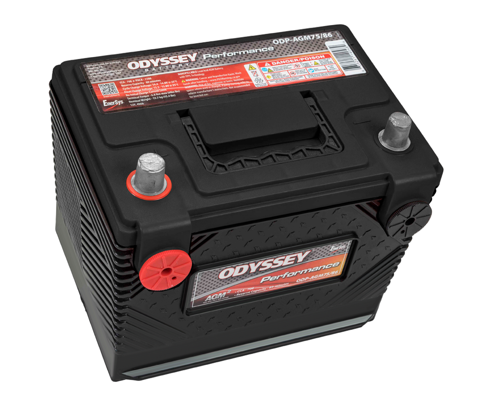

I've got an Odessey AGM 75/86 in my slee second battery tray.
That looks great--didn't know they made that. But my wheelchair battery still has a bit over 20% more Ah . . . and cost nearly 30% less.
Amazon product ASIN B01N15XBBR
I think Ah rating (that will fit) is the only thing that matters, although LiFePo4 batteries make even that discussion weird, as they can use pretty much all the amp hours again and again, whereas us in the under-hood crowd can only use half of ours.
