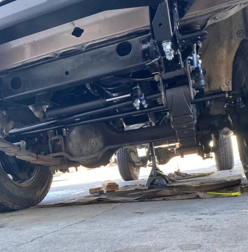

More on the steering gear setup. I had installed an upgraded 80 series gearbox, with 105 series parts. Due to the larger diameter of the sector shaft you have to use the 105 pitman arm or go with something custom. Additionally, the pitman arm does not accept the 60 series rod end due to the mounting hole having a shallower taper. Instead of reaming the pitman arm to take the 60 ends, I decided to upgrade the whole steering arrangement and make use of 80 series rod ends too. I got the knuckle arms, rods and ends as a kit from 4x4 Labs. Awesome product and customer service from the guys over there. The rods and knuckle arms are suuuper beefy. The other cool thing about the kit is it relocates the relay rod to the knuckle arm and it flips the rod ends to the tops of the knuckle arms. Gets the rod ends out of harms way and flattens the rod angle out. It all comes bare metal so I prepped and gave them a coat of POR-15 before install. The steering stabilizer is the heavy duty kit from marlin crawler. I also installed extended sway bar links and bushings.

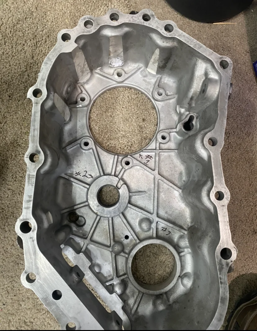

Went to the machine shop a few days ago and finished up milling the case for the reduction gear set. We dialed on the center of each bore and started taking off material a little at a time. It was going really well until we started getting close to the OD we needed and poked a couple pin holes in the case. Darn. Luckily, my machinist friend is also a talented welder. He welded the holes on the outside and inside then milled again to get us the clearance needed. Unfortunately, I still needed to take a little bit of material out with a file when I finally went to assemble the tcase and disfigured the nice machine work. Oh, well. It’s all inside the case now and nothing grinds, binds or leaks! Even though having welds on the exterior of the case is a little ugly, I’m glad there’s more material there now. It does end up pretty thin in that area without it.

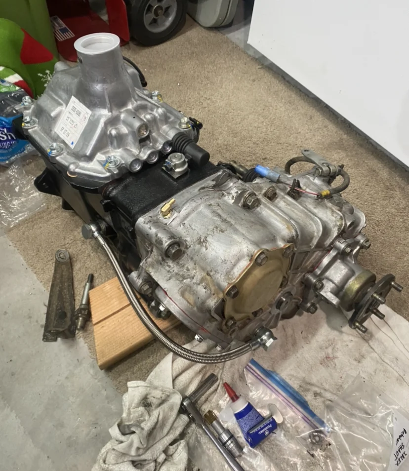

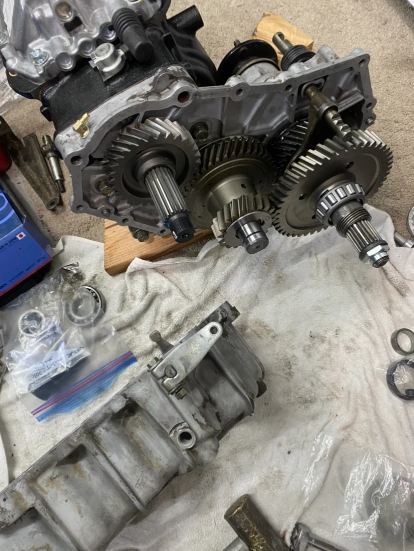

The following day, I got the tcase assembled on my H55. Did it “by the numbers” and followed along with @orangefj45 tcase rebuild video. Such a helpful piece of info that video is. Makes me think of how many split cases were properly assembled due to that single video. Awesome.

Looks like you have a 34mm case? This typically end up with two holes if you clearance them for the low gear sets.

Tremendously! Thank you. Yes, I do have a 34mm case. I am curious though, is there a difference in case thickness or bore placement that causes that?

Why is the bypass hose on it? I mean if you rebuilt it then there is a new seal and no migration of oil between the trans and the t case.
Quality work going on here. Surprised more members haven't chimed in. Looks great.
Thank you! Short answer, paranoia. I spent some coin on the tranny and building the tcase so I figured it was cheap insurance to prevent them running dry, just in case the seal fails.
I’d remove that hose. If both units are in great shape, you should have no leaks.
If you leave the hose in place and there is a leak, then in theory, you can lose all the fluid from both units and potentially damage/ruin both of them. You also run the risk of cross-contamination. These hoses are a Band-Aid at best. I can’t stand them. It’s a short term solution to a bad transfer case input seal. In your case, it is absolutely superfluous and should not be on there IMHO.

The 34mm case casting is slightly “smaller” than the 38mm counterpart. The difference is only about 3mm. That’s why we prefer to run/machine the 38mm cases for the low gear sets.

Copy, also great to know. I never would have thought it could cause damage having it installed.
Edit: I see how an external leak could drain both gearboxes with the hose installed. I was worried about a leak in the t-case input seal and didn’t consider the effect it would have if there were an external leak.
