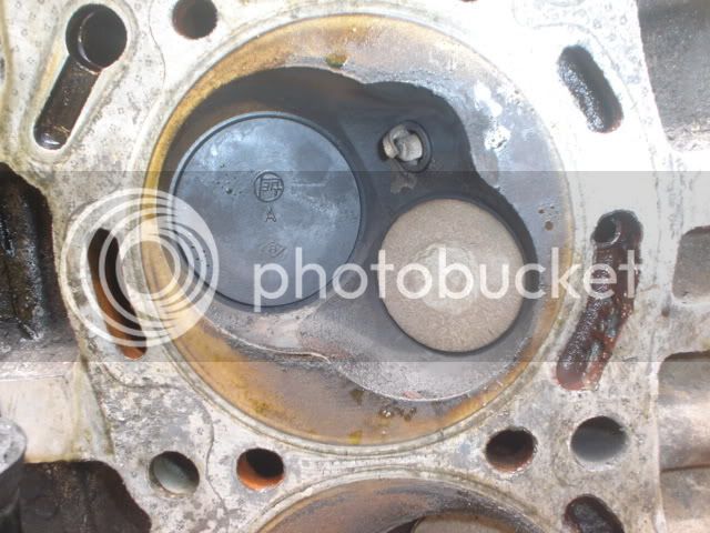

after 190,000 mile my 22RE blew its headgasket.
after removing the exhasut manifold, i saw it was wet in the #1 hole and #2 hole.
after removing the head and inspecting the head gasket i saw that the metal has delaminated around the round part near the combustion chamber of the #1 hole.
well why did #2 blow out coolant too?
because the green coolant that was in there ate away the metal.
i had changed out the coolant less than 10 months ago. but i did use green. shame on me. I have owned it for about 15 months. and based on the amount of stock parts on this truck and the overall lack of care this truck had before i owned it, I guess the coolant hadnt been changed if ever in the last 8 years.
please use the right coolant, OEM red Toyota coolant.
#1 hole. not horrible wear, but still bad.

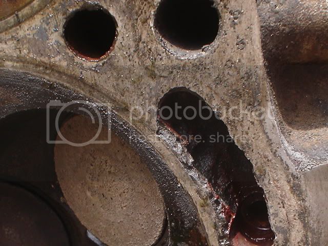

#2 hole. very bad corroison on the exhaust side

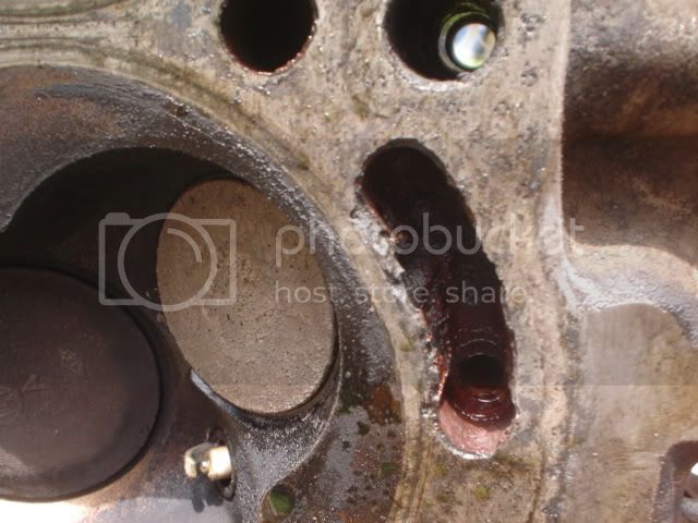

a close up of the cavity
I doubt that this had much/anything to do with it.
This is probably the biggest contributer.
The type of water used can also be a big problem, best plan is use distilled water. That head doesn't look that bad, I have seen them with holes eaten all of the way through!:eek:
after thinking it over today, i agree that the kind of coolant used wouldnt matter. my thinking was the red is made to prolong the life of the waterpump seal, and inhibit electrolisis in the aluminum and steel metals.
but at least i got some cool pics out of it

BTW, that head can easily be repaired. Weld it up and mill it down. I've had a few done this way.
