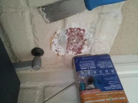

Hi guys I'm returning to the Oracle of Mud for options and ideas about paint stripping on a brick fireplace. Was reading that I should use a product that requires an adhesive backed product that allows paint to come off in sheets. Any better options or products to suggest? I would like to avoid a traditional gel-based product unless I have to

Hi guys,
I tried the stripper and brush method and it does not work well. My plan was to rent a sand blaster' but that fell through. More on that tomorrow with some pics.

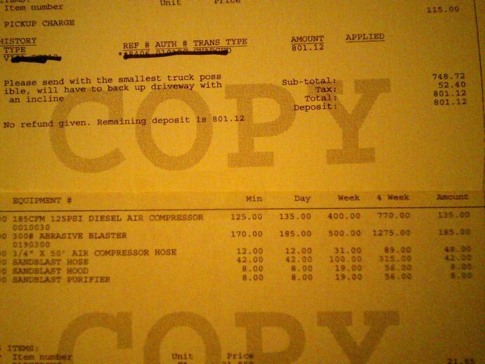

Just an update. I scheduled my compressor rental for last Friday and about chocked on the rental fee, see below.

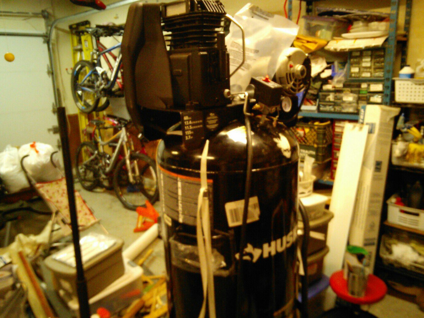

So about 2 days later, I wake up and think, I could buy a used compressor on Craig's list for less and get a cheap sand blaster from harbor freight.
So off to Google and searched.
I found one at home depot that was returned, I needed 60 gallon min to get the job done, and for $340 out the door, it was a done deal. If I find one on Craig's list for less, I may return it.

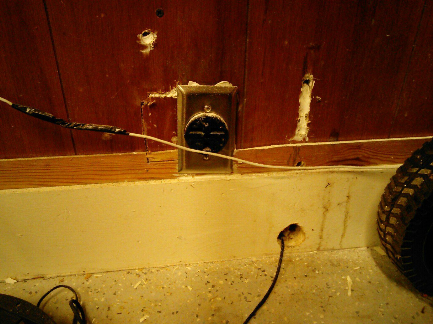

So in order to do this, I had to run 240 volt to the garage somehow under the 7 foot span of flooring between the basement will plate and the garage wall.
Out came the tools and I drove 1 inch holes through each and then spent 2 hours fishing a tape through. I ran a new line through the holes and tapped into the wiring in the basement.
I also ran paracord through the hole permanently so I can fish the rest of my wiring and pipe to the basement so I can have compressed air in my basement workshop. Its sounds crazy' but my garage is tool small to house my other tools for my man hobbies, but it is cheaper than adding onto the garage.

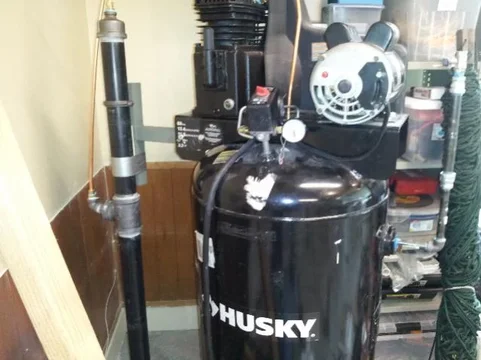

Hi guys
just an update. Getting compressor in place , built my franzinator on left and replumbed my lines
Looks like my first picture didn't take so here it is again then also here is my sand blaster. Sand kept getting stuck in it and then here are some parts that I sand blasted sandblasted.
