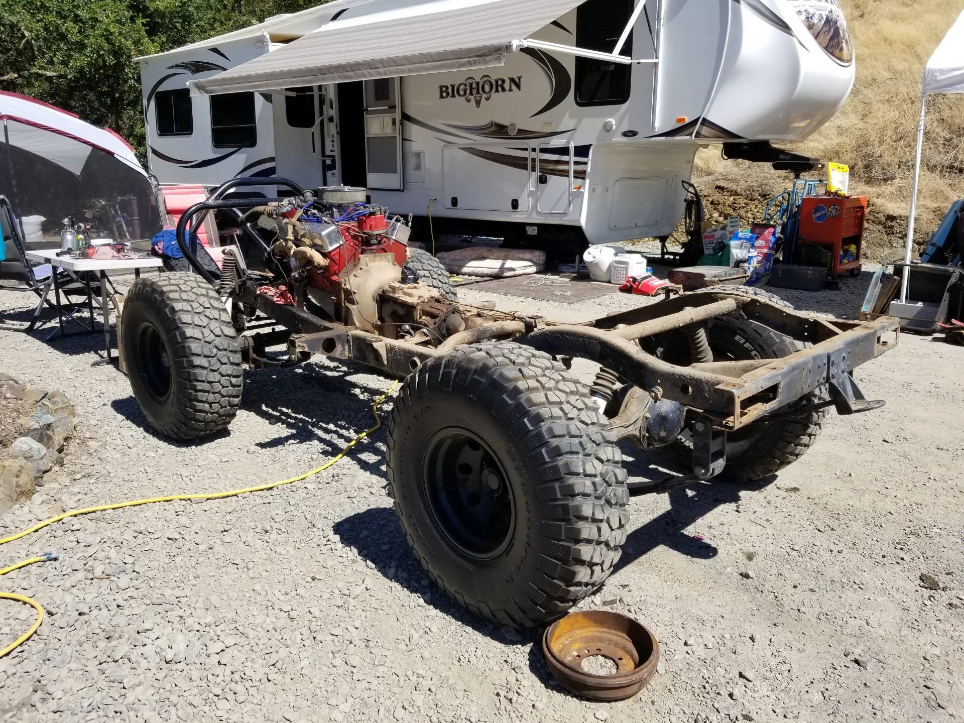

The PO stuffed the V8 so far back into the firewall that yes it would be like a 21" rear drive shaft adding the toybox.
I am moving the motor further forward to split the difference though and I'll have Tom Woods makes up some DC drive shafts since I'm in the middle of a frame off redo.
I put a new 357 Chevy (.042 over) full roller with a 268 cam, world product heads, and a forge lower end in her about 7400 miles ago. Everything is holding up well the 4 speed tcase mated to the H42 is still in good shape. Although I don't go looking for trouble by dropping the clutch with over 400ft/lbs either!
