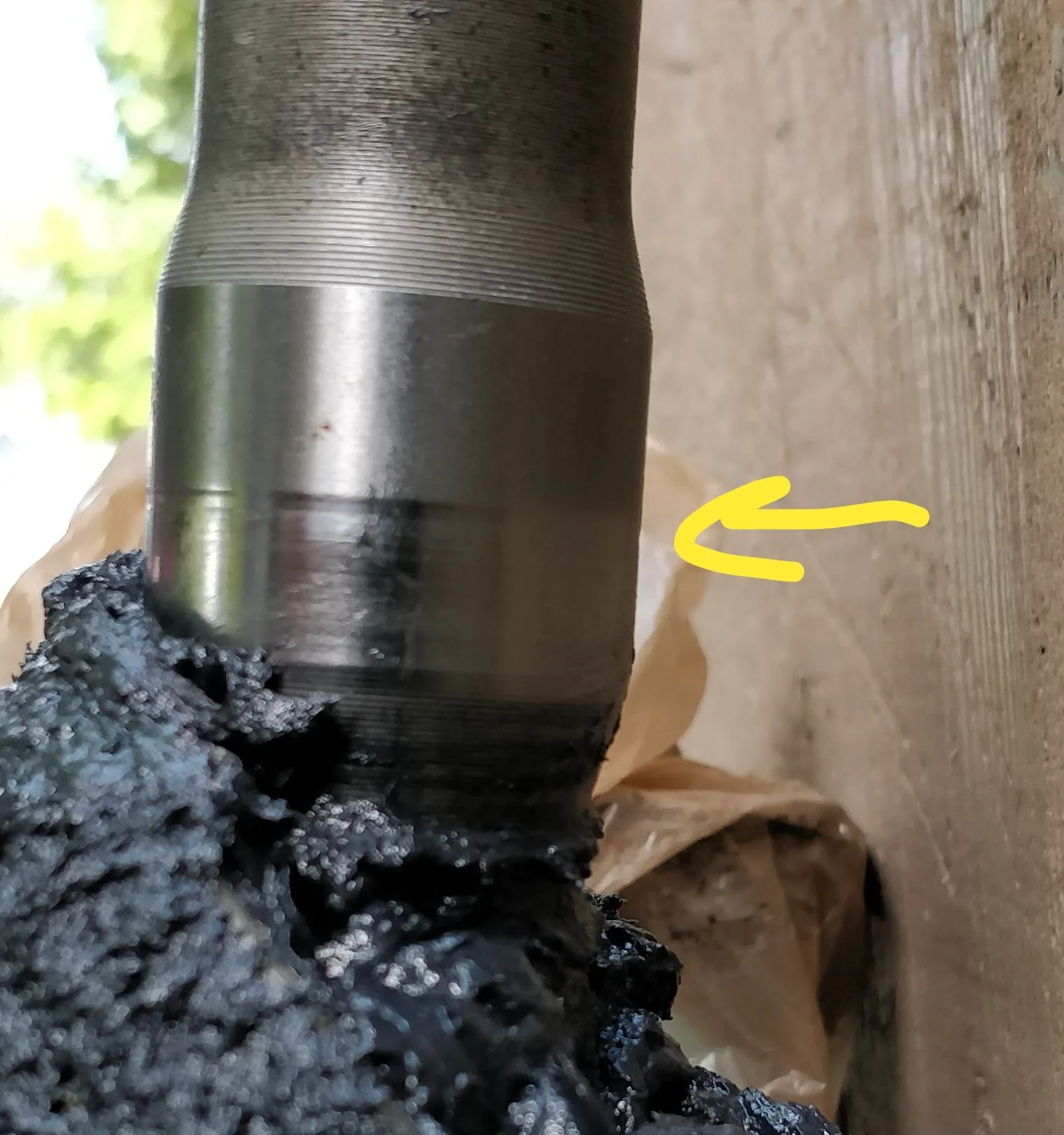

My drivers side axle looks fine, the passenger side axle had a small/smooth groove in it. I am quite certain the MC seal caused this groove as they are also known for that.
At the time I did not think the groove was deep enough to cause a problem with my new OEM seals, I put it back in, using OEM axle seals. I have it packed with grease and the spindle installed.
I am now 2nd guessing the groove in the pass side axle.... I don't have a pic of it which sucks..
But my question, and really the only question, is can anyone confirm 100% that the Marlin Crawler seal sits on a different spot on the axle than an OEM Toyo seal?
Looking at them, although the MC lip means it doesn't drive in as far, it is a deeper seal so its contact point is further toward the diff which to me looks like it would be VERY close to the OEM seals contact point.
My OEM seals are driven in as deep as they will go (little past the lip of the knuckle).

Many of us overdrive or underdrive new OEM seals to place them on fresh areas of the axle that are grooved from 20+ years of the original OEM seals in the OEM location. I have heard complaints that the Marlin seals fail much sooner than OEM but I have never heard that they are more likely than OEM to cause damage to the sealing surface of the axle!o

It’s why these are doing so well. Just install the OEM seal over a new spot on the axle shaft journal.

I am realizing I have to pull the shaft again and at least look at the groove...

So I bought a new Toyota seal, pulled my axle and ripped out the new seal I had just installed.
As you can see from the pic, although the groove isn't as bad as I remembered it being, it is there...
I under drove the new seal. I figure the groove was either caused by factory installed seal which I assume would have been fully driven in, or the marlin crawler seal which sits further in.
As Crocodile Dundee would say 'Aht's nawt a gruuve'. :flipoff2:
Better safe than sorry though.
