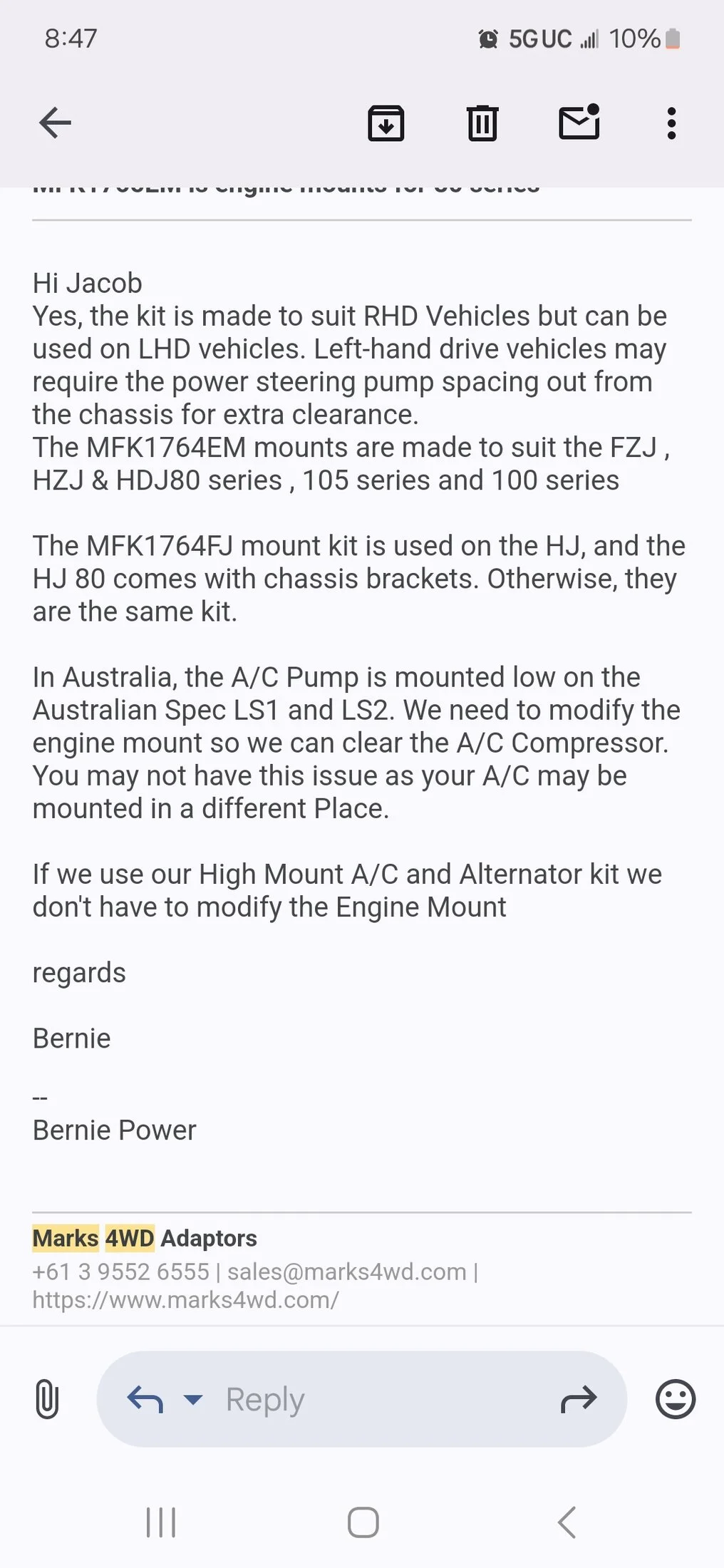

I see this is alittle older. But I reach out to marks about using those engine mounts on my 5.3 lm4 swap and they emailed me saying they will work just might have issues with power steering pump clearance. Did you end up using the mounts and making them work. I'm more attracted to the Idea of not modify my frame mount if I just have to modify other aspects.
I see this is alittle older. But I reach out to marks about using those engine mounts on my 5.3 lm4 swap and they emailed me saying they will work just might have issues with power steering pump clearance. Did you end up using the mounts and making them work. I'm more attracted to the Idea of not modify my frame mount if I just have to modify other aspects. View attachment 3849091
Check out this build thread. It has some good photos of the clearance issues and how he solved them.
