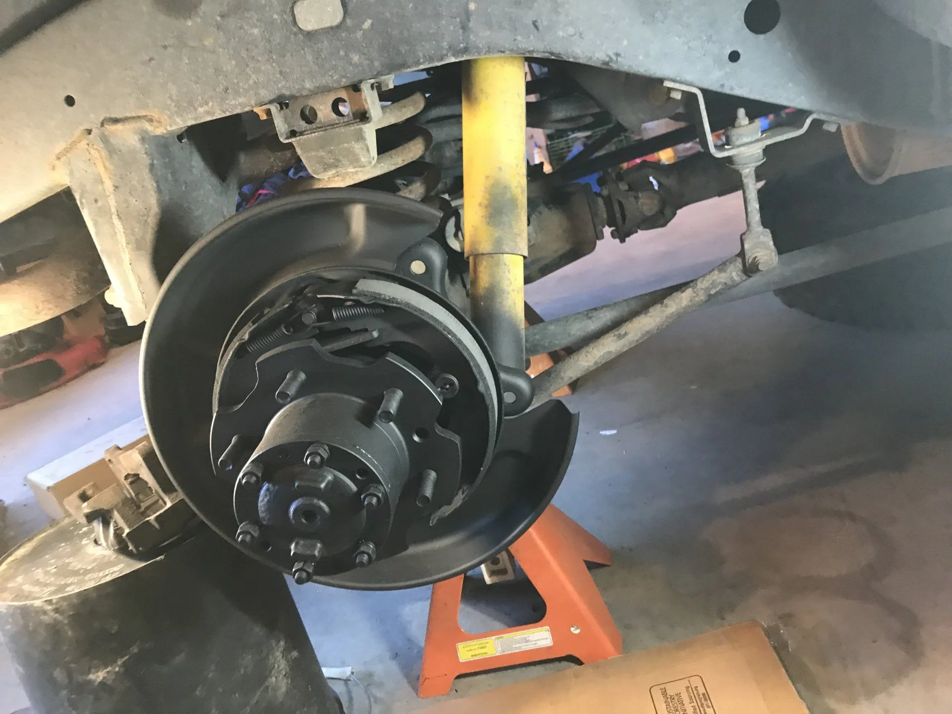

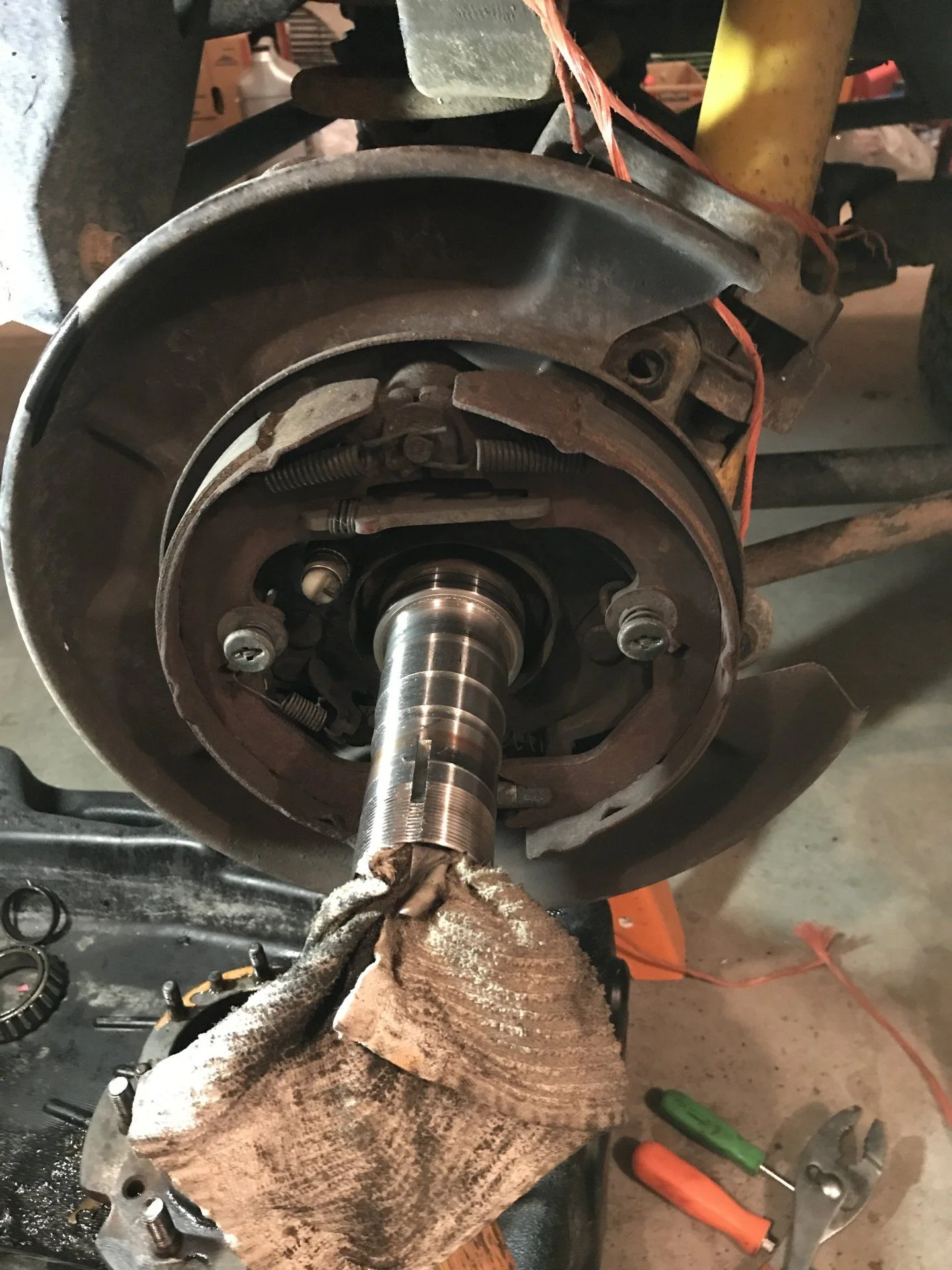

The rear axle was leaking really bad out of the driver’s side, so I started there.
(Well, I tackled the non leaky passenger side first.) My first time in the rear hubs.

On your rear axle, curious to know if there was any sign of grease left in the bearings or was it running in gear oil.
There was still some left on the leaky side and other side was fine on grease. Replaced everything anyway.

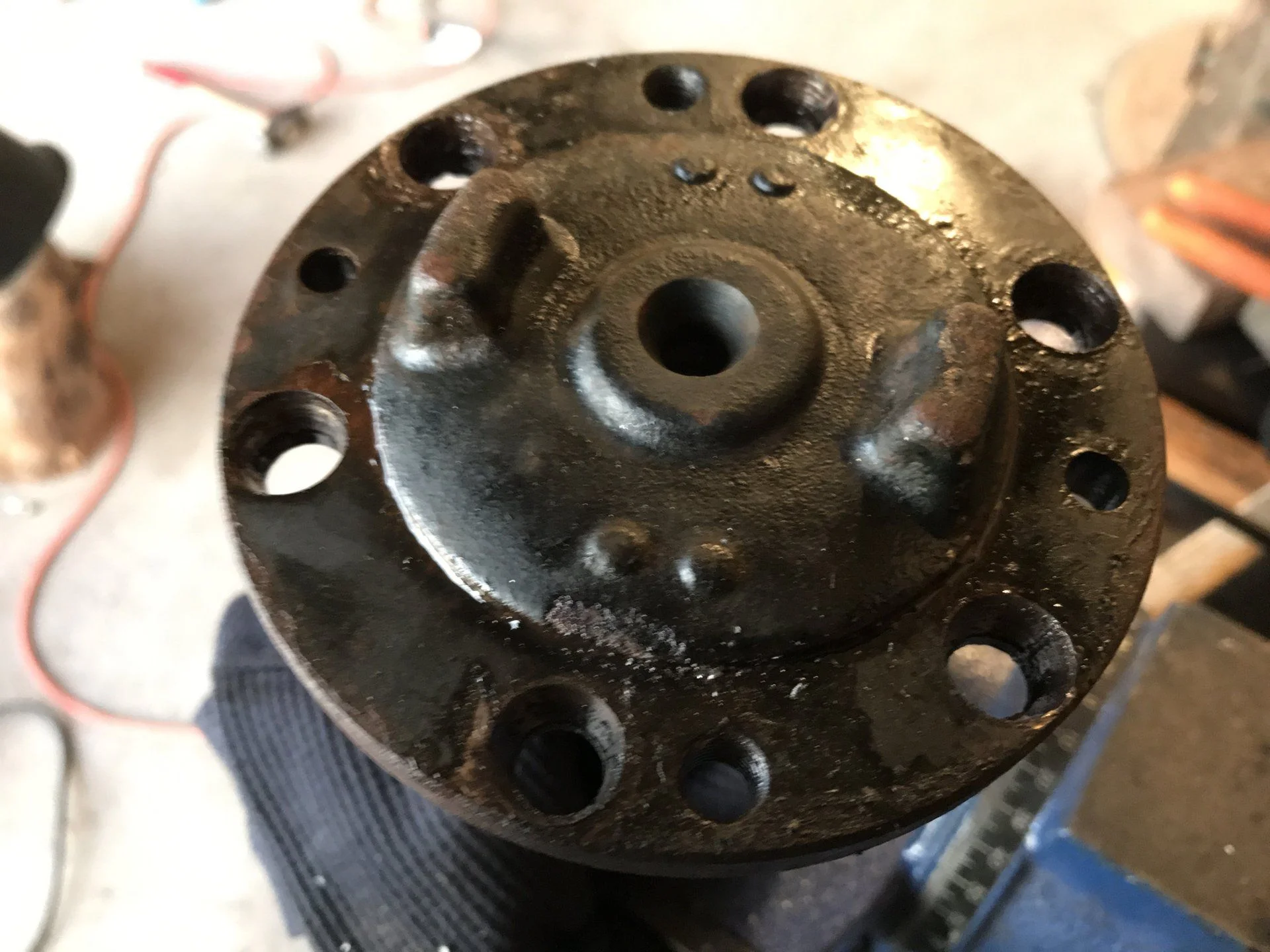

BTW, I had to REALLY, REALLY pound on the hub studs to get the cone washers to let go.

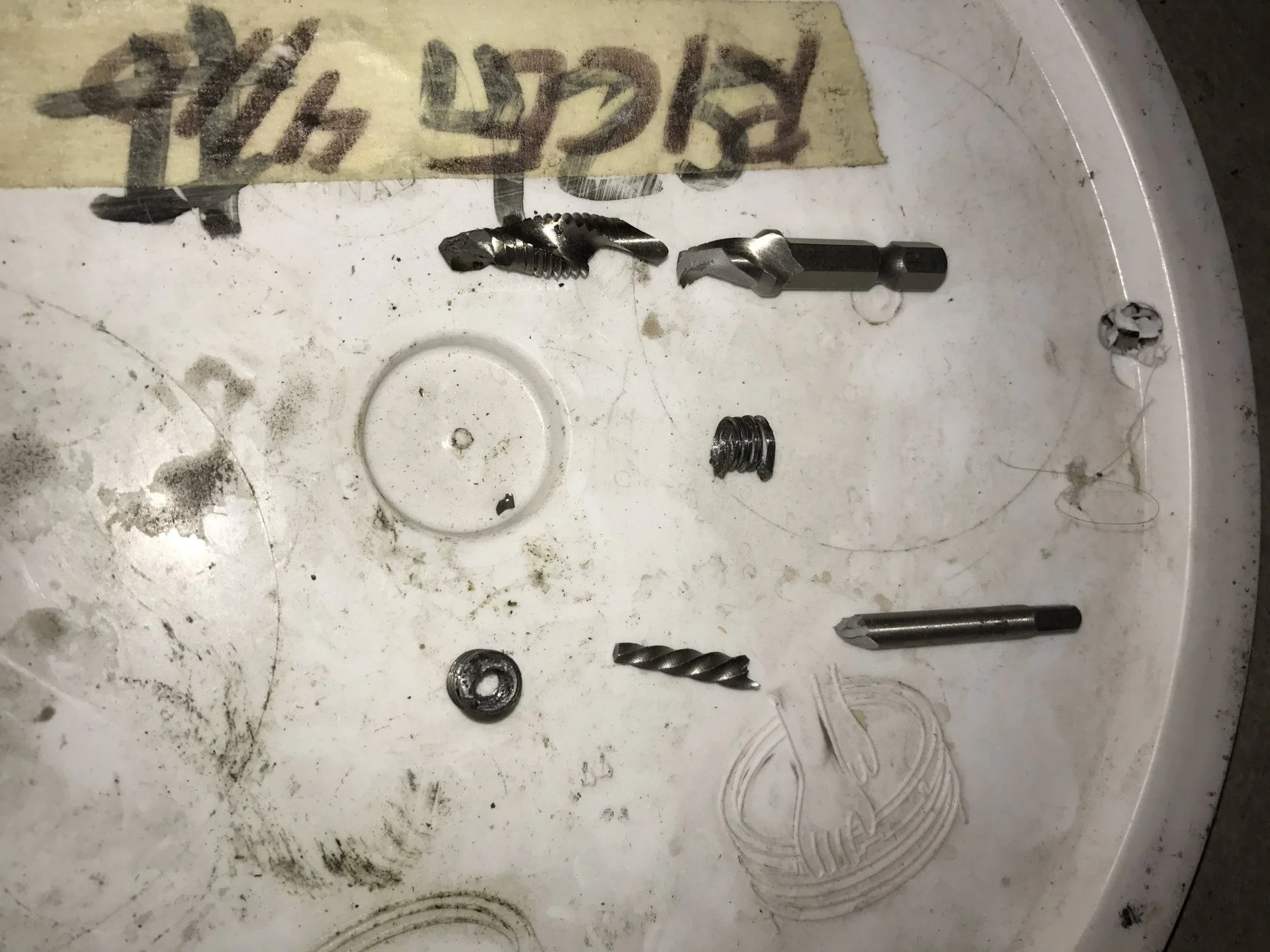

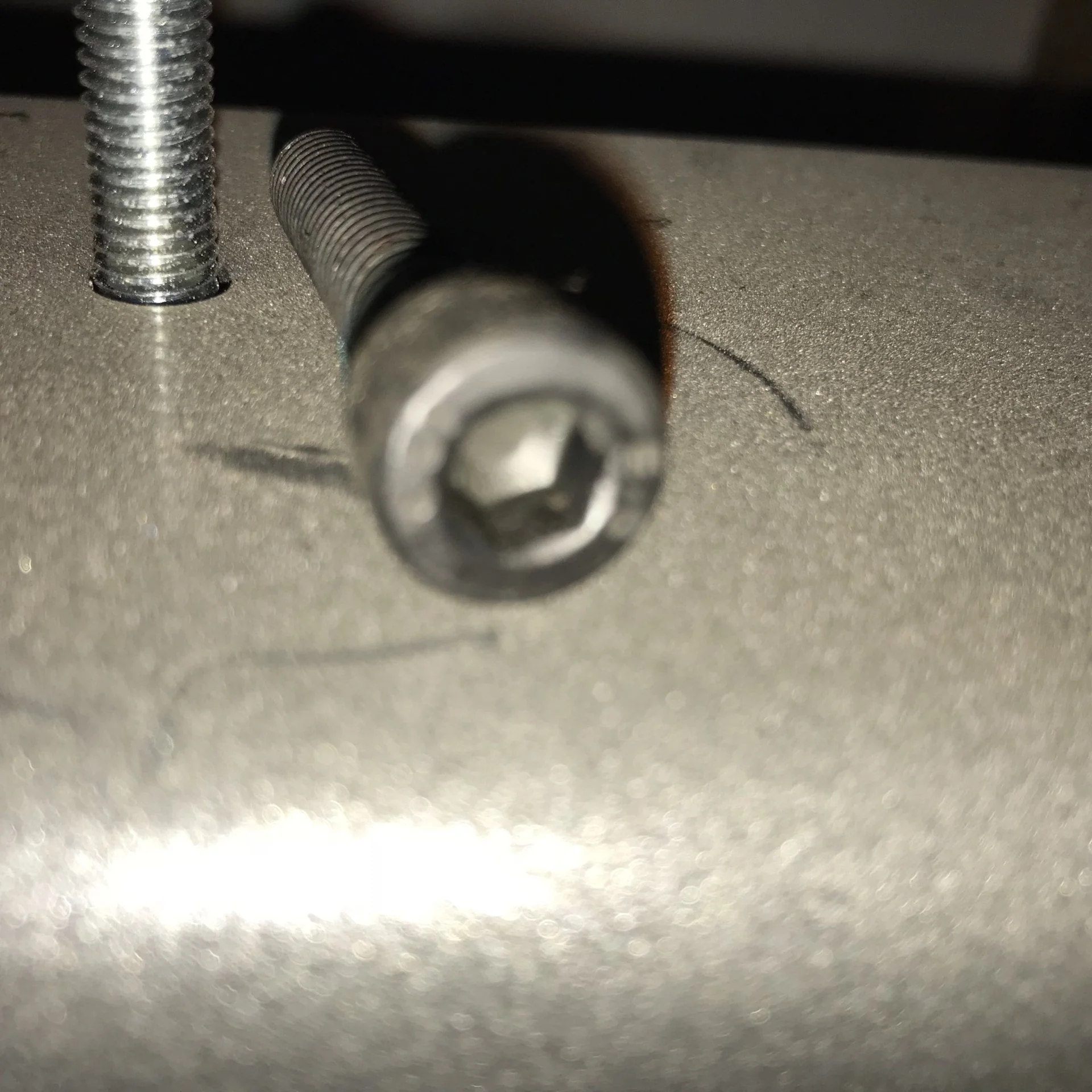

Another gotcha, the two theaded holes in the rear axle shafts. I made the mistake of using the first bolts I could find laying around in them. A couple of rusty trim bolts (probably from the mud flaps or something). They promptly sheared of.
I had the fun of break various tools trying to extract them.
It was too late, but I went out and bought the highest rated cap screws I could find, 12.9s, to have on hand for next time.

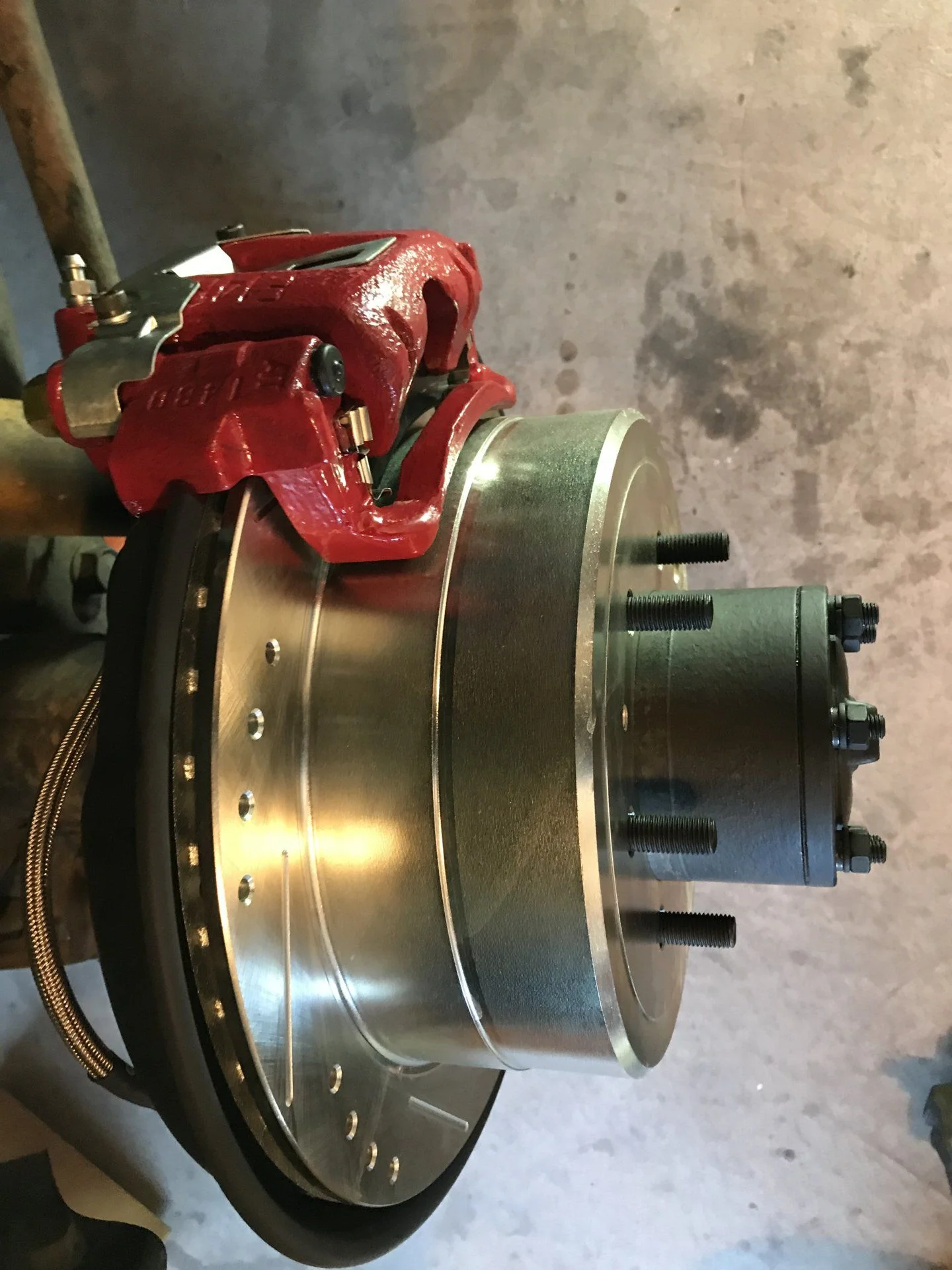

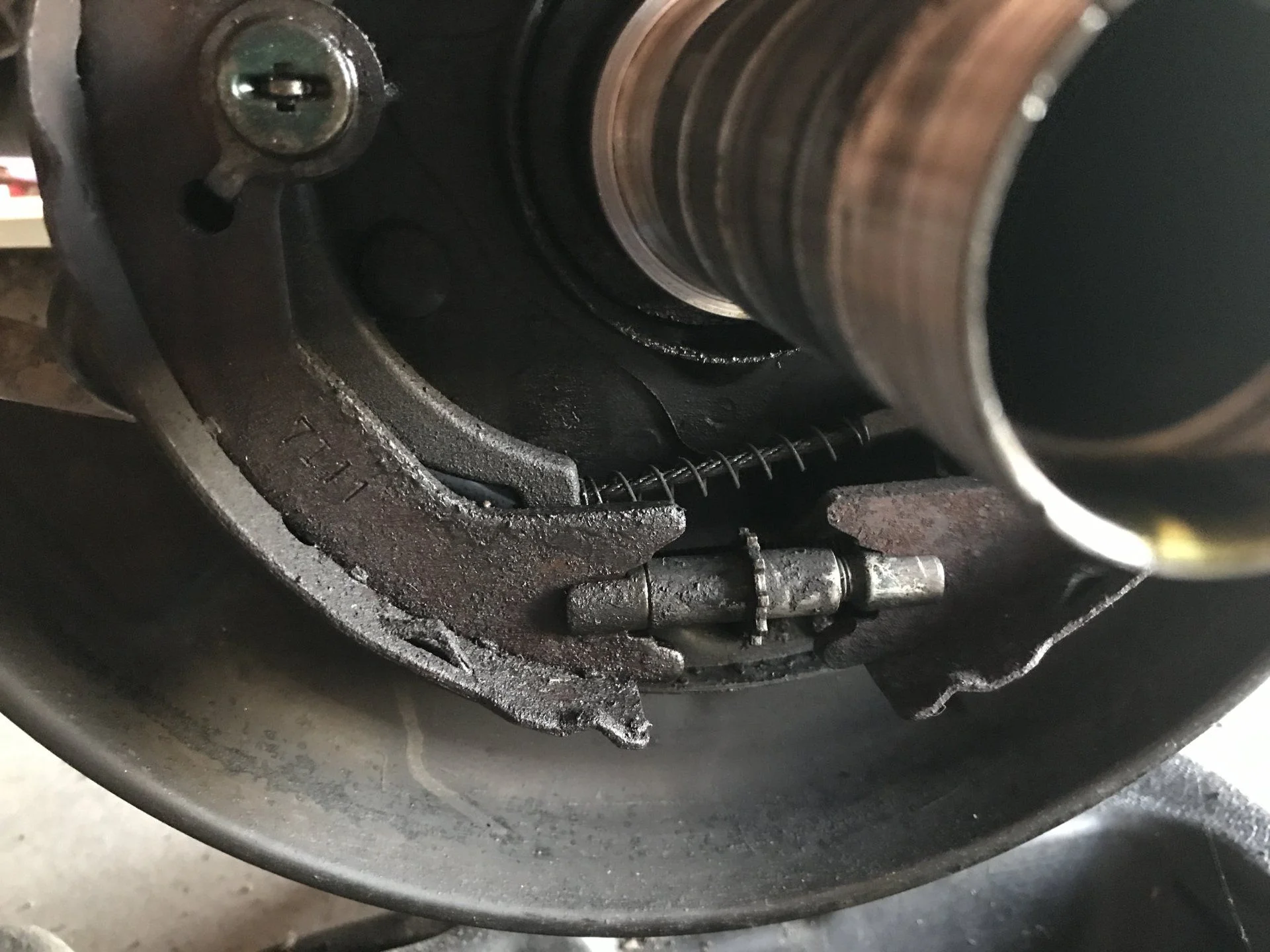

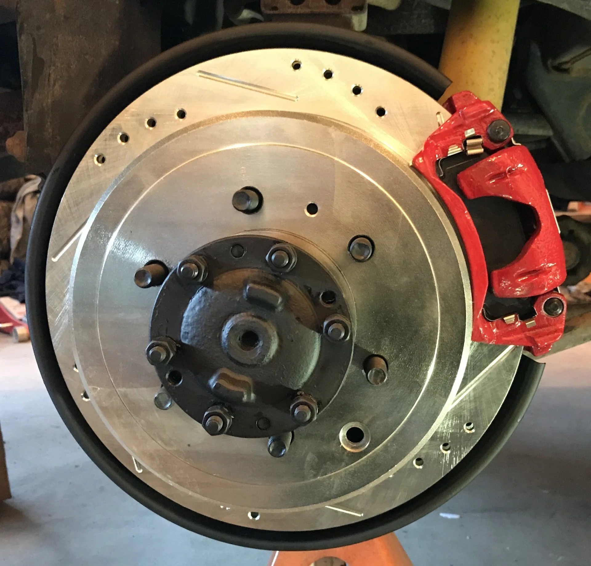

As I mentioned, I did the non leaky side first. I checked the parking brake shoes against the spec, full thickness (4mm) except at the edge, which was 3.5 mm and well above the minimum (1mm I think).
I did get new rotors and pads, but kept the original shoes. Well, I get the leaky side apart and EVERYTHING is soaked in gear oil, to include the parking brake shoes.
So I ended up replacing the shoes on both sides. This when I also discovered I had put the first seal in backwards. I switched that while was there. I started this whole project because of seal leak, didn’t want it to come back soon.

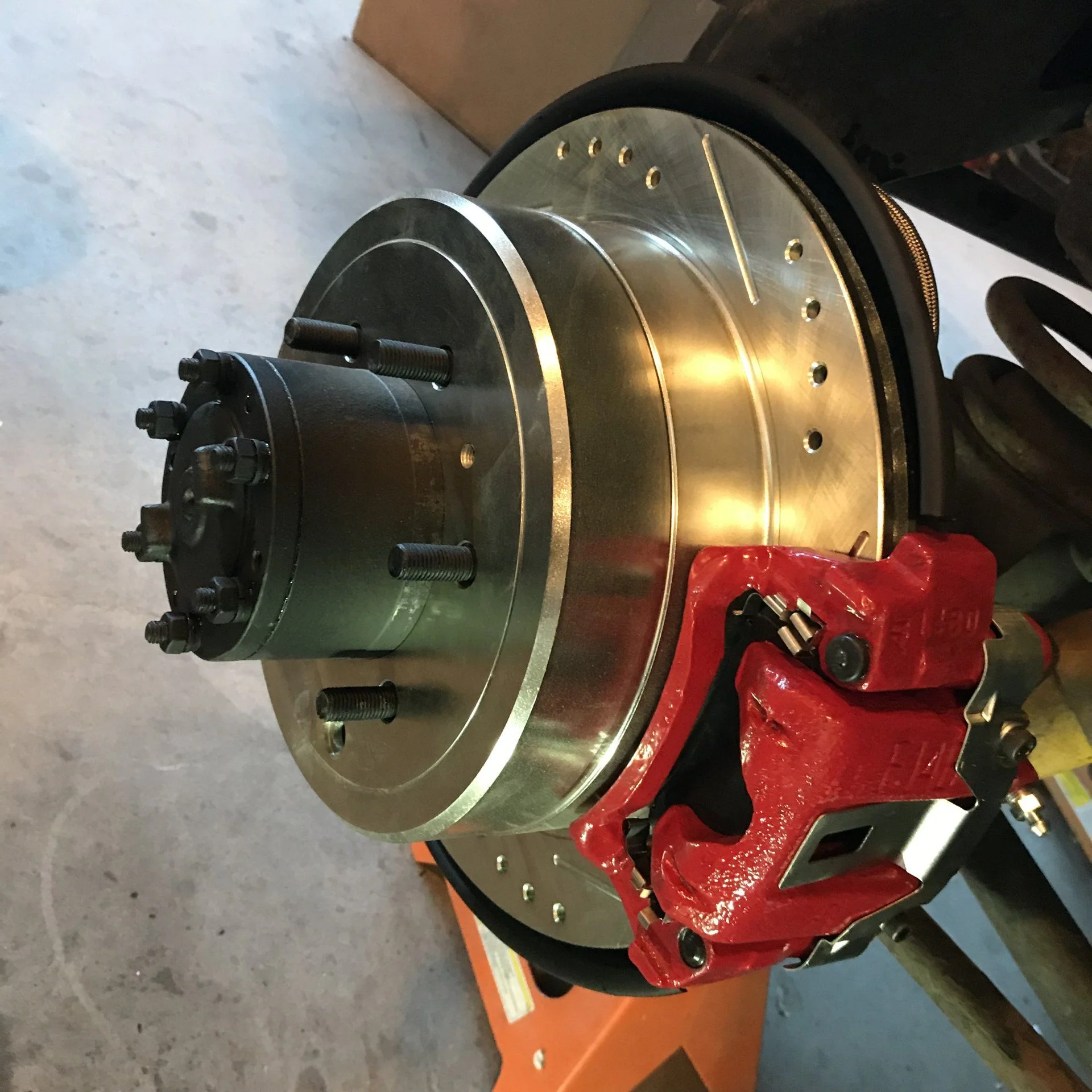

I got pads and rotors from the EBay store Brakemotive76. They don’t specify the manufacturer, but the pads come in Centric’s Stoptech Powerstop packaging. I’ve used them before and they have done fine. They didn’t warp or crack, I didn’t track the miles. But it was several years for me.
I know some people wouldn’t run drilled rotors off road, but out in the mostly dry West, I haven’t had any issues.
Well, as I was pushing the caliper piston in to put the pads in it started leaking. So I got a rebuilt set of calipers from AutoZone. Cleaned the waxy/oily junk off them and painted them red.
I hindsight, I made two major mistakes:
I would have used Napa’s calipers which were already painted. And if I still felt the need to paint them, I would have used spray paint instead of the brush on paint that ended up taking a lot more time than I expected.
Like I said, I almost called this “the Rattle Can Restoration”. If I have to touch something, I try to clean it up the best I can and paint it, chase the threads with a tap. I want it to look closer to new than when I started and IH8RUST!
It’s a chance to wallow in OCD after 17 years of mostly neglect.
Rear Axle / Rear Hub Summery:
- If your rear hasn’t been apart in 20 years, plan on pounding on the hub studs HARD! They won’t all be straight when you are done. I replaced all the hardware including the cones.
- If you use the 2 threaded holes on the axle flange, use good, high grade bolts or cap screws.
- The seal lip faces OUT on full floater axle with disc brakes.
- If your rotor is covered with gear oil, it’s a safe bet the pads and parking brake shoes are junk.
- Napa rotors are painted and best box store budget solution. @beno recommended them to me for the front. (Wish I knew when I did the rear)
- The above point makes this one unnecessary, but use spray on caliper paint, not brush on.

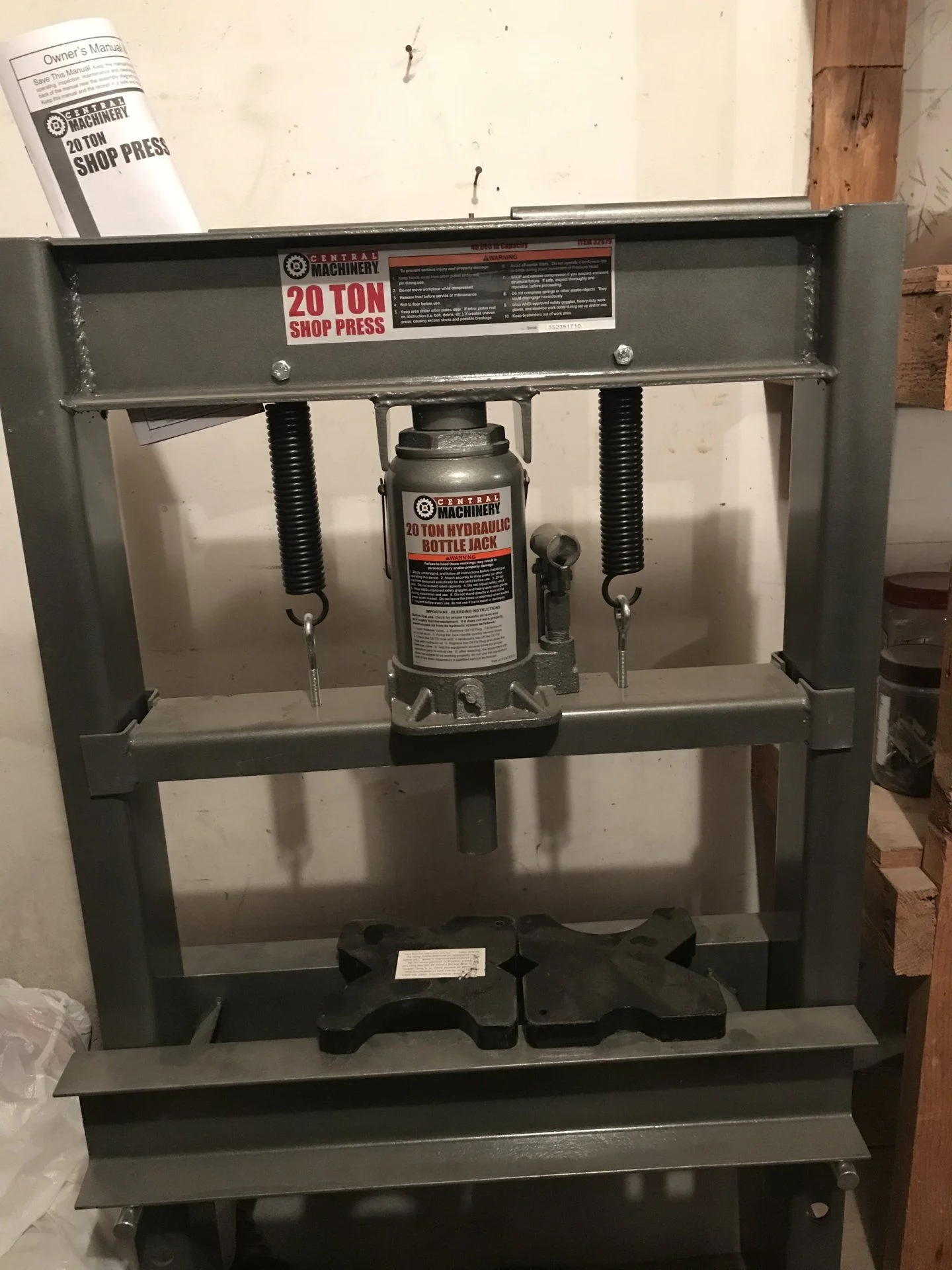

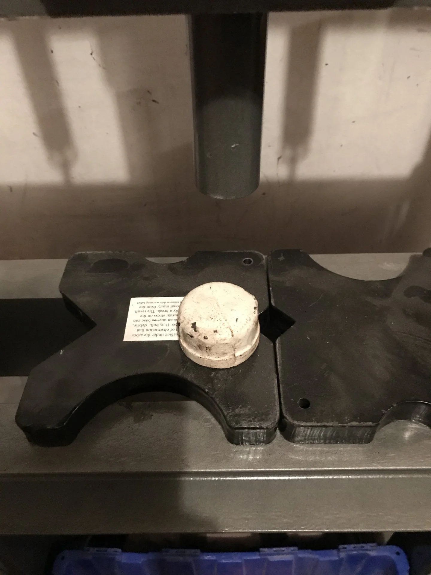

- The cut old bearing race, and a Harbor Fright press work great! I also found that a pipe cap was the right size to help.
Total tangent, but seeing your shiney press jaws made me realize I bent mine last month.
Were those HF too? Thickness?
1” thick. They came with the 20 ton press.

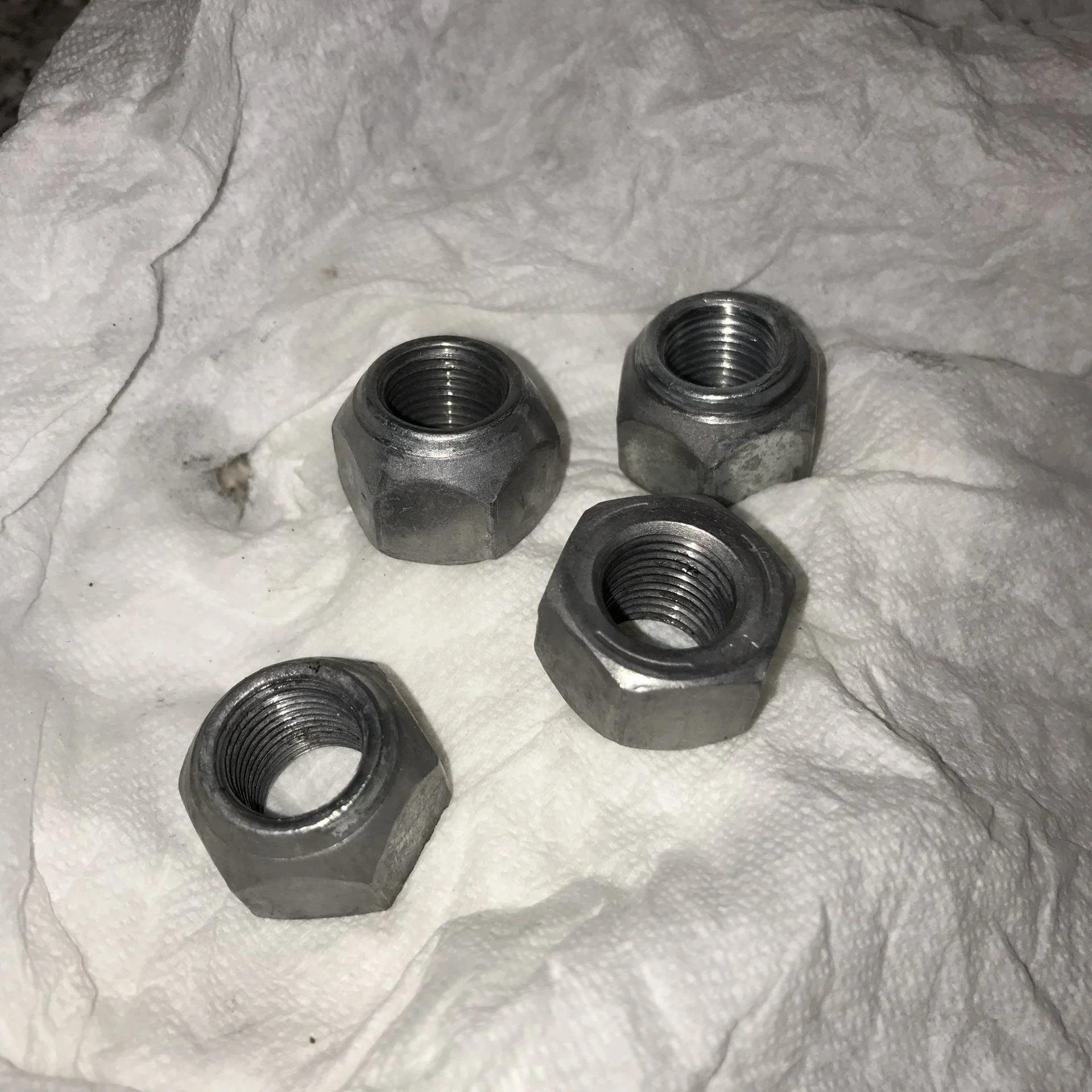

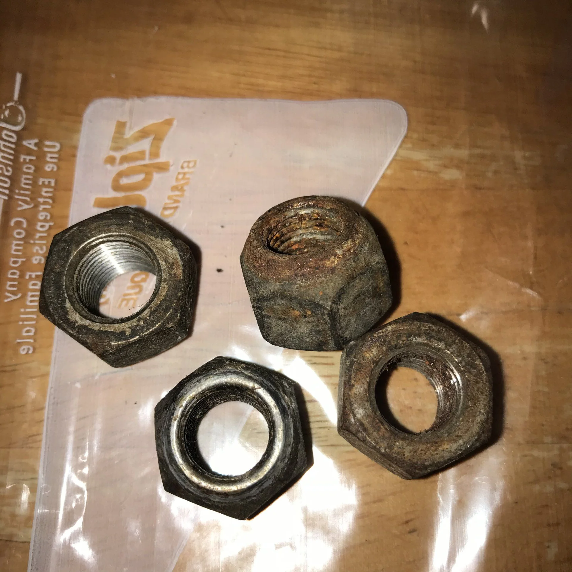

After I got done with the rear axle, I tried a rust remover I saw at Harbor Freight called Evaporust. First I tested it on some rusty lug nuts I had laying around. I was pleasantly surprised. The before and after pictures is just from soaking.
It’s pH neutral and safe for other metals. The downside is that it has to be at room temperature and only works on stuff that can soak.
It’s great for cleaning up hardware and tools that your kids left outside for extended periods of time...
I ended buying 5 gallons from “the RustStore” online. After I finally get stuff degreased, I have be soaking all my front hub and knuckle components in it.
