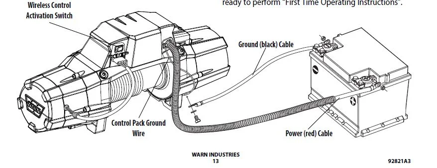

There is on/off wireless switch on the back of the winch which cycling it on and off may have worked instead of removing the battery cable, to reset the wireless.
In my situation it was easier to remove the battery cable as the winch is buried in the arb bumper and skid plates.
Sorry, my comment was about the VR winch from Tekis300. There isn't a power switch on the winch or solenoid pack on the VR series. The only power switch is on the handheld control unit. To use wireless, you leave the cable out, and press and hold the power button until the blue light comes on. It is super low tech, I'm guessing radio signals, not bluetooth or anything fancy.

So I have the War Platinum winch and yep, it is only wireless and yep I wish it had a hard wire capability just for extra reliability. That said, it has yet to let me down. I have only used it 4 times in the year I've owned it in recovery situations but have also used it just playing with it and spooling it out and back in after I've used it. Here are my thoughts on it:
1. I relo'd the control unit to under my hood and I keep it off until I need it or at the trail head when I think there's a good chance I'll need it. Doing this means it re-pairs with the handheld and if it doesn't you would know at the trail head. This is a good practice. @Fisher23, it seems you have an access challenge getting to the power switch so that is why you had to disconnect the battery cable? If you leave the control unit on all the time that may be why it eventually got confused and needed to be restarted.
I went through this as well. I found that by opening the hood and removing the plastic panel by the hood latch (four button clips if I recall), you can reach said button very easily. Took me all of a minute.
