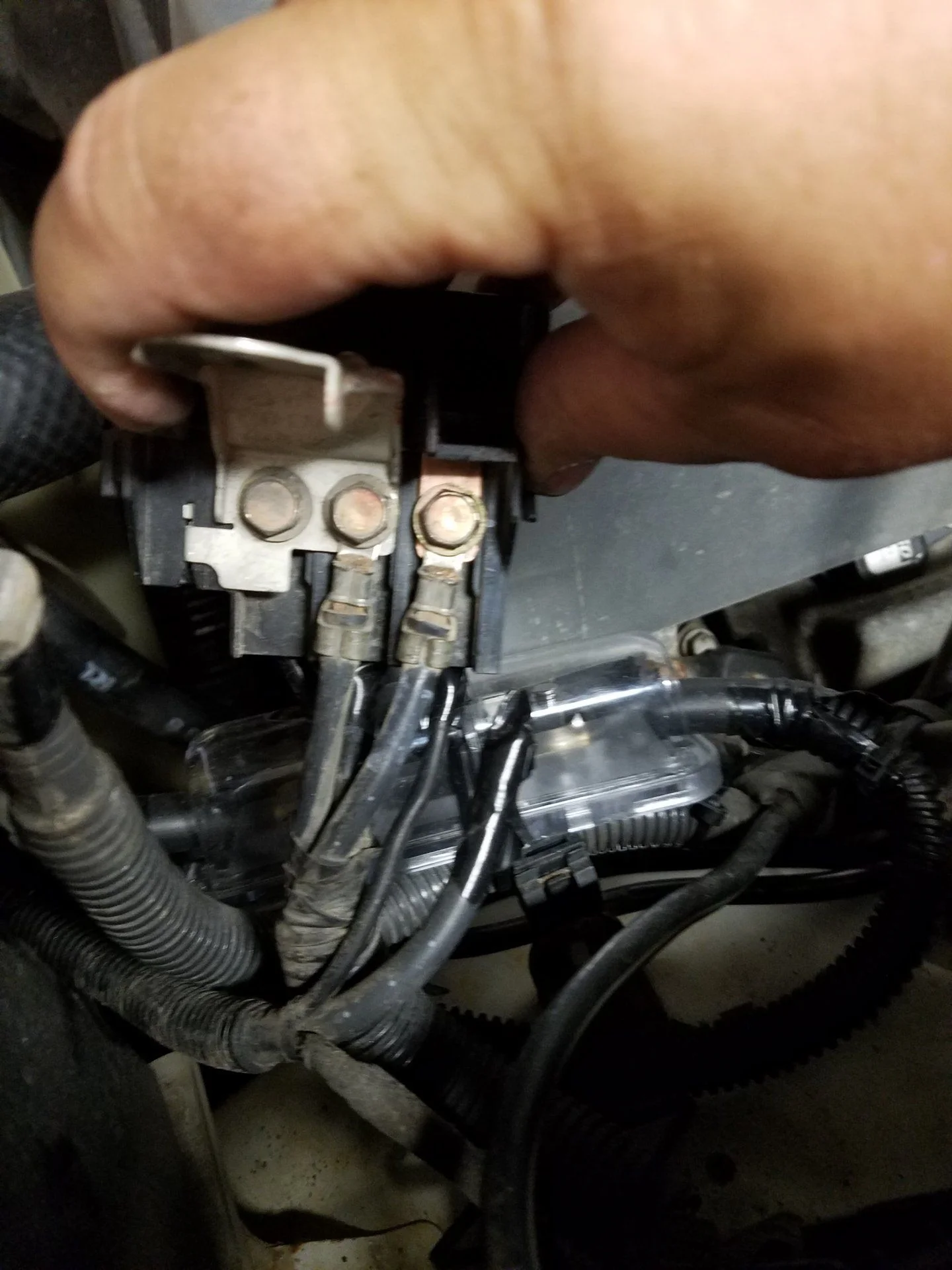

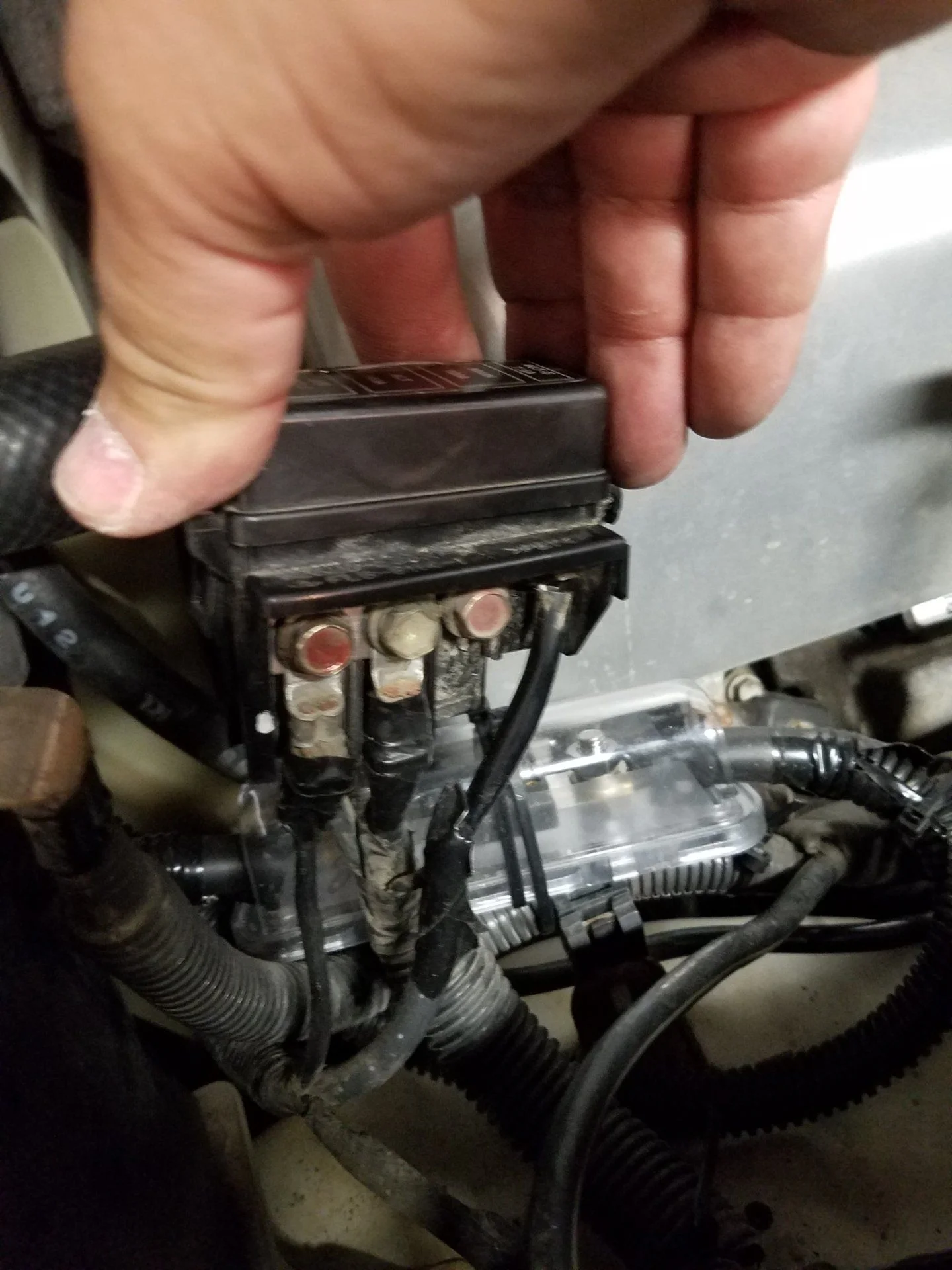

@jrmudder92 do you have a picture of the terminal block on the positive side of the battery. Both battery side and engine side. I think I misplaced a wire.
Hope this help!

Note there is no alternator wire as it was replaced, rerouted and much bigger. it would be on the engine side of the terminal block.

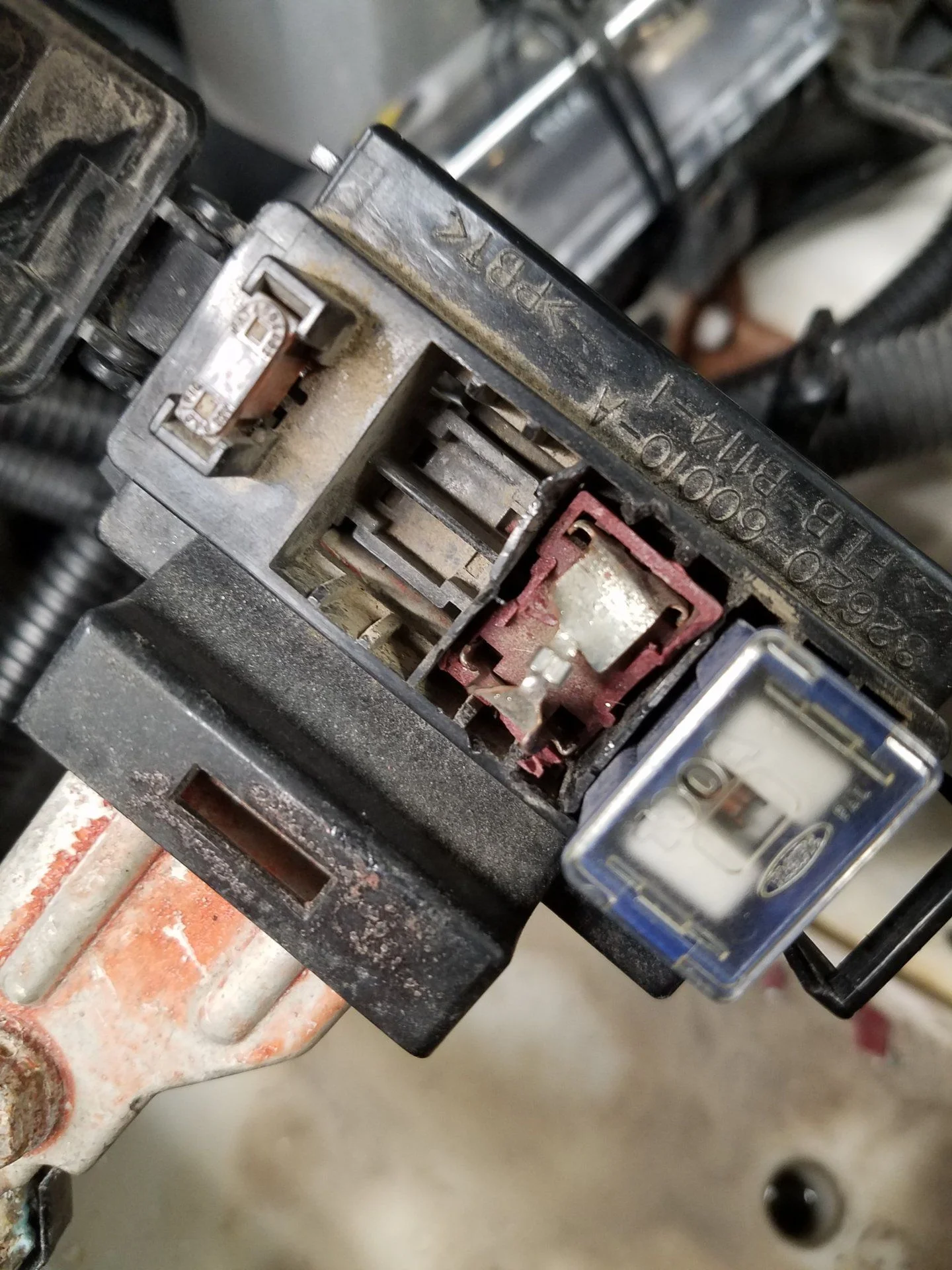

This is what I found when I was cleaning (stereo shop did this, they didn't think they were bolted in place so the pliers did the trick!
This was after cleaning and your very helpful pictures!
Well damn I was really hoping that would solve or help it. Hmm... back to the drawing board!
